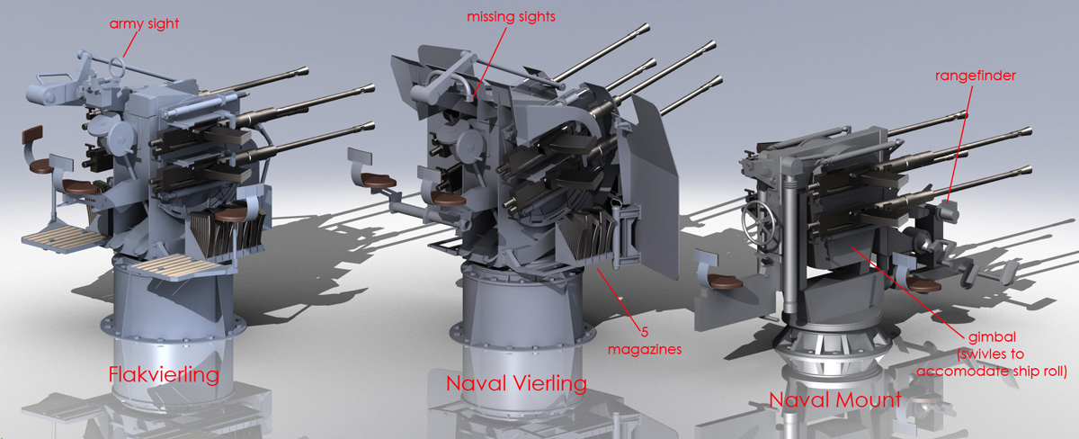

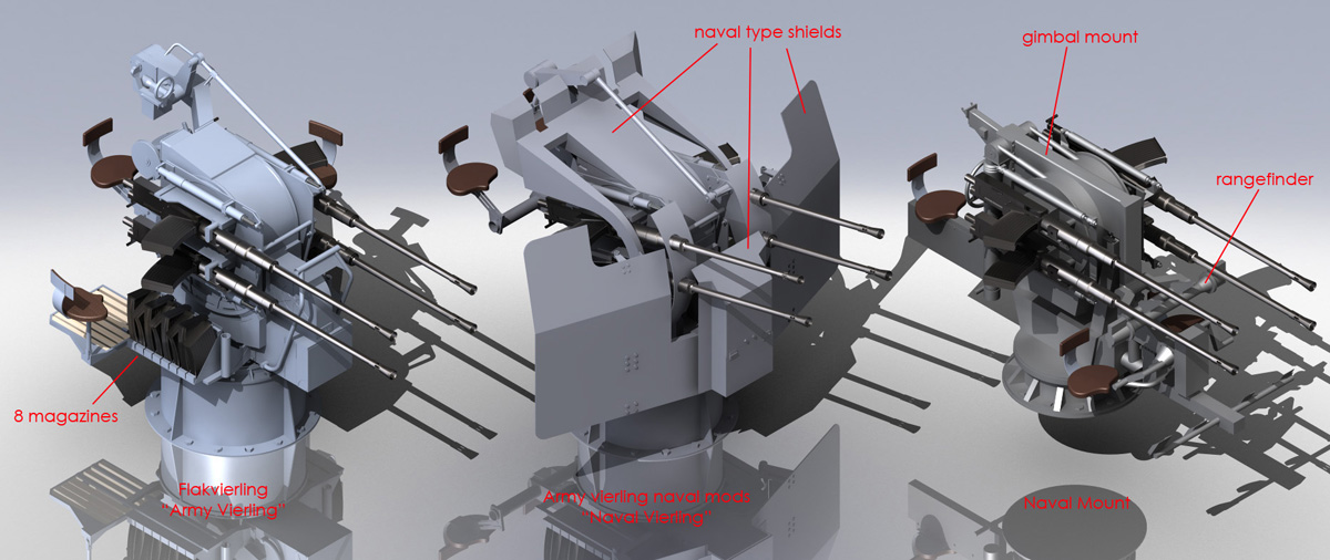

To help you understand the differences I made this quick little tutorial. Here are the three variants.
1. The regular army flakvierling. The only modification the navy made to it was to add a taller circular base.
2. The naval vierling. This was an army vierling that was modified to reduce the workload on the gun trainers. The change in seating arrangement also necessitated the removal of the last three magazine slots to make room for the gunners feet.
3. The naval mount was completely different from the army variant, it had a rangefinder and a gimbal that swiveled to accommodate the roll of the ship.

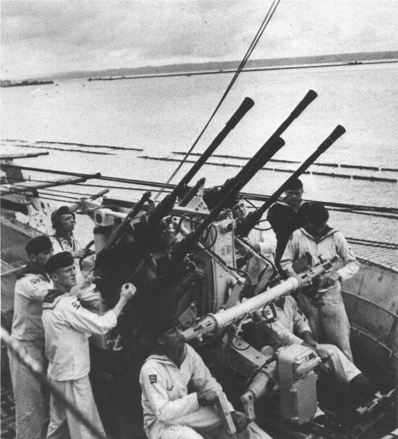

Here is the naval mount on the catapult pedestal. Note the guard rail around the platform and the crane cables in the background.

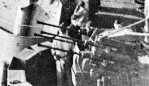

Here is the best picture I have of the one mounted on top of the 150mm turret. It can only be a flackvierling because the bar that folds down on the front was removed from the navy vierling to make way for a shield on the front.
A couple notes about my models. When I opened the naval vierling file the sights were missing, I must have moved them in my file structure and I don't have time to dig up where I moved them. Also, keep in mind that my models are not as detailed as I would like them to be. I would certainly like to have more time to detail them out, add wires and bits and bobbins, but that will have to wait until I am not doing this for a living.
