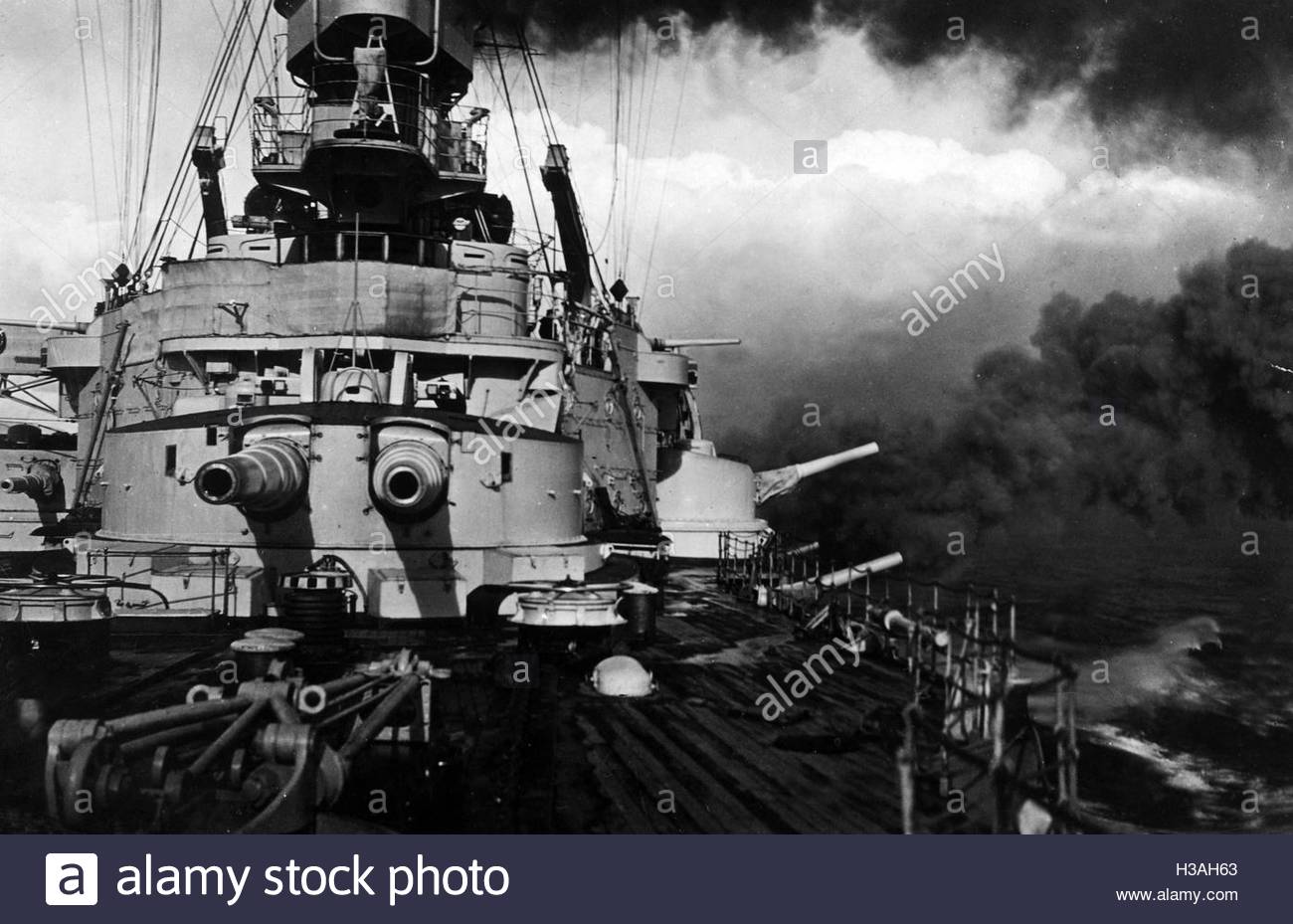

Image Note the folded down railings to allow the main guns full depression.
Higher quality pic here: https://i.imgur.com/Aa6PKVY.jpg

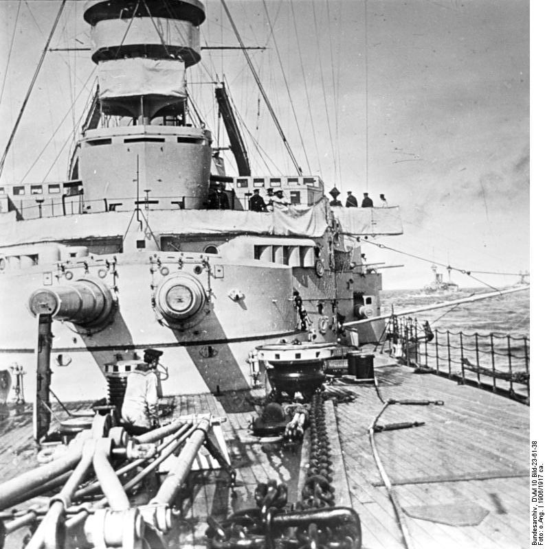

1935: Became part of the new Kriegsmarine. Eagle emblems added to stern. Below is a photo of Schleswig-Holstein with Scheer on the left. This was captioned as "...Kiel in the summer of 1935".
Note that the forward sponsons/"Swallows nests" and casematted Torpedo tubes are still on!
My initial conclusion: The Schleswig-Holstein still had the Forward Sponsons, Casemate Torpedo tubes, and the 2 forward Upper-deck 15cm Casemate guns throughout 1935.

I am building the SMS Deutschland model on a scale of 1/100. I ask for help on the anchor crane of the ship. I have more than two dozen photos of the crane, from different angles, but unfortunately they do not give a complete picture. Are there any drawings of this mechanism? The same cranes were on SMS type Braunschweig. Still interested in the drawings of floodlights of these ships. I would be very grateful for your help.
the-battleship-schleswig-holstein-during-a-maneuver-H3AH63.jpg [ 142.68 KiB | Viewed 2025 times ]
Bundesarchiv_DVM_10_Bild-23-61-38,_-SMS_Deutschland-,_vorderer_Geschützturm.jpg [ 104.96 KiB | Viewed 2019 times ]
