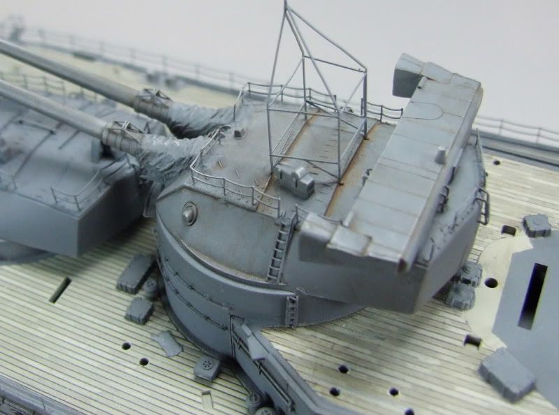

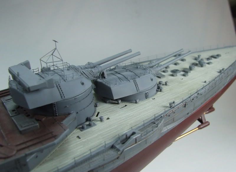

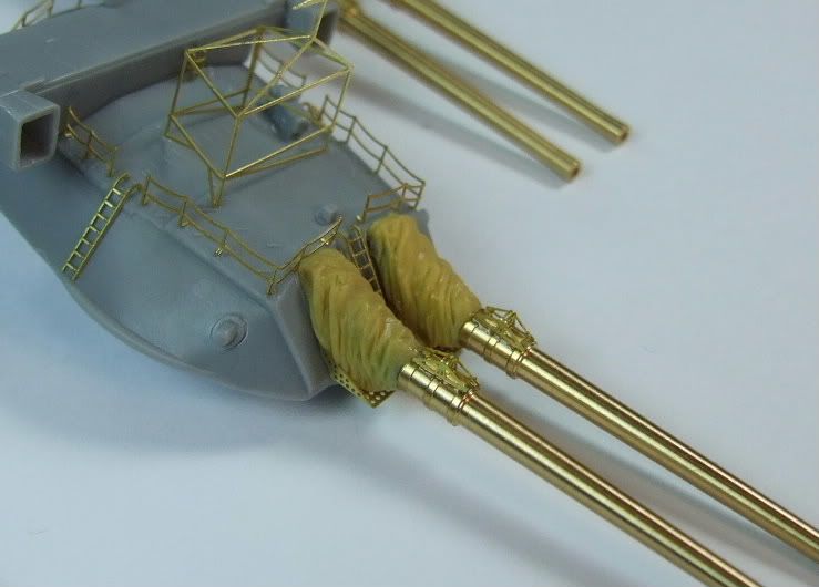

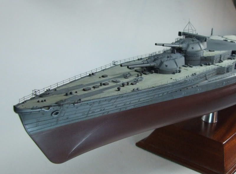

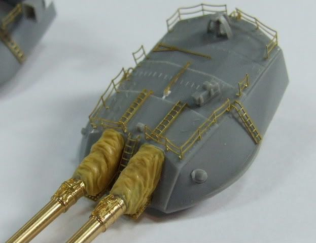

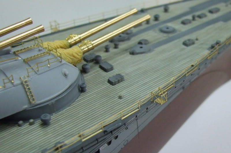

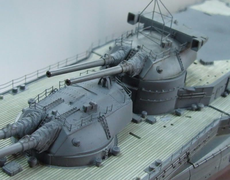

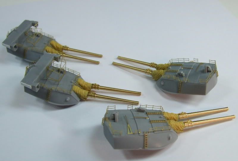

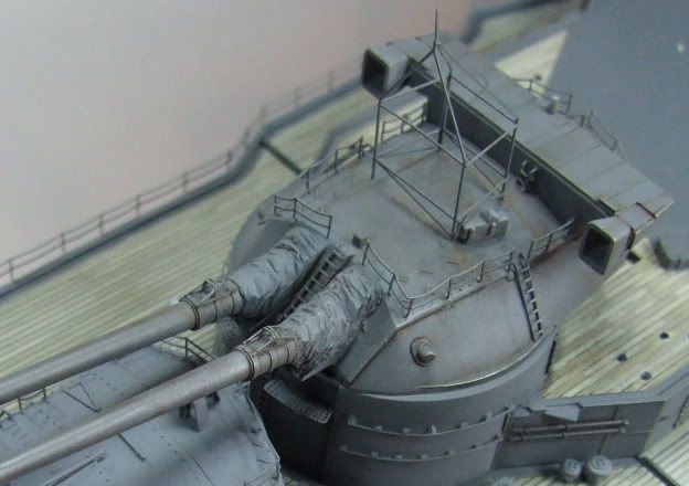

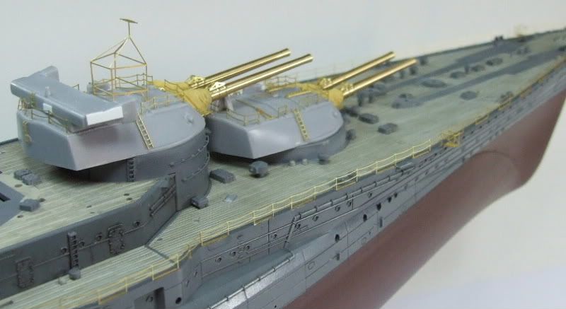

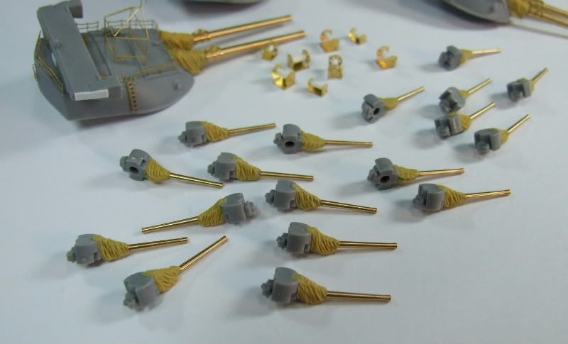

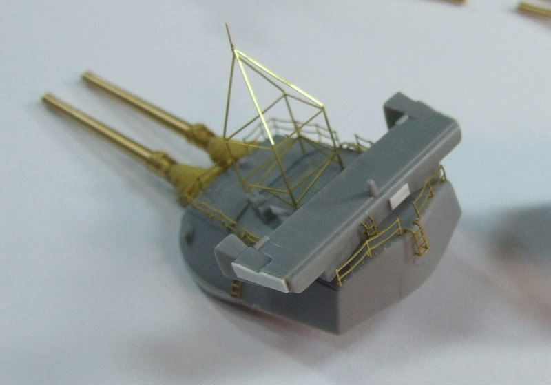

Hello,
long time no see.
I am back to this kit.
I would also like to recommend Hasegawa pe - it is stunning, especially rails. Every rail has its specific place and fits in milimeter.
Only thing you should also buy are cable reels, i will use WEM IJN cable reels, and IJN ladders.
Canvas will be in another colour of chourse.
Tnx for watching

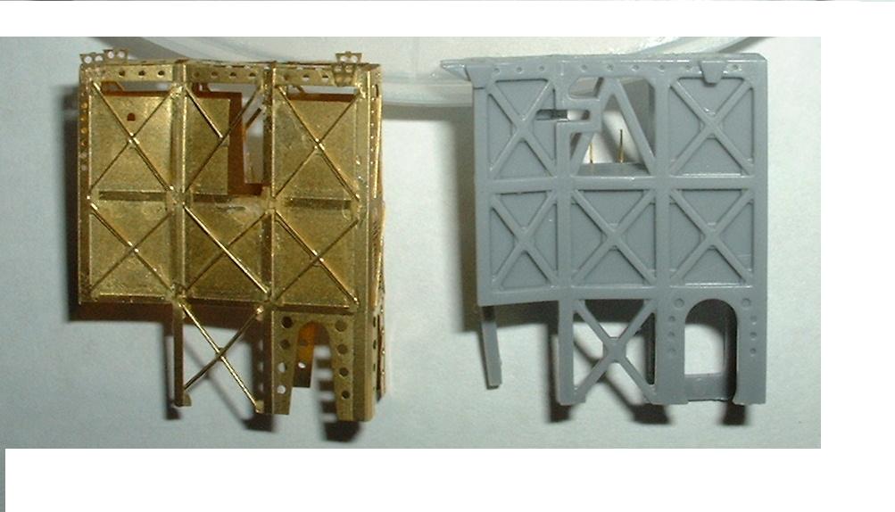

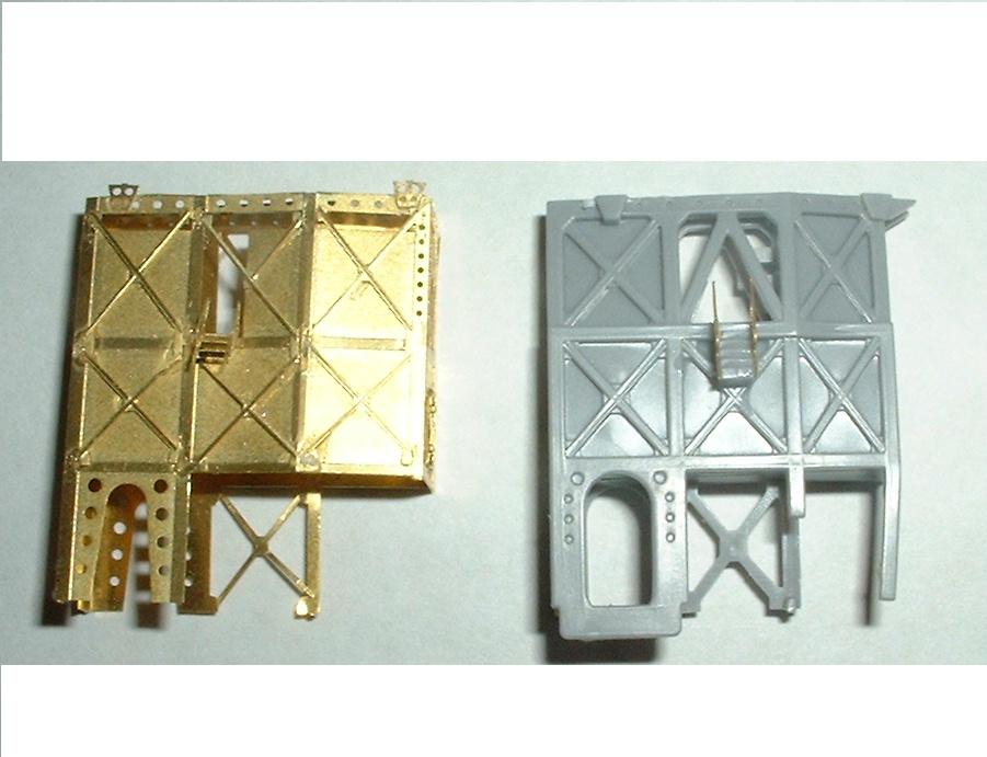

Marko,
Your photo etch work is incredible. I hope mine looks that good when I am finished. I am new to photo etch and I feel like my hands are a pair of meat cleavers. 1:350 is about my limit. I am including a few pics of Hasegawa parts S2 and S27 and the Lion Roar equivalent. Their product is really quite impressive. It's too bad that their manufacturing problem gets in the way. I noticed a glue spot when taking the pics. That will be removed before painting.
Ir3

Absolutely Stunning !! :thumbs_up_1: :thumbs_up_1: , Marko, may i ask how did you end up with such fine weathering? this just reminded me of a 1/200 scale Yamato out there somewhere, this japanese fellow took pictures of how to do it but the whole text was in japanese and... well i guess i'm too lazy to translate it on google :big_grin:

Thanks ir3 and J.Soca.
J.Soca, I've weathered it with mig production oil wash - dark and brown.
Important thing is that the base colour is not oil colour. In this case it is gunze acrylic. Once I've painted it gray, I went over it with brush deepend in oil thinnner and once it is still wet I made wash with those two washes and stripes with thin brush. After all that, dry bursh with metalic colour.
Cheers !
Marko

Would installing the PE antenna mast on top of the B turret and rigging the antenna prevent the turret from rotating?
I find the on-turret antenna masts on Japanese ships irksome in the extreme.

On the model, yes, on the ship, no. The antenna mast is designed to rotate around a shaft in its base so that the aerial always stays true, rigged fore and aft.
I could imagine possibly creating a working version in 1/350, but its impossible in 1/700. Not to scale, anyway.

PostPosted: Mon Dec 01, 2008 7:36 pm
Posts: 1111
Another thought, in the case of large vertical pieces, such as the framework wall shown on the previous page, might be to drill small holes for metal pins placed on the inside, to improve contact area. With railings, one might suggest the opposite, a small drilled hole for each railing, not full depth, to increase contact area thus hold for the railing pins. I know, that's a lot of holes, but it might help.
