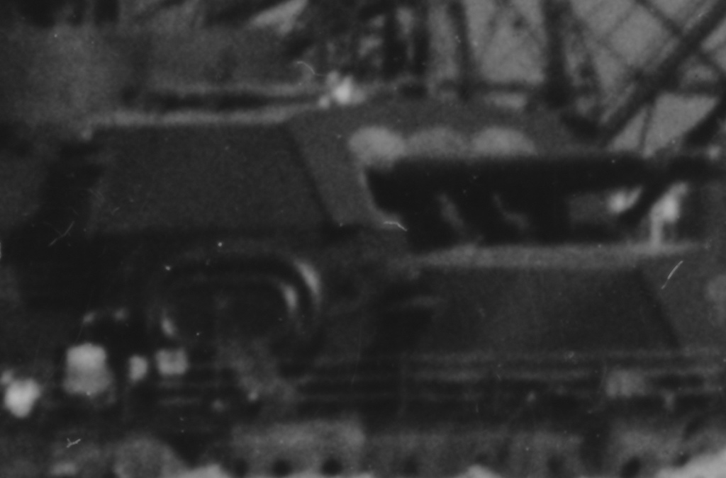

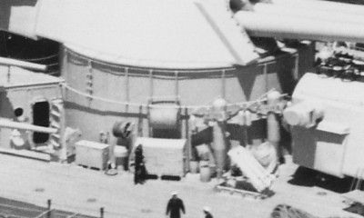

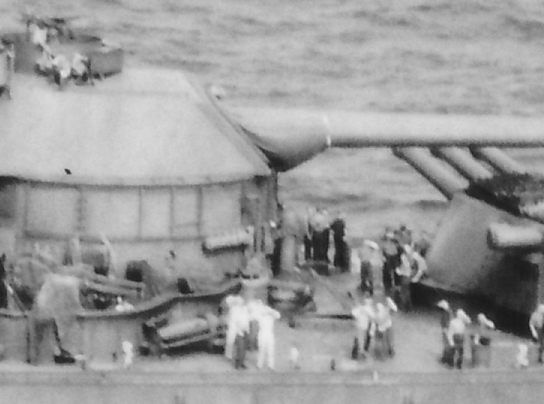

My reasoning for a relocation of stowage of the paravanes onboard USS ARIZONA is based on several factors;
1) At least two paravanes were needed to perform a "standard" sweep operation (a third would likely be a backup/replacement if one was lost in operation and wouldn't need to be stowed close by).
2) In the 8 November 1941 photo of USS ARIZONA in drydock at PHNY, the image isn't the greatest and the paravanes can't be seen, but it is clear that at least on the starboard side of turret #2, two nested life rafts have been located where her paravane(s) use to be located on the barrette.
3) In photos of her sister, USS PENNSYLVANIA, during the 1930's into WWII, she stowed her paravanes on the FRONT of turret #2's barrette.
Cropped view from a photo dated August 1935
Cropped view from photo dated 6 December 1943
I have no idea IF USS ARIZONA relocated stowage of her paravanes to forward of turret #2 on the barrette, or perhaps somewhere else onboard the ship. I'm just about certain she had two or three of them onboard as part of her standard equipment. I don't have many images of USS ARIZONA immediately prior to the Attack on 7 December 1941. A general lack of photos of her and much of the USN Pacific Fleet in the Summer-Fall of 1941 (due to restrictions on photography in general) that causes these questions.

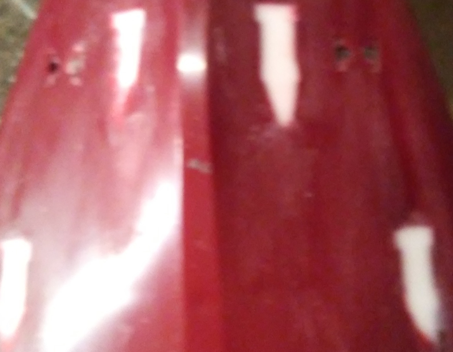

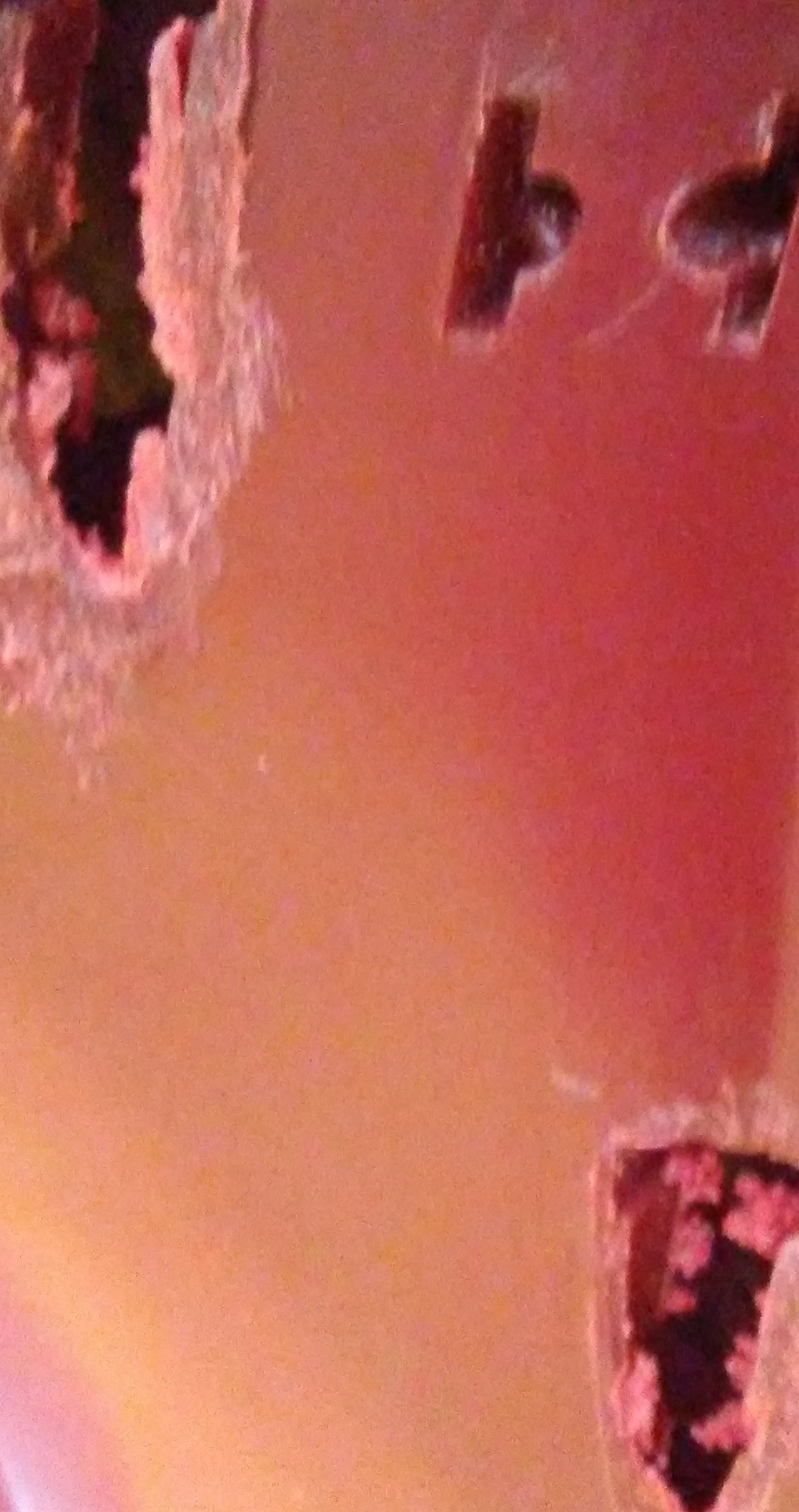

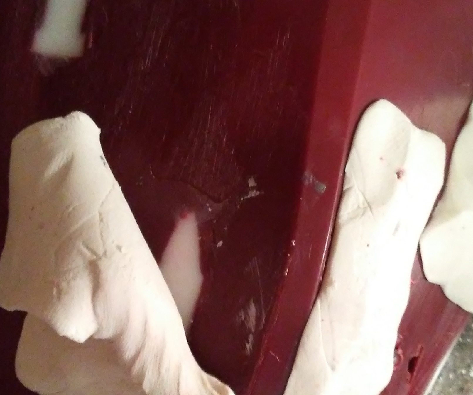

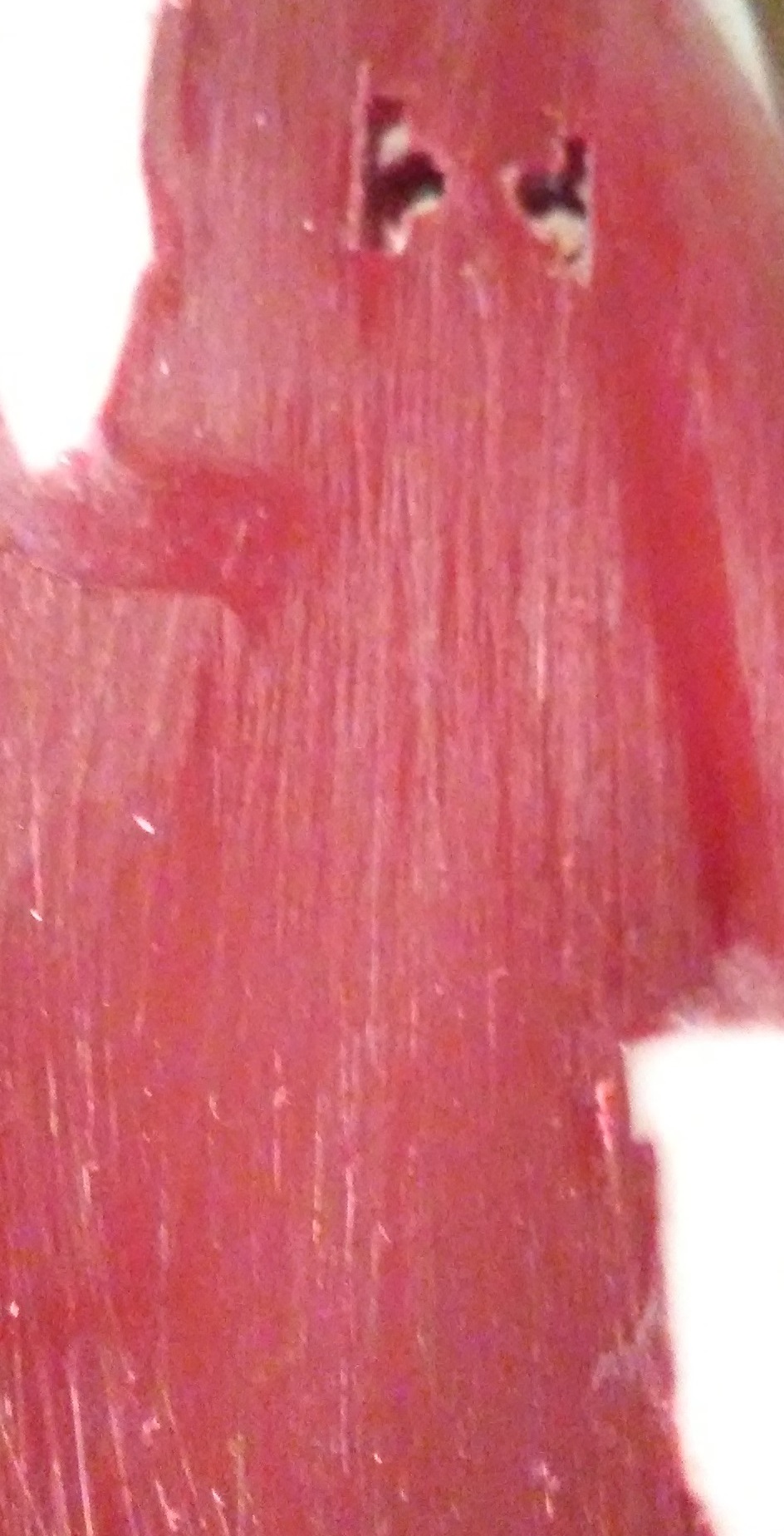

I finally have a little bit more done on my 1/200 scale Arizona. I'm taking baby steps and trying out some (new to me) techniques. I'll have some other posts on these, but for now I'll start off with a mod to the hull. The big openings at the stern of the hull for the propeller shafts were nothing like what is on the ship's hull. I believe these were done that way for the RC kit. So I pulled out my Dremel tool and cut them off. I then used non-hardening mineral clay flattened smooth on one side to cover the outside of the openings in the hull. On the inside of the hull I poured in casting resin that I mixed together. I think the results came out pretty good (see the attached photos). I still have to do a lot of finish sanding on the hull.
A couple of notes on the mineral clay. It does not contain sulfur or gluten so works well with silicone molds (I use it for sealing and filling in 2 part molds) and with the resin. It also does not dry out. It is a bit on the sticky side and will pick up any debris left on the work surface. It can be re-used multiple times and I store the used clay in a plastic bag. It will not dry out if left out even for days or weeks but will collect dust hence the plastic bag for storage.
Franz
File comment: Original opening cut away with a Dremel tool.
File comment: Mineral clay being pulled back after resin dried on the inside of the hull.
File comment: All four openings filled with resin.
File comment: A close up of the filled openings more in focus too.
File comment: The box of mineral clay I was using.

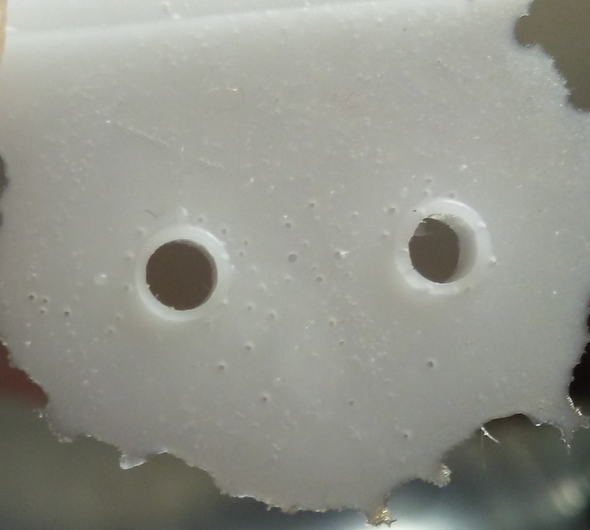

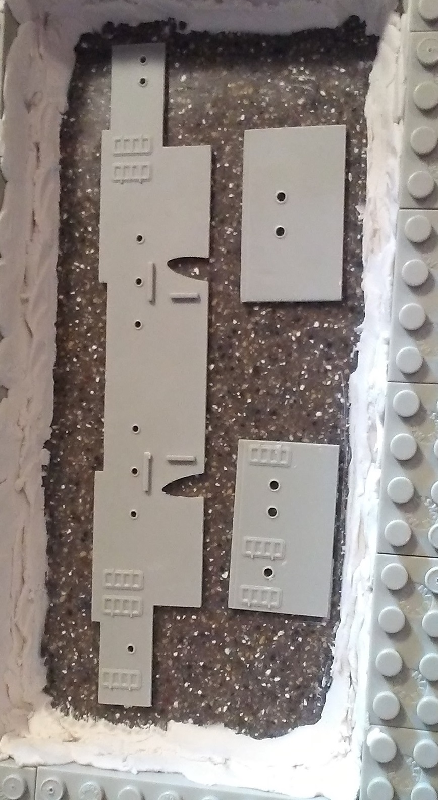

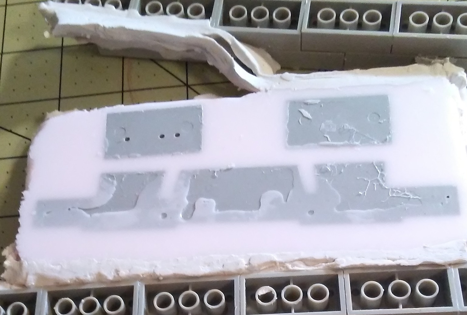

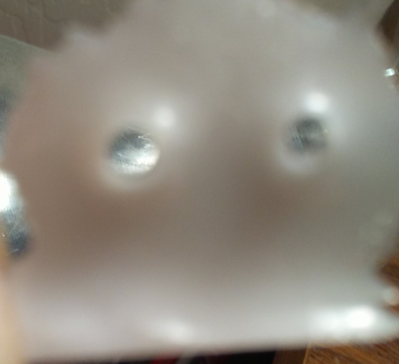

Ok so the second thing I'm working on is to make replacements for the oval port holes on the hull and I found some bulkhead parts with elongated port holes as well. For this I took up learning how to make molds. I went to the local Hobby Lobby with my wife (we both had the 40% off coupons) and I bought the mold making box and she bought the Resin mix. I then took a few of the parts from the ship that were fairly flat and that had good port holes on them to make the mold. I used a piece of left over Corian type material we had from the kitchen counters for the base and made a mold box using Legos and sealed it with the mineral clay (see previous post). I used Elmers glue to attach the plastic pieces to the Corian base. I then poured in the mold material after mixing in the hardener. For my first mold I was pretty pleased. I did get some very small bubbles appearing at the surface but they are so small that I think once the hull is primered and painted they will no longer be visible. I actually made a resin copy of the parts I used in the mold, but the real purpose was to get good port holes. For this I tried to put as thin a layer of resin just around the portholes of the mold. You can see my results in the below photos.
I used the Elmers glue to attach the parts being molded to the base so they would not float in the mold material. Since the surface was smooth and the plastic parts are smooth they poppped off with out any damage after the mold was made.
Note A hot glue gun can be used to seal the mold box and attach the parts to the base, but the glue can not be re-used (that I know of) so I use the mineral clay and Elmers glue instead.
Note 2 The flashing of mold material covering the backside of the molded parts was carefully cut off.
File comment: The Silicone mold material and hardener with measuring cups are in the box.
File comment: The casting resin comes in 2 parts mix both equally by volume or weight.
File comment: The mold box built with Legos on the Corian base using mineral clay to seal it.
File comment: De-molding of the plastic parts once the mold material has cured.
File comment: The results of using a fine layer of resin to create good port holes. The front side.
File comment: The back side of the port holes. Note how the resin built up around the opening. I plan to sand that smooth.

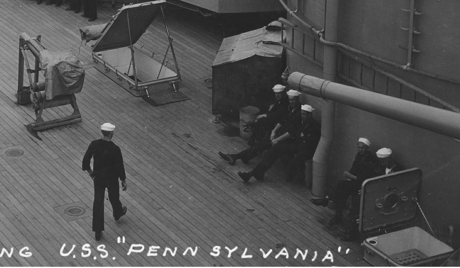

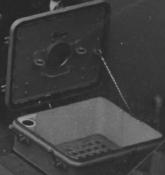

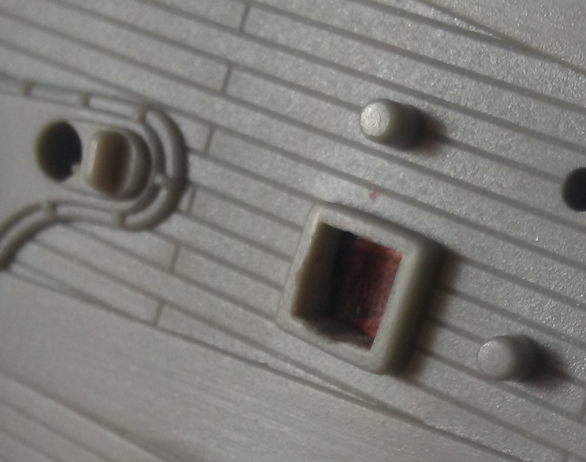

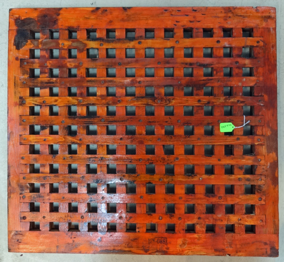

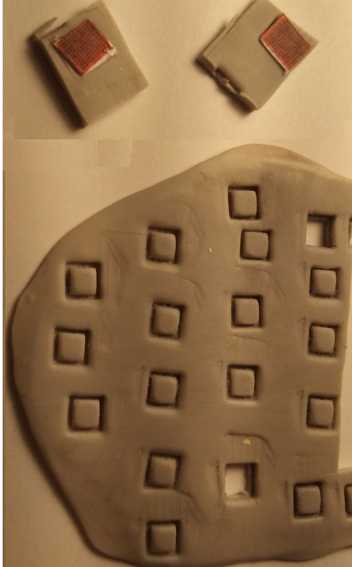

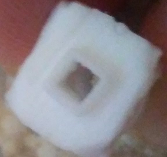

So the final thing I did was to try using polymer clay. It is a plastic clay. It's a bit hard to get malleable but can be worked with once it's warmed up a bit through kneeding. Note that once you get the shape you want you put it in the oven (at the temp it indicates) for about 30 minutes to harden it. I plan to use it to mold some of the electrical boxes and lines on the bulkhead and may even try to make one light that I can then make molds of. I also want to use it for the anchor openings and the correct propeller shaft supports coming out of the hull.
For now I did something simple. I made a punch for the square hatches on the deck using parts of the front bow (not the original, but a molded copy - another story). This gave me a square that was the inside dimension of the square hatch. I combined these with a card stock print of a grate to replicate the grates found in these hatches. See the photo below of the USS Pennsylvania. Note the inside of the hatch is painted white and has what looks like a vent pipe coming out at the back left side. I believe the grates were used to allow for ventilation and to keep anything from the deck accidentally finding its way down the hatch. They would be popped out when using the hatch.
The photo of the deck shows one press fitted in. I did not get the clay thin enough to show a grate on deck, but it works great for press fitting in from below. Once in the hatch you can't tell how thick the plastic grate is. I decided on using card stock to reduce the size of the print to close to the scale (I left it a bit over sized so I could cut it flush with the plastic grate) I glued the card stock image of the grate to the top of the plastic clay grate (after it was hardened in the oven) using super glue. I press fit the grate in from the bottom side of the bow deck. I still need to add the vent pipe to complete the hatch detail.
I decided to try this first as it seemed simple and strait forward and as I plan to leave all my hatches open this will add some detail to the square ones.
File comment: The square hatch is to the lower right of this picture of the USS Pennsylvania. The only shot of the grate I could find with this angle showing what is inside.
File comment: A close up of the square hatch showing the grate and the vent tube in the upper left of the hatch.

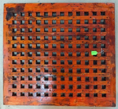

File comment: A photo of a hatch grate I found online. I modified this photo to get rid of the tag and glare. I used microsoft paint to do this.

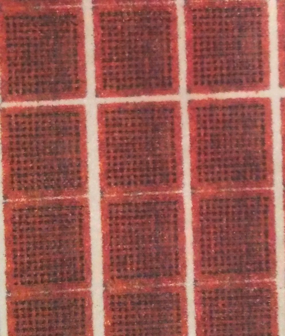

File comment: The reduced multiple copies of the grate photo using page set up to reduce the size. Printed on card stock.
File comment: The polymer clay (after hardening) I used an exacto blade to cut them lose (but not popped out) and glued a grate photo to the top. I thin popped them out and cut off the excess of the photo grate.
File comment: This is what the grate looks like in the hatch. All it's missing is the vent pipe. Note this was dry fitted so will be removed till it'
s ready to be put in permanently.
