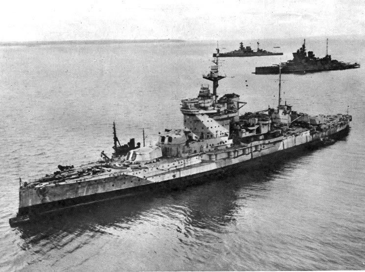

This was it, but later it was well worn and could have lost its clean camo look.
This shows her when she broke her moorings and ran aground on the Cornish rocks, as you can see she still has her camo applied be it worn, photo taken just before she was broken up for scrap :Mad_6: .
Eailer as she was with no camo.
Hope this helps.

There were definitely at least two camo schemes applied to Warspite. Up until her second camo in 1943 the pattern was made up of sharp rectangular shapes.
I think there might have been a change in her last camo as can be seen in the images above on the starboard side of the main superstructure where it looks like the pattern is more of a wrap around design as opposed to asymmetrical one as portrayed in the Academy instructions.

David, I agree. The picture definately shows a difference compared to the diagram in the instructions. Thanks.
Walt

Seems to be a good match for the starboard side in Captain Pugwash's post.

Looking a photos from 1943 to her end I can see slight modifications in Warspites camo. I don't have really good references though for her. In particular I think the starboard side pattern was modified as I described earlier. Also there was an additional patch of dark grey added to the rear top of the funnel. The Academy instructions show her without the patch, but I have seen clear photos of her with the patch. Also the lines on the forward superstructure look much more parellel/angular actually, in her final config than they did in 1943.
Hope there's someone who can confirm this.

I'm far from knowlegeable on this subject but in the research I have done, I have never seen the symmetrical camouflage that is shown in the Academy instructions. In fact, Anatomy of the Ship - The Battleship Warspite, shows her scheme as being the same as in the photos posted by myself and Captain Pugwash.
Also this is on the back cover:
Quote:
From 1943 until the end of her active career Warspite wore this pattern of camouflage
Forgive me if you are aware of this, but I am really interested if there was another scheme between 1943 and her final days.
Mike.
