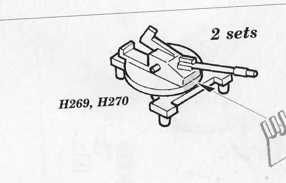

Could someone kindly identify the piece below, which is a part of the 1/350 Revell Bismarck? With my limited knowledge, it does not look like any 20mm or 37mm AA I know of.
(this is a scan from the Eduard turret & armament PE instructions)

Looks like the two 20mm singles on the Army mounts located aft and either side of the aft armoured command post (beneath the aft rangefinder). If you model them, don't forget to model the two trailers for the Sd.Kfz 52 (or 51?). Those trailers were stored beneath the aft searchlight platforms... :cool_2:

Thank you very much Olaf! However, as usual, an answer leads to more questions: were the army mountings present when the ship arrived to Norway -which is the time frame I am trying to model- ?

If I'm not mistaken, the three conical 'feet' per army mount are still visible on the wreck (at least, this is what I have heard or read).
TIA,
Anthony
I asked about this on an earlier post in here, I think we figured out that the shields should be left off the guns.
viewtopic.php?f=47&t=4696&start=280
I have not seen pictures of the trailers yet, would love to see an example if anyone has one. :wave_1:
Happy modelling ~ Olaf!
i dont recall ever seeing 20mm with shields on Bismarck.? is there any pictures Olaf?
