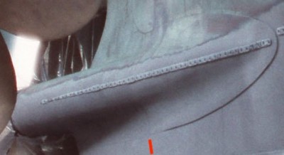

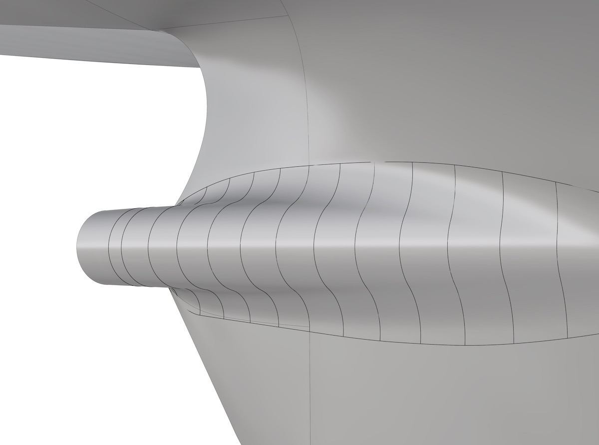

This illustrates the moulded lines of that area. It is laid out a a series of three interlocking arcs.
The aft part of the bossing is part of a large casting. The forward part of the bossing would have to have been shaped. It is 3/4" thick so that would have been no easy task.

That picture/drawing above, is that perspective from 'inside' the trough/centerline of the hull? Or is it from outside, under the gunnel's? It would seem to me (comparing with my Tamiya 1:350 model) that it is from outside, but that does not mean the model is correct/accurate.
PostPosted: Sat Mar 28, 2020 12:44 pm
Posts: 5060
The outboard screw is in the photo foreground, although somewhat out of focus.
PostPosted: Sat Mar 28, 2020 1:10 pm
Posts: 463
Sean_the_Nailer wrote:
BigJimSlade,
That is the outside of the starboard twin keel looking aft. I hope you are not being confused by the AOTS book that shows bossing on the inside (tunnel side) of the keel where these is none. The tunnel side is flat.

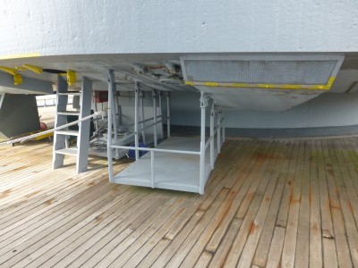

Here's Turret No. 2 on the NJ. The main hatch and the platform below have been removed and moved forward. The hinges are in place and painted yellow. The emergency hatch remains in place.
The hatch on Turret No. 1 does not block visitor access to it remains in place.

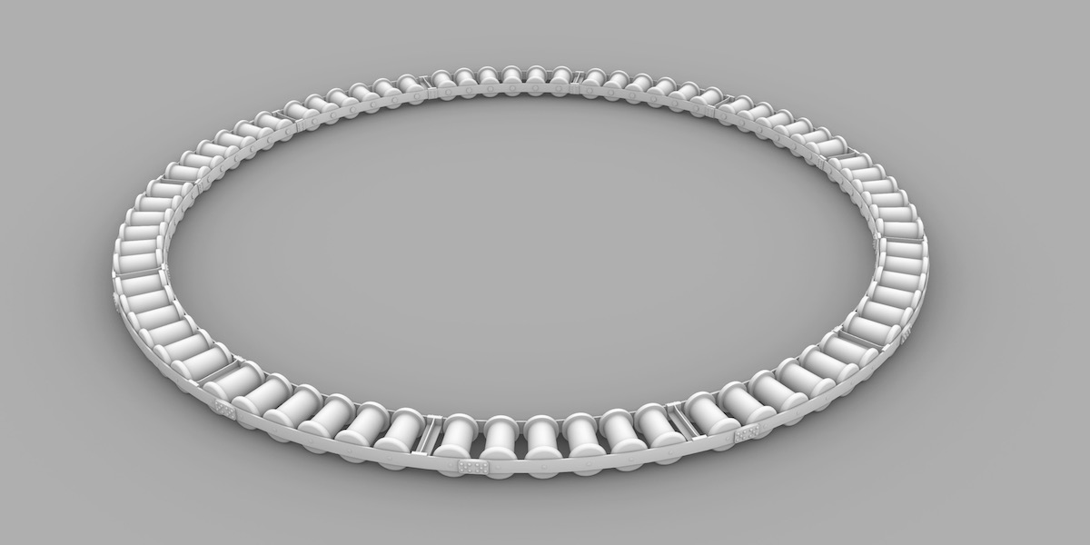

Here's a drawing I did of the roller bearing assembly. This sits on top of the fixed turret support. The revolving part of the turret sits on this. This revolves when the turret revolves but more slowly.
The surfaces of the bearings are cones The bearings are in groups of six. However, they are not evenly spaced within the groups and the groups have different spacings. The lack of an even spacing was supposed to reduce wear.

I think uneven spacing makes it unlikely that if the ship is subjected to shock damage and bearing impress dents into the race, the bearing will then get caught in the dents at multiple angles of train.
PostPosted: Fri Apr 10, 2020 11:18 pm
Posts: 463
That's a good theory.

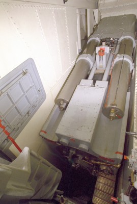

Here are some more details I have found scouring the blueprints. This photo is from the National Archives and can be found all over the internet so you get get it at much higher resolution. It shows the gun in the process of being fired. The yoke at the end is pulled back from the slide so some of the barrel is exposed in the gap. A cylinder at the bottom absorbs the recoil. There is 48" of travel in the cylinder so recoil is less than that (I have seen values between 43" and 48" in print). If the gun recoils 48.0000001" there will be damage. The two cylinders above push the gun forward.
My reason for posting is at the forward end. Just to the left of the side there is a vertical plate. That plate is attached to the turret and runs down to below the gun and as the side of the gas seal (ie keeping out poison gas). Running perpendicular to that plate you can see two plates forming a triangle . They are linked to each other, to the turret roof, and to the slide with hinged. They are the top of the gas seal. When the gun moves down, upper plate moves down so that it is slightly forward of vertical. When the gun moves up, the hinges bend to form a smaller angle between the seal plates.
At the sides and bottom the seal is formed with blades. There is a curved plate mounted under the gun for the seal. In higher resolution, you can see the wear on the vertical plate forming the seal.
I have not measured it out but it looks like they could not use a simple curved plate at the top it would have blocked the gun from moving close to horizontal.

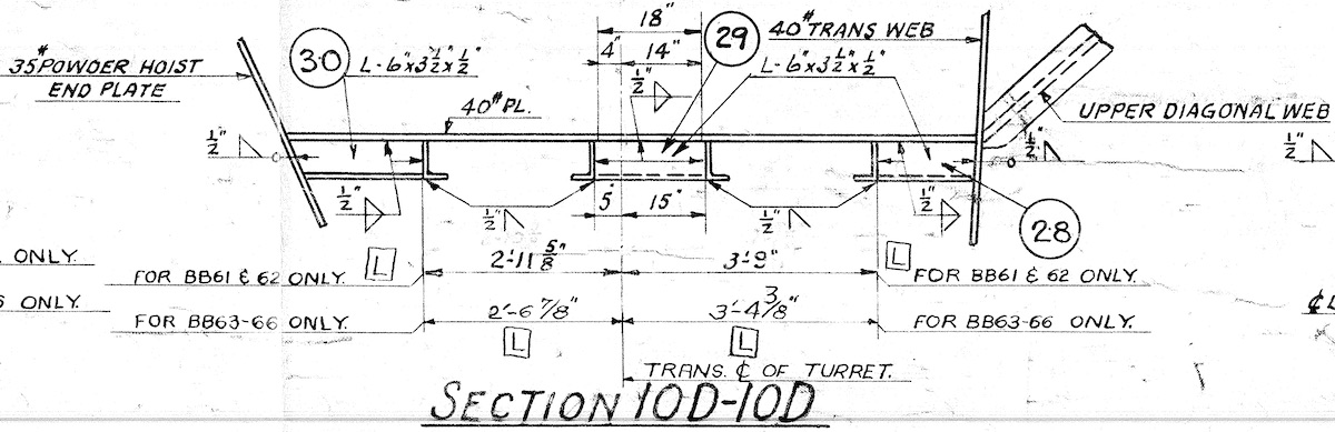

This is an excerpt from plan 7201ZF describing cover plates over the gun girders in the turrets.
The reason I share this is to show that the plans indicated differences among the ships. This is one of the earliest plans (10/31/39) and the last modification is 2/7/40 (nearly five months before the Iowa was laid down). I cannot discern from the changes whether the BB-61/62—BB-63/64 distinction was a change or an original.
These are just minor differences in the placement of stiffeners. It is puzzling to me why there would be a difference.

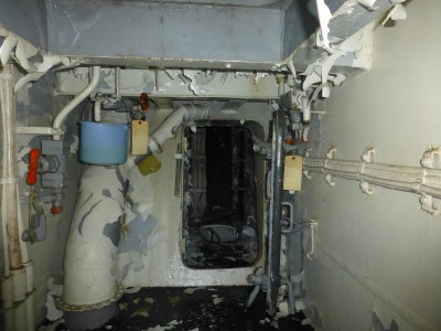

I have a picture I took of this area. There is less than 4 feet between the decks in this area. With the stiffeners above, the crouch space is even less.This is looking aft in Turret 2. The powder hoist to the right gun is to the left of the opening. That is the sloped bulkhead at the left of the plan. The ladder rungs in the background lead to the center gun pit. The opening in the background leads to a void area. There is a bolted plate that leads from there to the right gun pit. I came up an opening behind that leads to the pan plate. It is a maze of twisty passages.
P1040761 Turret 2 platform above pan level at center gun.jpg [ 260.9 KiB | Viewed 3885 times ]
