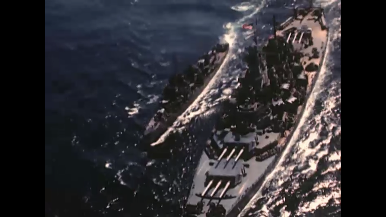

CHANGING COMMAND OF FIFTH FLEET ON USS NEW JERSEY (BB-62)Tokyo Bay, 2/27/1946 https://catalog.archives.gov/id/80009
In color! Looks like NJ is painted in the neutral grays. You can also see Nagato in the background a few times. Credit to Jeff Sharp, who originally posted the link over on SN.

Thanks Martin! There are plenty more films there with some great footage. Here are some stills of Missouri entering Tokyo Bay.

Looks like she still had the tennis (squash?) court starboard of #1 turret. :thumbs_up_1:
