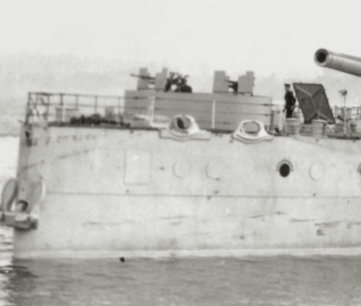

After looking closely at the colour stills of the Valiant ,apart from the two tubs on the quarterdeck containing 20mms ,there seems to a third ,larger tub containing something black(?),set further aft.Has anybody any ideas what it could have been ? To me it looks like a quad Pom-Pom mount ,but I didn`t think that Valiant had extra 2pdrs fitted at that time.
Thanks Phil
Thanks Phil
I think you mean this. Tub for 2 20mms side by side! Looks like a medicine pill when looked from above. I think it was added 1942.
Mikko Saarela

Thanks Mikko,that looks to be the answer.
Many thanks Phil
