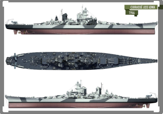

Hi sailors,
I am just wondering what the deck of the USS Iowa was back in 1944 in the attached camouflage pattern. Was the wooden planks removed and there was the plain steel deck only OR was the wooden deck just painted?
Any idea?
Jack
PostPosted: Thu Apr 29, 2021 9:54 am
Posts: 489
Hi Jack,
No, the deck was not removed. Where would they store all that teak? The teak decks were actually painted blue. The USS Missouri had blue decks at the time of the Japanese surrender but during the trip back to New York the deck was holystoned back to it's original teak color by the crew.

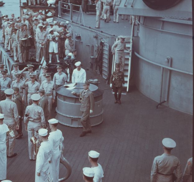

I would beg to differ further with "guest" -
His (Navsource) photo shows the 01 Level, not the main deck. I have two great photos of the surrender area in color only one is 82MB in size and I don't have the time to fiddle with it tonight. Here is the other, still a good photo that shows both the 01 Level and main deck:
I believe the photo speaks for itself.
PostPosted: Thu Apr 29, 2021 9:01 pm
Great photo. Thanks.
So it looks as though the main deck (or at least a portion of it) had the blue paint removed, while the 01 deck (or at least a portion of it) was still in blue, and the other decks were ...?

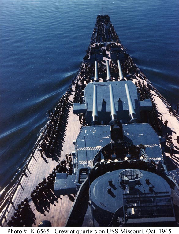

PostPosted: Thu Apr 29, 2021 10:19 pm
Posts: 4046
Top photo, October 1945, vicinity of the Panama Canal, Missouri on her way home.
The natural wood decks appear distinctly different in this photo than the color of the decks in surrender ceremony photos taken a month earlier.
The 31-star flag is odd.
