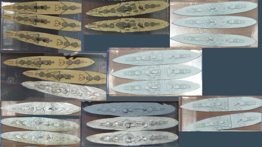

Here's my 2400 QE & Rs - still working on the paint - the tan & light grey I traided for - the dark grey & unpainted are mine.

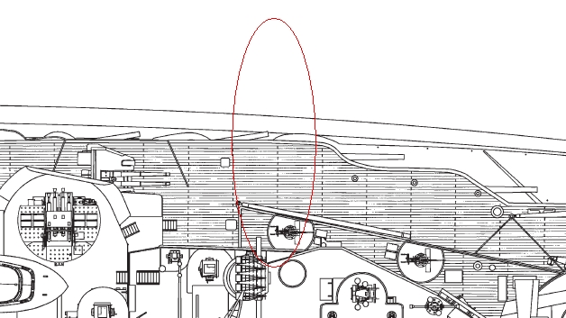

Hi, I´m new in this forum, hope you guys can help me with some information regarding Warspite drawings.
I´ve seen in the web a lot of drawings, pictures and models of Warspite during WWII, but I still can't realize if there is a small piece of steel after the second 6in gun on both sides. To make it more clear, please look at the following drawing of Warspite that doesn´t include that "piece" but I marked the position where ot should be in red.
Appreciate of you can help me to realize if that piece should be considered on Warspite 1942 and 1943, or not, and if I have to consider it in the model, please et me know what the porpouse of that small part.
Sorry if my english is not so good, I tried to make it clear as I could!!
Thanks!!
Fernando

The ship had small sounding machine or "leadsman's" platforms at those positions, port and starboard on the upperdeck. They were apparently still present during WW2 and are shown in the Anatomy of the Ship by Ross Watton. Some drawings suggest that these extensions may have been hinged for folding, but I have no post-reconstruction photographs available to prove this. But they were there, just where your marked area indicates, and by WW2 they may have been fixed (not fold-away).
Hope this helps,
Dan :thumbs_up_1:

Hi Dan,
Thanks for your message, found it really helpfull. I´ll consider it for my warspite model, and keep looking for photographs, where it can be appreciated.
Thanks!!
Fernando
