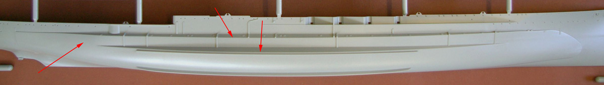

This is somewhat long after the kit came out but I have only recently started working on the Academy Warspite.
I'm troubled by how they have molded the torpedo bulges, in particular the lines of the outside corners where the two sloped tops turn to a vertical sides (the lower edges). Academy have molded these in graceful curves similar to that of the bilge keel below but in the AOTS book (and on a Trumpeter QE I built previously) these lines look to run distinctly horizontal. This means the slanted surfaces maintain the same width along their entirety (and makes them longer) whereas with the Academy version they narrow and flatten out towards the bow and stern. This also affect the rubbing strip.
I've also noticed that where the lower wider torpedo bulge merges back with the upper into a single torpedo bulge structure, it kind of bulges out again, This is most evident just aft of the Y turret, not so much at the front. It's not so visible but I find if I run my finger gently along the hull side, I can feel the change in direction quite clearly; If I press a stiff piece on plastic rod against the side in this region, gaps can be seen where the rod is pushed out by this. The deck drawing in the AOTS suggest that this area maintains a simple smooth curve, but admittedly it is harder to interpret this.
Here's a photo that hopefully make it clearer which lines I'm talking about and the area of the bulging
