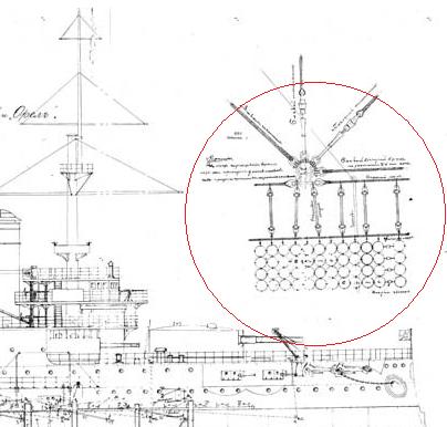

Quick question, what is this I have circled?

Charlestonguy wrote:
...what is this I have circled?
These are details (elements) of a design of net defence.

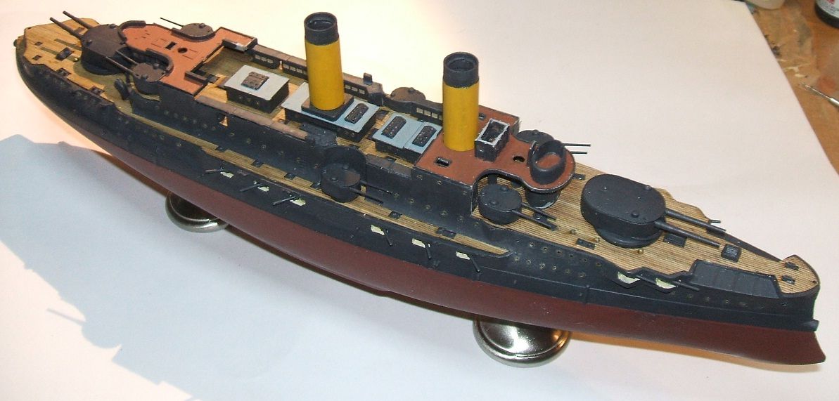

And here is my latest test fit... I'm about as far along as Bondoman, just working different priorities... I think mine makes an interesting contrast with is - two different interpretations!
More pictures on this WIP thread: viewtopic.php?f=59&t=64144
File comment: Test Fit- lots of pieces just friction fit in place...
