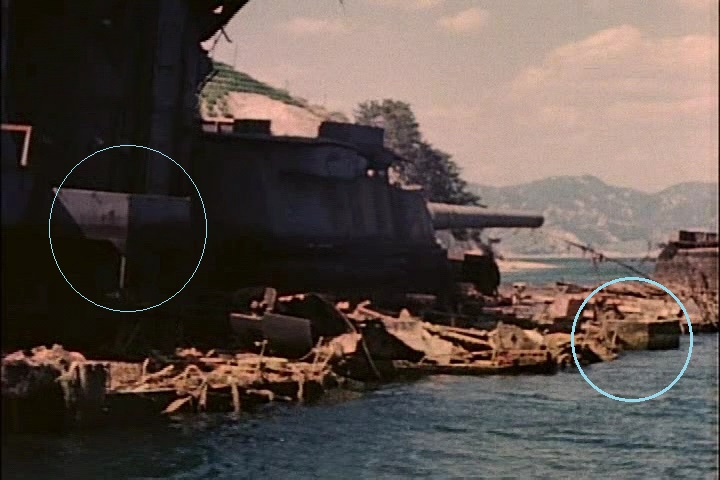

I looked up this video and made some stills.
https://www.youtube.com/watch?v=O6RAfIwsnR8
Unfortunately there is no clear shot of the area in question, however based on this picture there was no third platform extending over the main C turret.
This led me to a conclusion that there were only two platforms on either side of the aft superstructure containing for triple guns which makes this depiction fairly accurate:
However, if you count the triplets there is 30 of them which is fine – but where the heck is a pair of double ones?
There is a slight possibility that one of those in illustration is in fact a double one, so there must be another platform somewhere.
Looking at the above video (at 1:41) I found this:
Judging by the angle it is slightly aft of the long removed gun from casemate no.7 Could it be a platform for a triple one or a shield for a single one?

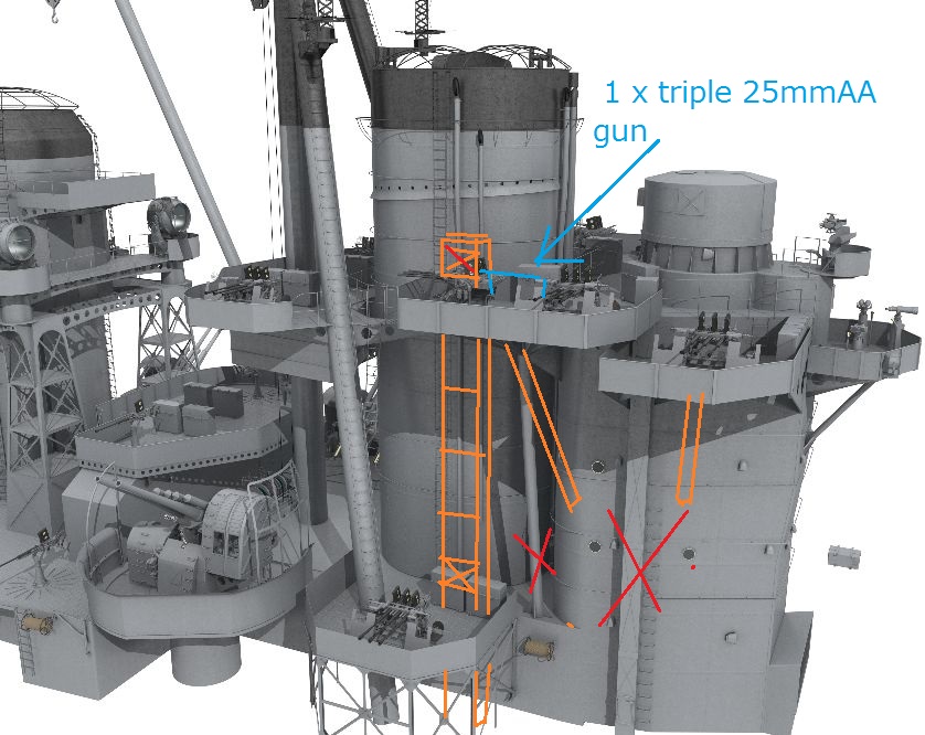

hi, again.
I have been septical of positoning of 2 x triple 25mm AA guns here,before, recalling the author of the CG was quite pressed for the deadline,he had to spring over many search points.
My understanding is, the beam-supports ought to be right at the bottom center of the MGs to increase stability to prevent vibrations. The rendered images and the kit models as well as other sources don´t show this correctly.
The ammo hoist(s) here is malplaced in the author´s image,too.It should be at where I drew it in orange color.
Then 2 x triple AA mgs ought to be on either side on the aircraft deck,making a total of 30 in al,l doesn´t it?
(However, if you count the triplets there is 30 of them which is fine – but where the heck is a pair of double ones?)
As to a pair of double ones you mentioned --- i have no visual or other material to show them at present. Where they are supposed to be placed --one possibility will be around the stern deck area, perhaps or not.
Hoping some solutions might have been arrived at.
mucho,
Haruna rend.200 ammhoist & beamsupport 1 triple 25mm AA gun only.jpg [ 157.68 KiB | Viewed 3857 times ]
Last edited by Mutsuo Sasaki on Fri Nov 03, 2017 10:47 am, edited 1 time in total.

I think it´s utmost possible mr.Ishibashi´s interpretation of the shape of the AA mg sponson hanging over the C-turret which JuriJ is doubting may be erroneous. IMHO these sponsons look like separated or spit into two.
Am duly suspecting his illust of the platform where the ammo hoist is connceted to is overdimensioned,too.( I put quesion marks in orange color)
mucho
I just can’t believe how annoying this conundrum is. Surely there must be a decent picture somewhere of something weighing over 32.000 tons.[/quote]
Something to add to:
Here is another shot taken of portside where the gun tab is recognizable(sometimes it is submerged in the water)
I bet it´s dimension is the same as those of other triple guntubs.
mucho,

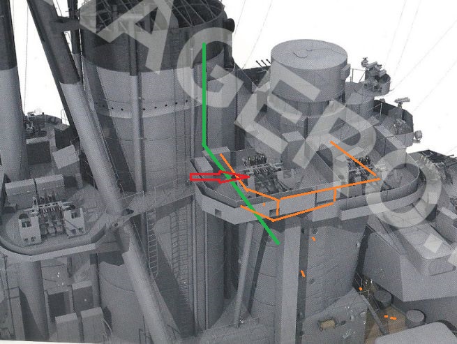

PostPosted: Fri Nov 03, 2017 11:21 am
Joined: Fri Oct 13, 2017 5:35 am
Posts: 25
Hi Mucho,
I’m glad we are on the same page here.

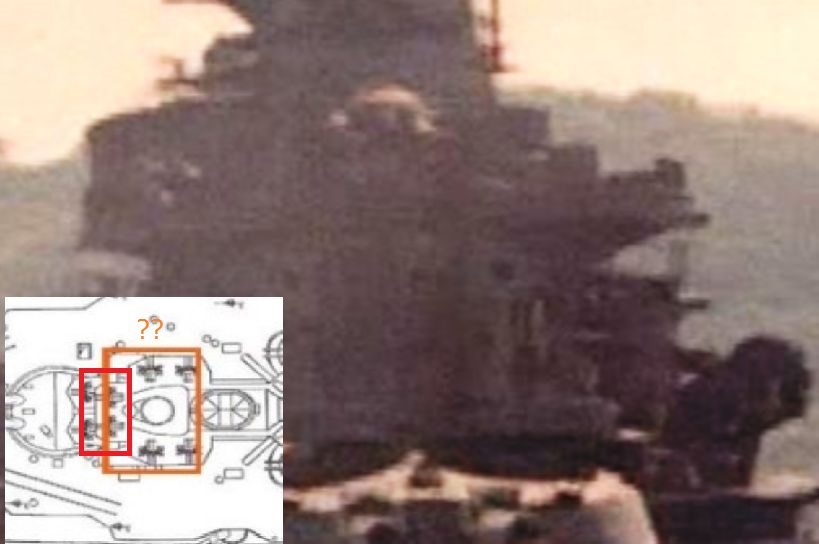

Those would be very good spots for additional triplets. Good firing arcs and not much hassle with adding platforms. I’m planning to remodel the ship according to this:
Marked in Green.
However, the number of triplets is now 32, which means two of them are twins – but which ones.
My bet would be the topmost pair on the superstructure (Marked in Yellow) for simple reason of adding too much weight on already overburdened structure.

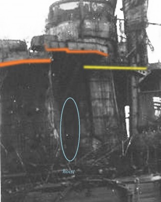

One question...Is this an ammo hoist or just some weird play of shadows?
Image[/quote]
..........................................................My humble answer is;
This must be the ammo hoist while remaining materials used for camouflaging are hanging down here and there.
There are several other visual materials showing the hoist.One or two were already posted in this thread. I´m in retrospect that the author got so inspired by hitherto unknown sources,that he got a new idea that there actually are 4 x AA mg ammo hoists around the rear bridge/tripods.

On this picture the ammo hoist seems to be besides the superstructure and not beside the funnel...

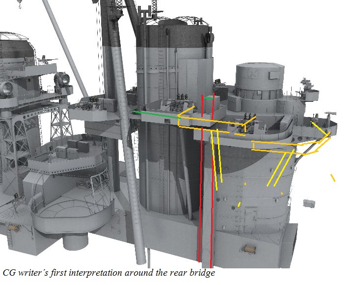

hi, again
Have been watching the same pic as you have posted. I think it was the late Bille Somerville who dug this image out some 1o years ago. He then posted it on IJN forum.
A crusial issue will be the CG writer has made a fundermental mistake in location of the mg gun tubs around the anti-heat shield of the nr.2 smoke stack to protect the AA platform ,and to suppose the ammno hoist goes through the floor of this AA platform to bear the burden of weight of the platform, the hoist ought to be located here,attached is a work-in progress image then. I hope a model or a mock-up model of this will help find out more precise location of the hoist. I dont´t remember when he has changed the numbers of AA triple guns from 1 to 2, though.
And the gangway ought to be much longer....
thanks. About the total numbers of the triple/dual AA guns, i will be writing back later.
mucho,

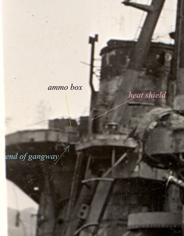

I took the liberty to scan the final interpretation from the book. (added some sort of watermark myself).
The placement of the hoist makes sense to me. It's doors(hatch) opens on the top of the superstructure which makes it easy to serve all the guns around it. (No matter how long I look at the following picture, I cannot see one being on the other side).
It would be rather awkward if the extraction point of the hoist would be on the narrow gangway, which means id pierces both platforms.
If I understand correctly, the lines you added to the picture you posted are your interpretation of the extension of the platforms.
I will make a mock up in the following days according to my understanding of the matter.
My guiding principle will be derived from this picture:
Except I will not be extending the gun platform further abaft. I think that the lower platform begins to narrow before the edge of the superstructure and is roughly following its contours.
In my understanding the only thing that was extending over the edge of the superstructure was an observation platform in the middle.

Ammunitions shoud not be exposed to heat-radiation from the smoke stack,so, ammo boxes and guns must be kept within the cover area anti-heat shield provides with. I drew it in green color of line. I can safely say this is not my interpretation, but, is one of rules of IJN´s administration of ordnances.
The location of ammo hoists being symmetrical for strb-and portside,one can narrowly see the starboard one in the image.
And finally or not,the FC gear ought to be in a pair,on either side of the higher AA platform. Time to build to do re-checking. Surely this will be able to tell us much better than descriptions about the placing.

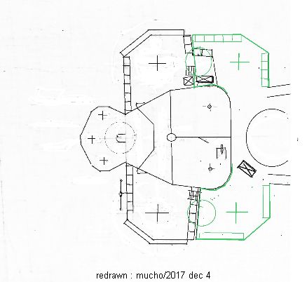

PostPosted: Mon Dec 04, 2017 5:19 am
Joined: Tue Dec 10, 2013 3:33 pm
Posts: 296
Location: The Savo Island

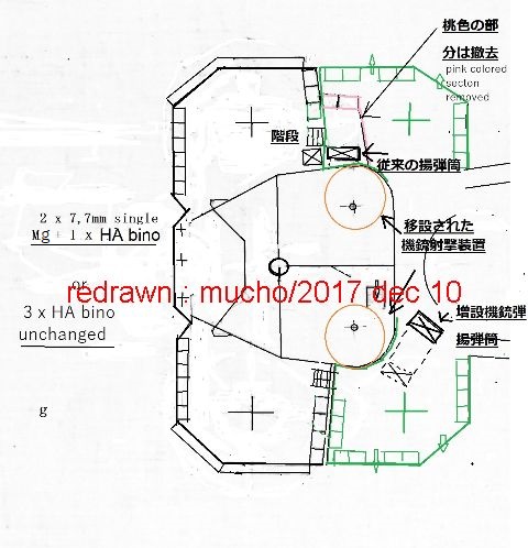

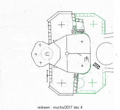

I had time to re-check the AA sponsons in question. They don´t overlap each other.
FC gear was added for the Leyte Opr.,so they were located on either side.
mucho,
This is just an interim search, still keep on checking....

Here is how I believe things around aft superstructure looked like:
This is still "Work in progress" as most of the details are still missing.

Talked with mr.Suzuki(pres.of Pitroad)on annual NY assoc. meeting 3 days ago here in Tokyo,he may be equal to reflecting new discoveries on Haruna kit model,1/350.
mucho
