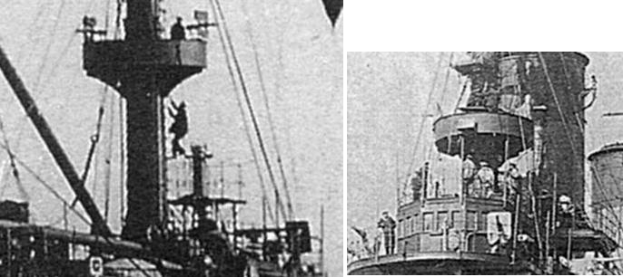

Hello All!
Bondoman! Something is not right with the height of marses.
Mars sides height from project drawings is 30" = 762mm. In 1:350 is near 2,2mm.
Human height 1650mm in 1:350 is near 4,7mm.
On Your model mars height seems like human size and ship becomes more French-like. :smallsmile:

I'm not familiar with the term marse, so thank you for that. I would call it a fighting top. I'll take the 2.2 mm and measure it against mine. I made mine from brass following the human height idea, certainly taller than the kit ones and they do look too tall. Also the one on the foremast looks too close to the bridge, but that can't be helped. Making them shorter is an easy task, so thank you very much for the input.
Are those maxim guns? They look serious!
EDIT: the mars or tops I built are exactly 5mm. Off they come and to be replaced by 2.2. Is that above the little deck, or height overall?

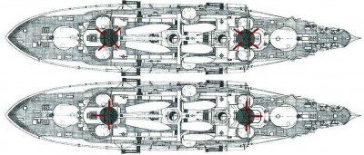

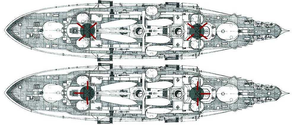

My mistake, Bondoman! :doh_1: Mars - Russian term. English - Top. Size of 30" is overall height of top.
Ships of that time had stationary mounts for landing guns, steam and torpedo boats armament. Simple reason - not to store these guns as cargo, but to use somehow as anti-torpedo guns, despite they were less effective, than ship guns. Same here - all Maxim guns are really a standard armament for steam and torpedo boats, in case of need they can be lowered and mounted on boats.
Still I am not sure, but seems, that on most photos We see two schemes of mounts. Possibly, because 2 guns may be lowered and used on patrol torpedoboats together with 37mm guns.
