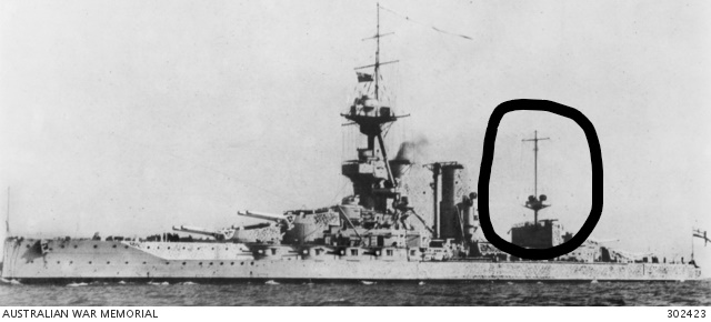

When did the Iron Duke get the mast on the aft superstructure (circled, below)?
The Combrig kit alleges to be 1918, but Burt (British Battleships of WW!) says the aft mast wasn't added until 1920-21. I can't find any good photos of Iron Duke in 1918, only her sisters. Marlborough seems to have a smaller mast on the aft superstructure in 1918 (no searchlight platform) and Emperor of India has no mast. Trying to find out which is correct for Iron Duke before going too much further.

Maritimequest has a photo of her which the caption says was taken at Malta in September 1919, and she has no aft mast, so if accurate it means she didn't have it in 1918. Hope that helps.
https://www.maritimequest.com/warship_d ... n_duke.htm

Thanks. I knew I had seen that picture somewhere, but kept looking through Burt's books trying to find it! :doh_1:

in Perking's book on identificatiion of british warships vol 1 mast was added in 1929
