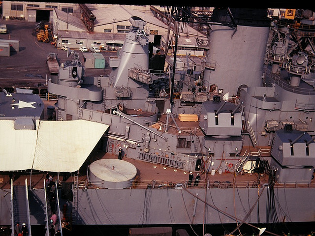

Does anyone have information on stowage of accommodation ladders in 1943. Hank was kind enough to supply me with a picture of forward stowage. I am curious about rear stowage. Also, how many accommodation ladders were on board in1943?
Scott
Salisbury, NC
USS Iowa BB61 1943 post refit
1:200 Trumpeter w/ Pontos detail up with deck
USS Missouri BB63 1945 1:350
In planning T2-SE-A2 tanker AO-82
PostPosted: Thu May 18, 2017 7:14 pm
Posts: 2948
Location: Mocksville, NC
Scott,
Edited:
There were four accommodation ladders stowed aboard the ship; two for each side. They were both stowed in the same location on either side of the main deck superstructure. I think there maybe a drawing in the Floating Drydock Plan Book of this and if so, I'll post it Monday when I'm back at work - the book is at my shop. We actually stowed one of ours against the after starboard deckhouse, but this was during Vietnam Era and obviously had changed from earlier times. I think we had two stowed opposite on the port side, one above the other. See photo:
Hope this helps!

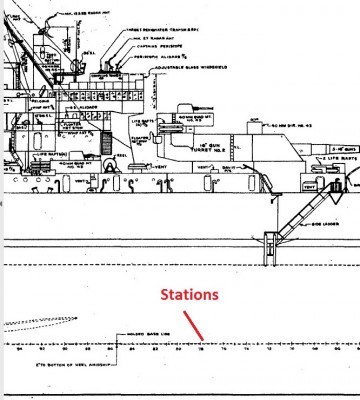

Today I received TFD BB61/1987 1:96 plans. First thing, I scanned the Body view, and when I opened it in Photoshop, I discovered that the vertical center line and horizontal lines aren't square with one another.
Is this a common thing to see on plans?
Unless I'm advised differently, I'll make the vertical centerline true, pop the scan into the CAD program, line up a horizontal line at the bottom of the vertical line and create horizontal lines at the marked heights. (Of course, a couple of the height dimensions aren't readable. . . .)
And, I haven't found a Half-Breadth view, either, which Gene Bodnar in his article, "Scratch Building A Model Ship," says are necessary. However, a half-breadth view is included in Witold Koszela's book of plans for BB61, "The Battleship Iowa." But, then, I'm mixing drawings from two different sources. Sigh. . . .
Welcome to model shipbuilding, I guess?
Brian Chapman
Cedar Rapids, Iowa
PostPosted: Wed May 24, 2017 10:35 am
Posts: 3954

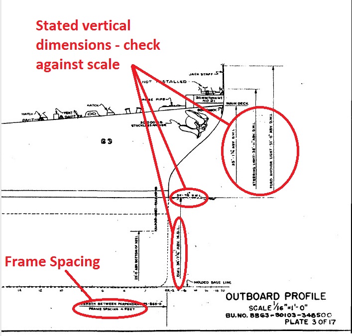

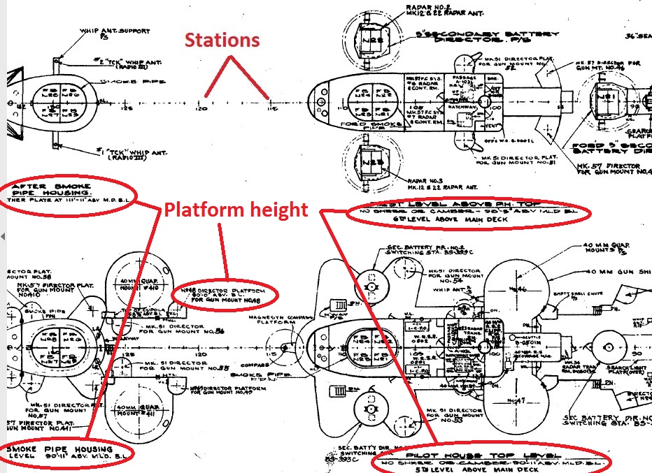

Hi Brian,
Yes, unfortunately, this is normal.
As is often the case, original plans drawn with stubby pencils, steel rulers and slide rules on paper, vellum, cloth or other media can and do become distorted over time and sometimes the present form does not scan well. The distortion can occur due to a variety of causes, from poor storage of the original documents, to errors in the original documents, to bad scans or copying of the original documents.
Sometimes, the distortion is not uniform across the drawing. It may be stretched or shrunk a bit here and there, and even different in the X, Y or Z planes.
I sometimes find cases where multi-sheet plans available freely online were scanned in different scales on different sheets!
Obviously, these issues pose a challenge for the modeler that can be difficult to address. The best advice that I can offer you is to carefully look at any graphical scale on the drawing to see if any distortion is visible in the graphical scale. That is a big indicator of horizontal distortion. If no graphical scale is present, study the stationing ruler.
For an Iowa class drawing, the stations are probably 4 feet apart as they are in the example (if spacing is 4 feet, "Station 10" is 40 feet from "Station 0"). Check to see that the station marks in the drawing are uniformly spaced along the entire length of the hull. Then check to see that the stationing measurement matches the stated scale of the drawing. For a 1/96 scale drawing, 40 feet = 127mm on the drawing. For the 1/192 scale example, 40 feet (10 stations) = 63.5mm.
To check for vertical distortion, compare any stated dimensions on the drawings such as deck and platform heights to the graphical scale or stationing ruler. For example, if the drawing explicitly states a platform is 40 feet above the base line, the height of that platform on the drawing should measure 63.5mm above the base line when checked by hand with a ruler, or using a measuring tool in your software.
Usually, the stated dimensions are accurate. But sometimes, even they have errors and you have to check, then double check, then check again.
Once you've identified any distortion, you can decide whether or not any adjustment is needed and how much and where.
For those wanting to know the math needed for station conversion on a 1/192 scale drawing, for example, if you start with 10 stations (40 feet), here you go:
40 feet x (12"/foot) x (25.4mm/inch) divided by 192 = 63.5mm.
For other scales, substitute your desired scale for 192.
Good luck!

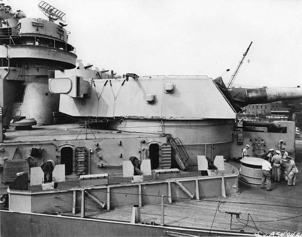

I've just started working on a Tamiya 350 Missouri - planning on doing a September '45 build. Does anyone know if the turrets were equipped with those small crane things at that time (1 or 2 per turret)? It looks like Iowa was, but I'm struggling to see them in photos of Missouri at the surrender ceremony...
PostPosted: Wed Jun 14, 2017 6:25 pm
Joined: Sun Apr 17, 2016 1:30 pm
Posts: 143
Location: Salisbury, NC
The crane things your referring to are used in the loading of the shells. I can't say for sure if any turrets had them in place at the surrender ceremony. The pictures I looked at on Navsource did not show any I could see.

Martocticvs wrote:
Those "crane things" as you called them are actually davits located on all (3) 16" turret tops to lower 16" projectiles & powder canisters to the powder magazines and projectile handling rooms. The davits are positioned on each turret to specifically operate with a specific scuttle. On either side of each turret in the deck towards the rear of the turret is a flush scuttle where the ammunition is lowered. These davits were in place in WWII and this photo illustrates one of these davits on Turret 2 of USS IOWA (BB-61):
