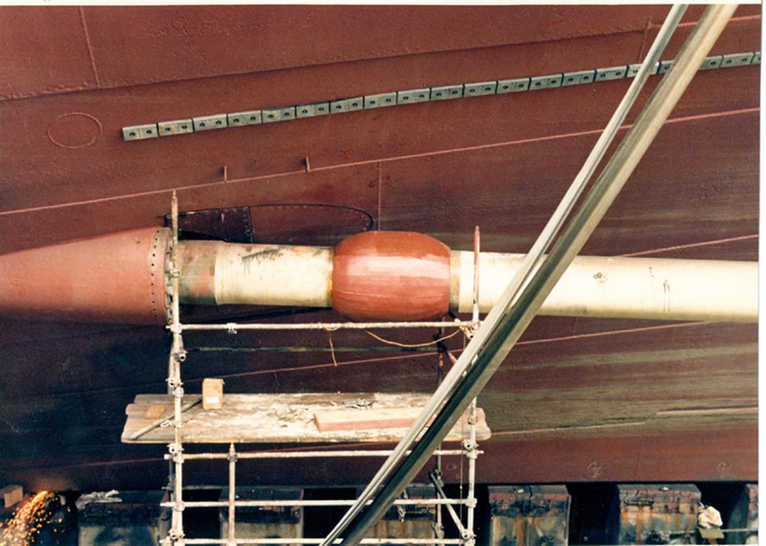

Well, I missed that "little" detail also - I went back and sure enough, the outboard shaft openings were missing. These things happen - don't beat yourself up too bad, you caught it in time.
I don't know that I have any other photos of any of the IOWAs that would help. I'm not sure what Chuck mentioned above, but here is one shot of BB62 in LBeach (1981) of her port outboard entry point:
Hope this helps!

After studying all the photos at my disposal, here is what I came up with. Both strut supports have an identifiable angle between the hull and the strut bushing - most likely for the purpose as stated by James, although I always thought a triangle was stronger. I suppose this arrangement allows for more symmetric flexing under off-axis loads(does a propeller shaft even flex side to side? intuitively is seems that it must...)???
Anyway, here's round two. I'd hoped to get (much) more bench time today but it just wasn't meant to be. As always, point out glaring deficiencies. Heck, when I was building my Boston a kind soul pointed out that I had installed the #2 barbette upside down...

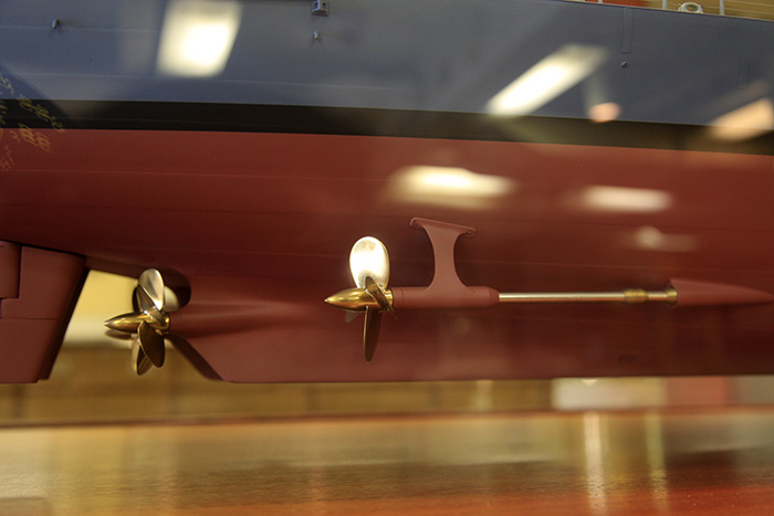

PostPosted: Mon Jan 12, 2015 1:19 pm
Posts: 5011
Perhaps a coupling or for dynamic balancing? Attached a photo of the very nice John Haynes model in the wardroom of Missouri. Note the hull plating and struts. As is often the practice, he left the shafts in brass, sort of a model bling effect. Props of course are not brass either, but an effect we often live with, a convention if you will. His plating etc subtle and well executed. He also dd all the padeyes along the bow overhang, an advantage of working with a larger model.
