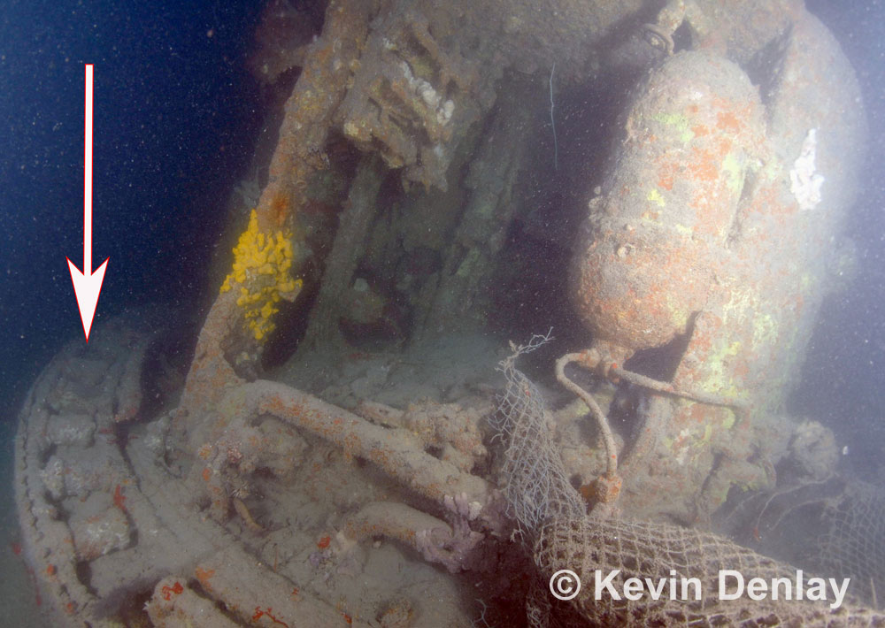

This illustrates the moulded lines of that area. It is laid out a a series of three interlocking arcs.
The aft part of the bossing is part of a large casting. The forward part of the bossing would have to have been shaped. It is 3/4" thick so that would have been no easy task.

BigJimSlade,
That picture/drawing above, is that perspective from 'inside' the trough/centerline of the hull? Or is it from outside, under the gunnel's? It would seem to me (comparing with my Tamiya 1:350 model) that it is from outside, but that does not mean the model is correct/accurate.

The outboard screw is in the photo foreground, although somewhat out of focus.

That is the outside of the starboard twin keel looking aft. I hope you are not being confused by the AOTS book that shows bossing on the inside (tunnel side) of the keel where these is none. The tunnel side is flat.
