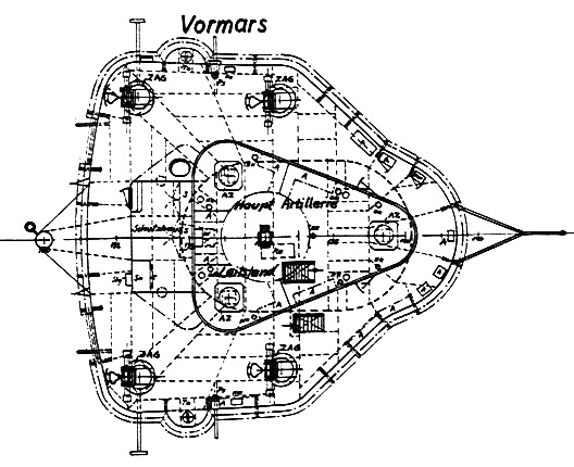

Hello all,
I have gone well into designing the Tirpitz foretop deck, but just came upon an issue... The Mirosław Skwiot's drawing shows the supports under the foretop platform in side, fore, and aft views, but none of top (plan) view, which would most accurately depict the angles of each support. I attempted to trace the angles from the given views, but soon I noticed that the plans are slightly erroneous as each view isn't in correspondence with the others. I am not certain if the more complete Gally plans provides the information on this, but if they do, I'd be happy if anyone could share sectional scans of the platform supports. If not, I'd like to know how to buy the entire plans from Hans Gally, since I will need it for my Tirpitz project anyway.
Thanks in advance,
Aop

Even more detailed than Gally:

Hello
Herr Nilson
Nice drawing. Where did You find it?
Thanks
best regards
Chris
PostPosted: Sat Mar 10, 2018 10:00 pm
Posts: 972
Location: Bangkok, Thailand
Thanks for the drawing, Herr Nilsson. :smallsmile: I too want to know where you got drawing from. It actually shows details many other drawings miss. Does the plan contain other views of the platform, e.g. profile, front and aft? And do you have them at a higher resolution? I would appreciate you e-mailing me at aopaurshipmodels(at)gmail(dot)com
Thanks!
Aop
German Federal Archives
There are no other views in that plan. I think the resolution is good enough for your purposes.
Being more specific: see 'Antwort #10' on this forum page: http://www.forum-marinearchiv.de/smf/index.php?topic=12964.0

Being even more specific:
RM25/4-46 :big_grin:
Thanks for the link, Maarten! So the archive website offers drawings for the Tirpitz? The website has a language choice, but it seems their english page provides much less info than in its original language.
I didn't see that number in the forum answer...is that the number of the foretop drawing? Could I order it from them?
Aop
