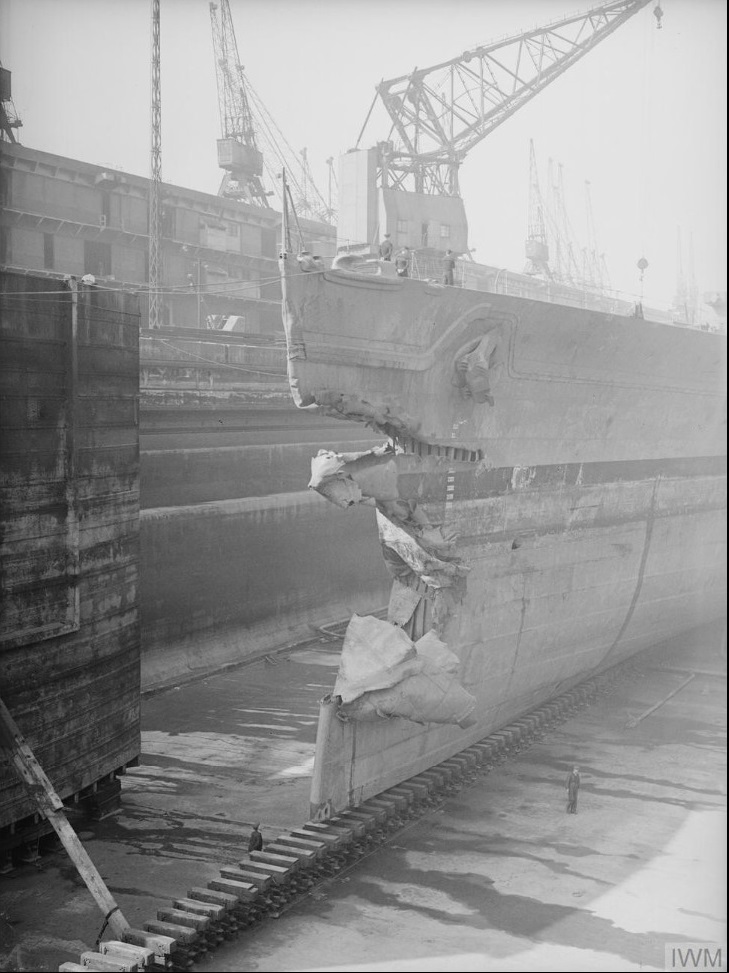

Having now seen KGV’s D495’s, the colour of her bottom can be determined.
Until 1945 she was a Moravia ship (like Ark Royal). Moravia anti-fouling came in black or grey. Although her D495’s do not state whether black or grey Moravia anti-fouling was used during this period, various dry dock photos of KGV show the lower hull to be significantly lighter than the boot topping so we can say that her bottom was grey November 1940-1945.

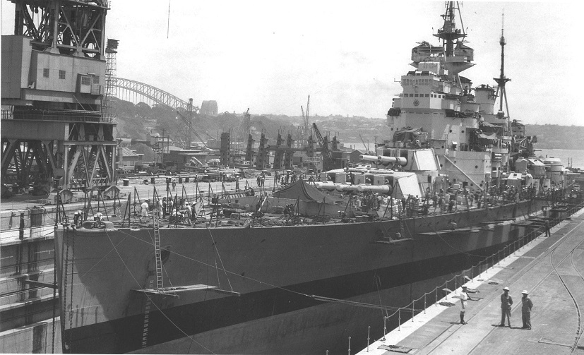

At her November-December 1945 docking at Sydney, Mason’s (Australian) anti fouling was used and the colour of this was recorded: grey.

I'm not sure it should be particularly light - bear in mind (please someone correct me if I'm wrong), in the photo above where she has the damaged bow, I believe she was still painted in 507A/B Dark Grey, Home Fleet Shade, and the underwater hull does not look substantially different in terms of light reflectance. As we know that both areas are grey, it should be fairly safe to simply compare values from the black and white photos.
Using the photo above as reference, the upper hull has a value of about 65%. This photo is significantly over-exposed, but we know 507A/B (A and B being one and the same by this time) had an LRV of between 10 and 13%. The underwater hull has a value of roughly 60-62%, so I would suggest going just a touch darker than Home Fleet grey for this area (but definitely not a full shade, or even half a shade really).
