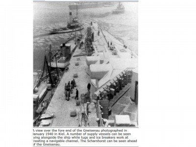

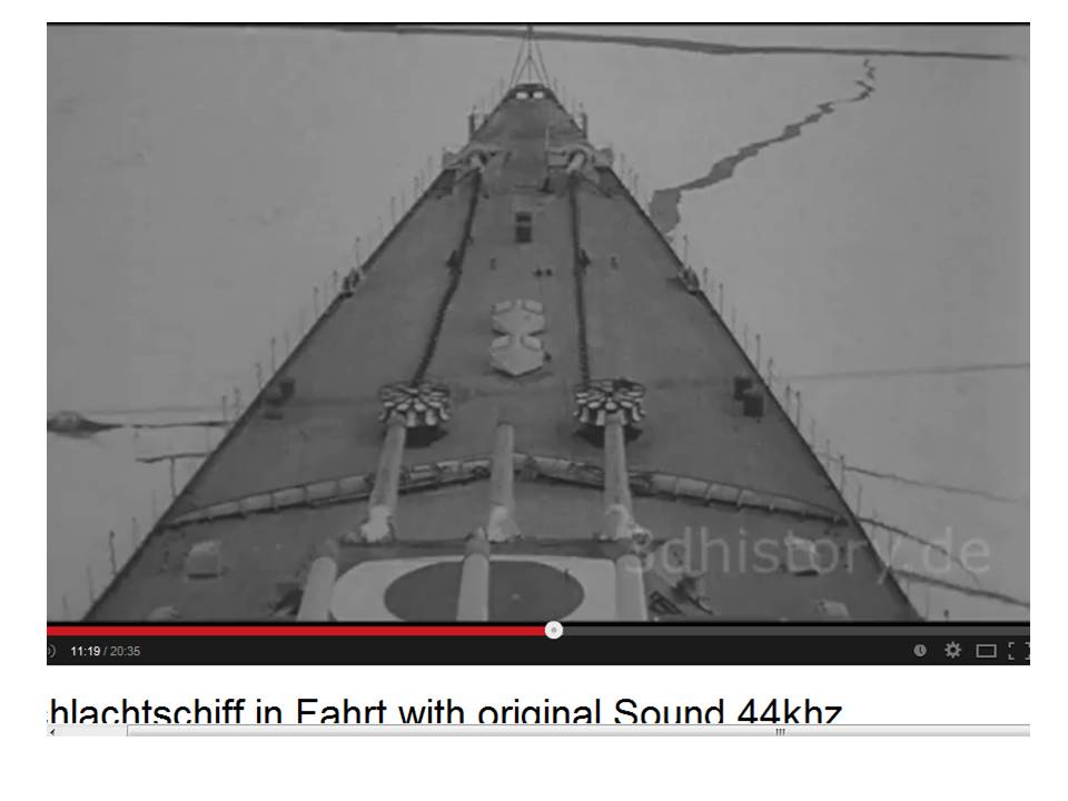

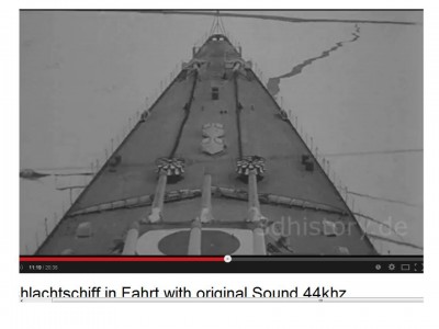

Regarding planking of Gneisenau’s bow area – I have to admit that I am quite uncertain here…
Before I “planked” my Gneisenau the way I did, and quite similar to the drawings in the Kagero book, I studied the sources I had available. That includes the book you mentioned – showing everything planked but the outermost tip.
It seems clear to me from good color photos that the area was not planked before the bow was given the new clipper shape.
It is also clear from photos taken in Brest that everything was planked but the tip at that stage in at least one of the two sister ships (it is impossible to tell from what ship the film is taken).
So what happened in between? From div, film-clips it seems that the area between the anchors was not planked in early 1940. The photos below are taken (1) from Youtube, Schlachshiff in Fahrt at 11:16 min. The other (2) is from Mr Asmussens site
http://www.scharnhorst-class.dk/gneisen ... ials2.html
showing the bow area in Jan 1940.
It seems to me that the area between the anchors is not planked, but as I said – I am not sure – it’s simply my interpretation of the pictures.
So, we know that the area was planked in Brest, (at least in one of the two sisters), but if it is Gneisenau shown in the film-clips: when did it happen? Could be after the torpedo hit in 1940 and the following repair or it could be later, during the time in Brest when a lot of rebuilding and modifications were undertaken. Or could it be that it never ever was planked in Gneisenau? Remember- Scharnhorst 's bow was made with a provision for a bow anchor and had double planking all the way up to the tip of the bow. Gneisenau never had any bow anchor and in such respect did not have a need for planking/double planking to protect the plating from wear and tear from anchor chains.
If you have pictures proving me wrong, I’ll be pleased to change my opinion! :smallsmile:

I think the area in front of the anchors was not planked during the Norwegian campaign due to this image
http://www.history.navy.mil/photos/imag ... h83982.jpg
This is of course Gneisenau, not Scharnhorst. The anchor chains and achors are absent, which makes me think this was taken around the time of Gneisenau's return from Norway following the torpedo hit.
Forward of the anchor cluse, there are transverse bands. These are also visible in pre-war (but post bow refit film footage) of Gneisenau which shows this area unplanked. So it would appear to me that this area remained unchanged.
