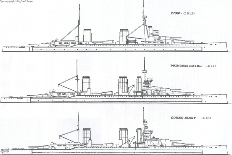

i found this on a polish magazine
ciao peppe

Many thanks ,Peppe,it all helps!!
Bye Phil

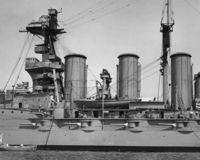

The attached photos are dated 1928 but show what I believe to be a caged aerial. On my plans there is a "guard WT" in about this location
File comment: Abreast No1 funnel just ahead of the davit
File comment: It can be seen outboard from the 50ft launch with the aerial feed attached to the top.
PostPosted: Mon May 13, 2013 11:07 pm
Joined: Mon May 13, 2013 8:40 pm
Posts: 30
Location: New Zealand
Wikipedia has the following definition
A Cage aerial is a radio antenna, which consists of the top portion of a tower or mast and of several parallel wires, which are radially arranged around the lower part of the mast. one advantage of the cage aerial is that the supporting tower can be grounded, allowing it to be used for other radio services, such as a support for VHF or UHF antennas.
I stand corrected, but the arrangements of aerials on the ship make me believe that this is the case, especially as WT was in its infancy during WW1 and radios frequencies were relatively low . The guard would have been necessary as RF voltages at deck level would have been extremely dangerous.
PostPosted: Mon May 13, 2013 11:16 pm
Posts: 12330
Your first photo does show cage aerials:
