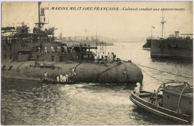

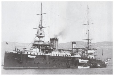

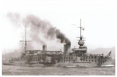

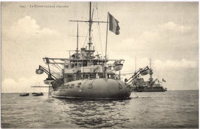

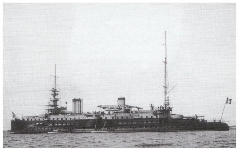

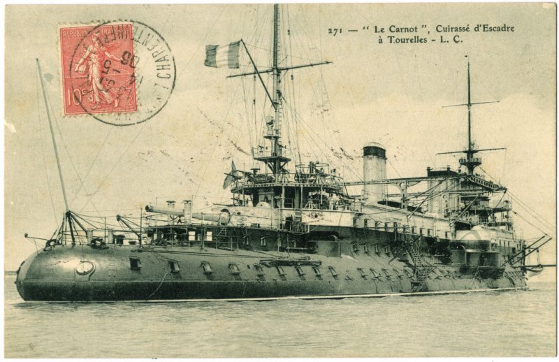

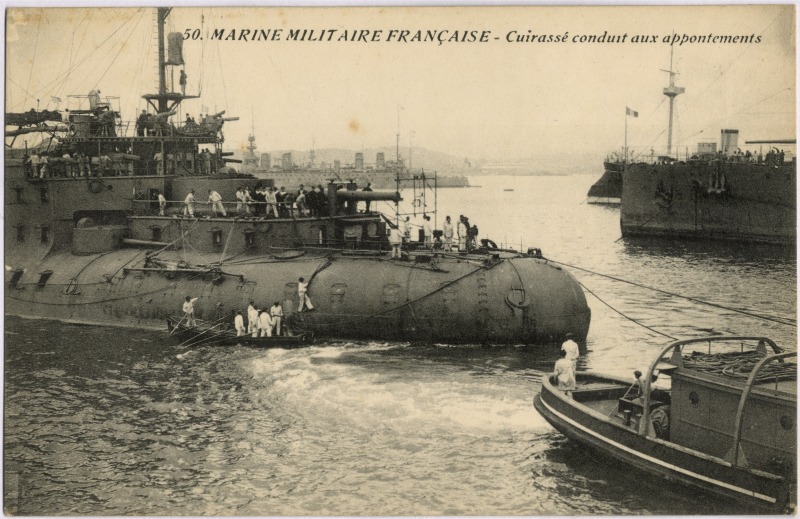

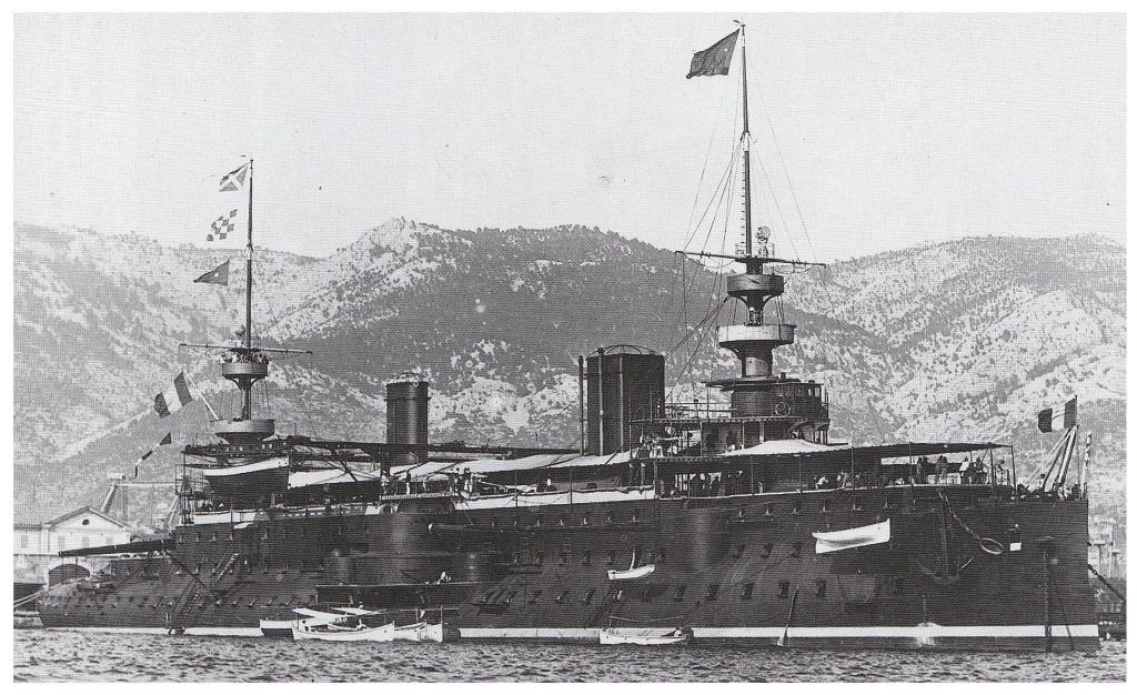

For Jim & Yevgeniy, Carnot in 3 different colour schemes......
File comment: Carnot (ii); © unknown.
File comment: Carnot (iv); © unknown.
File comment: Carnot (v); © unknown.
Cuirassé CARNOT; one of a ‘class’ of five related ships of differing design and appearance, Charles Martel, Carnot, Masséna, Jauréguiberry and Bouvet. Originally to be named Lazare Carnot for the Revolutionary Leader, her name was shortened to commemorate Lazare Carnot’s grandson Marie-François Sadi Carnot, President of the Republic who was assassinated on 25th June 1894. The Carnot was nicknamed ‘the Grand Hotel’ because of her unusual high-freeboard hull.
Builder - Arsenal de Toulon.
Programme – 1890. Designer – L’Ingénieur Saglio.
Laid down – 8th August 1891.
Launched – 12th July 1894.
Service – 25th June 1897 to 1st April 1914.
Length 121.5 metres - Breadth 21.7 metres. Displacement 12,273 tons.
Armament 2 x 305mm (centreline), 2 x 274mm (beam), 8 x 138.6mm, 8 x 100 mm, 16 x 47mm, 4 x 450mm TT.

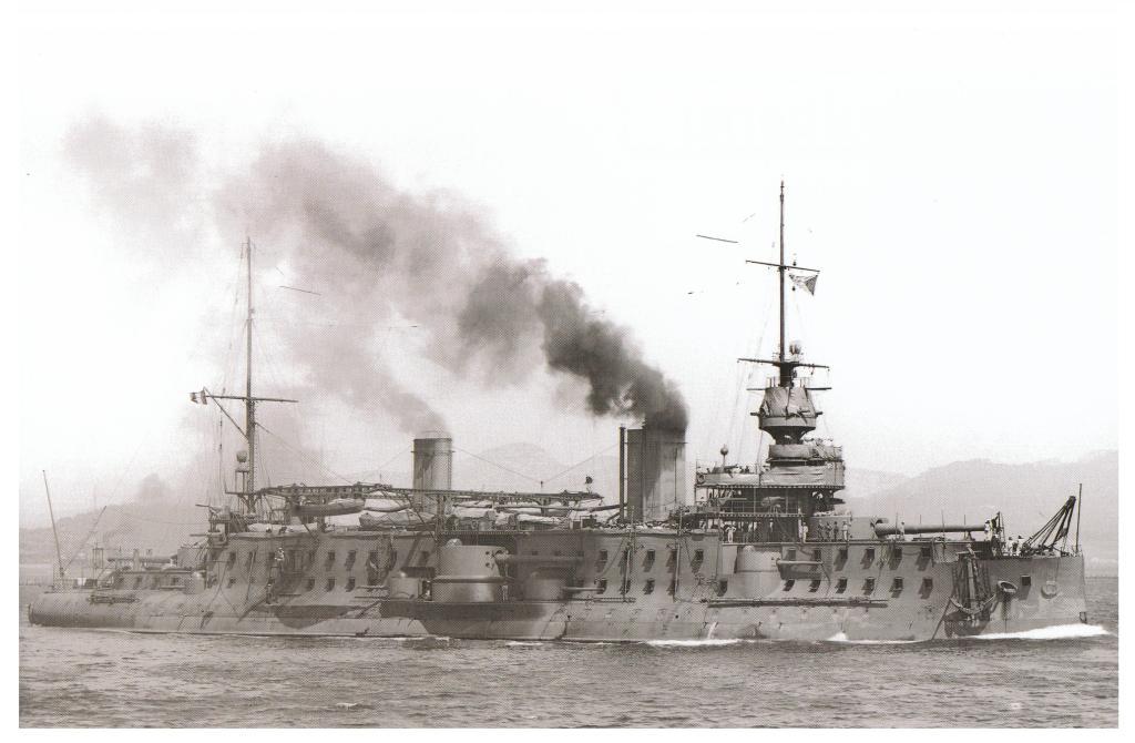

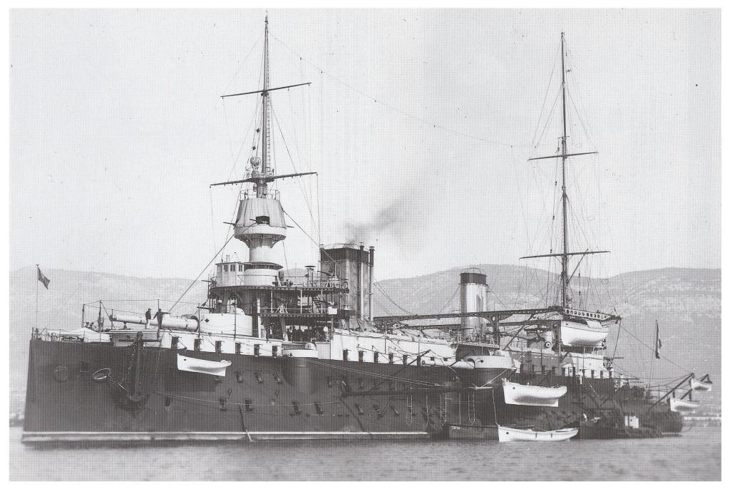

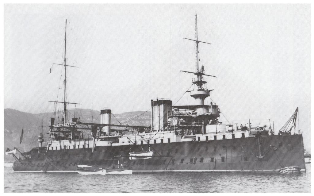

Dear Yevgeniy, that first picture of yours is excellent; such detail, such a strange design. I've oftern wondered about this type of ships; they must have been so difficult to construct with all that compund-curvature armour. Perhaps that's why they took so long to build......
File comment: Carnot (iii); © unknown.

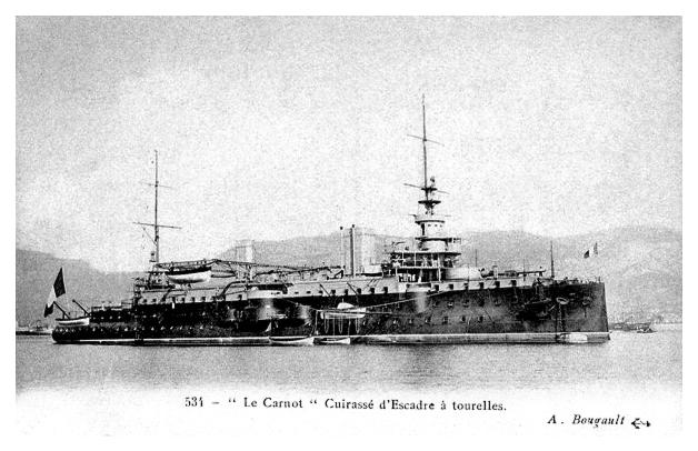

Dear cerberusjf, thank you for these fascinating drawings. I'm sure a Carnot modeller will find them very useful......

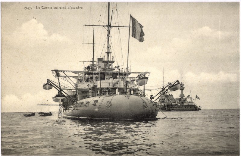

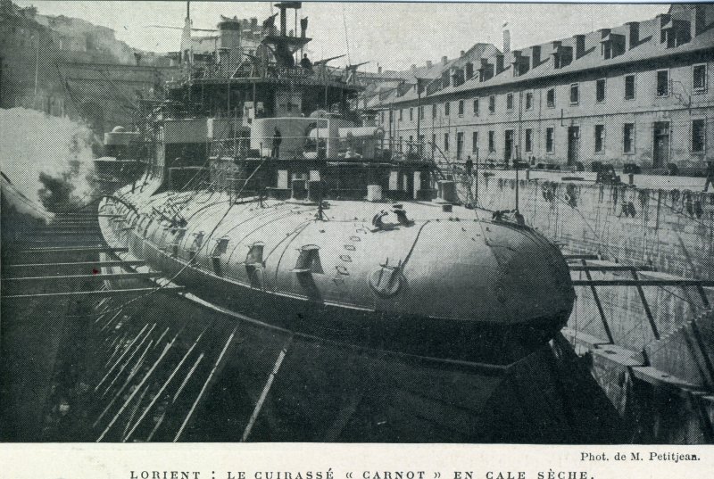

Carnot had the most delightful derrière!

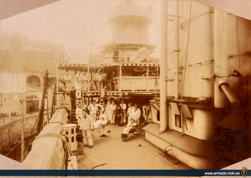

After some wondering --I can confirm that Carnot DID have a wooden main deck- there was a question mark on this--as some of her contemporary vessels had steel decks...

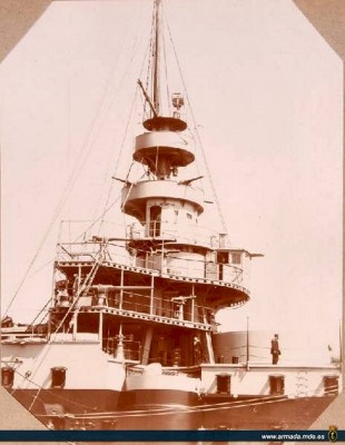

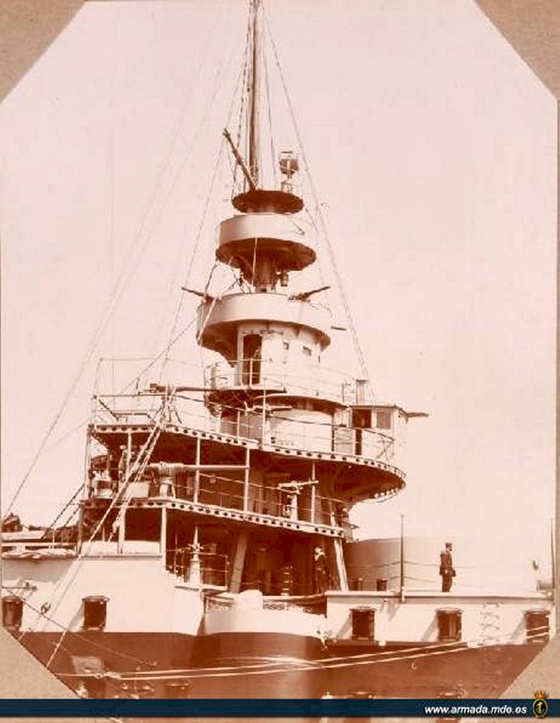

An unusual shot UP the bridge
(Images from the Madrid naval museum on-line collection)

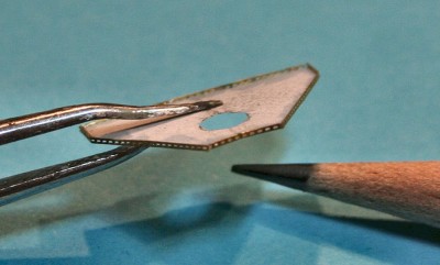

The open hatches presenet a bit of an issue when one wants to use the kit as a springboard starting point; If starting entirely from scratch-in this instance definitley NOT the quicker option- one could build the hull in layers with each hatch as an open box section onto a central spine... could look excellent-but needs to be perefct-otherwise it will look nothing short of awful!!... -- ergo I decided to cheat!
Having sanded and faired the hull
I decided to use small squares of decal sheet applied to represent the black 'voids'- the hatch lids top and bottom will be made of paper--similar to what I did on my Massena build--
http://www.modelwarships.com/reviews/sh ... eview.html
only this time I think it will be sharper- I hope
I shall post a pic or three soon of my latest progress shortly!!

Excellent pictures Jim, thank you. Carnot's stern must have been difficult to design and construct with all those compound curves......

Your trick for representing openings is great! I would not dare to do otherwise in 1:700 and probably in 1:350 either.

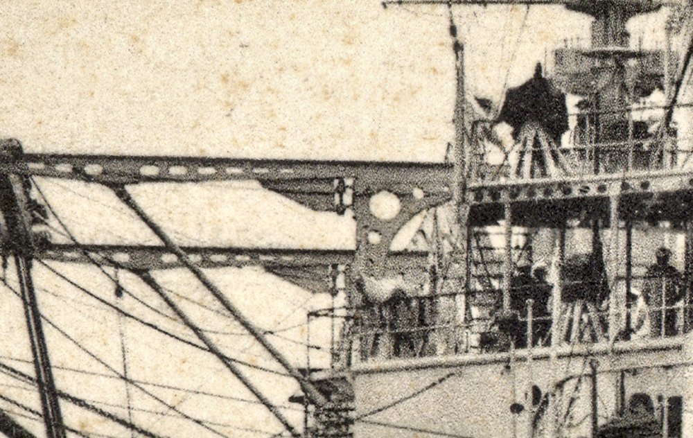

PostPosted: Tue Dec 08, 2009 7:29 pm
Hi,
I think I’ve come up with another idea for this boat-handling frame by the aft funnel. I think the “horns” were hinged! I have lined this area in red. I believe the hinges are at “a” and “b”.
Looking at them, I thought they must be hinges. But I never saw “Carnot” or any ship with them folded to the side of the ship.
Then I noticed the photos of “Marceau”. I found one with them folded, one with them spread out, or protruding over the side.
I thought it was proof for “Marceau”, but not for “Carnot”.
Then I noticed that a photo had them protruding on the side facing the camera, but seemed to be folded on the other side.
What are everyone’s opinion about this idea please? This is the first time I have looked at this, so I am in completely new territory for me.

Makes sense for me John. Those end frames extend quite a way from ship sides and,if it was permanent structure, would have been extremly vulnerable to damage. Even out of the ordinary sway (side to side motion) could have deformed them and rendered whole arrangement useless.

Thanks Darius, I’m glad someone else thinks it makes sense. I think it must have looked quite spectacular in operation, almost like something out of science-fiction. There are pictures of her on the move with the “extensions” deployed, so I am not sure when they were retracted. It certainly gives plenty of modelling options, if they are wanted.

Well John, think about folding bridge wings on German warships. Most photos show those wings unfolded but designers must have thought that, under certain conditions, folding them would be advantageous.
Besides, as you have pointed out, if those aren't hinges:
I would like to hear explanation as to what they are......

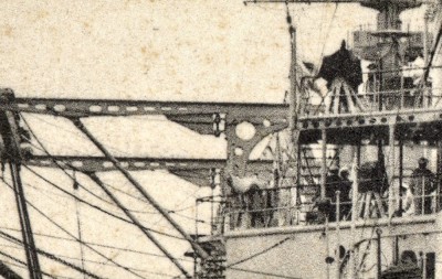

Thank you gents for your insight(s)
certainly they appear on closer examination to be hinged-though in virtually all my pics of the ship they are deployed outboard--with the exception of the photo that John has posted! :big_grin:
Here is another view of that hinge...
Wouldn`t it be great to have PE kits available for the French Predreadnought era ships.....

Doing my level best to figure out Carnots fwd bridge from photos--
not having any concrete plans to follow slavishly ... :big_grin: I am drawing my own plans from various angles of photos--I am no expert at this but it is starting to look like the real thing --in a 1/700 kind of way!
below is the first bridge level-- the distinctive pierced sides are thin PE strips- cut from a much larger PE structire gleaned from a L'arsenal 1/350 PE set....
The deck itself is made of paper - cut folded in half to give perfect symmetry, then pressed flat and infused with CA.
This gives a 'scale' thin deck....
Its a very fiddly pastime as each brass section is seperate...
