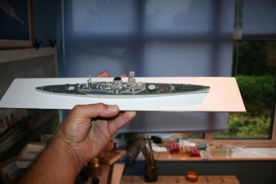

While trying my new camera I took those two pictures of the new HMS Courageous model. It's not much of a preview but it shows a lot of the details on the hull and funnel. I'll take some more pictures soon. Enjoy!

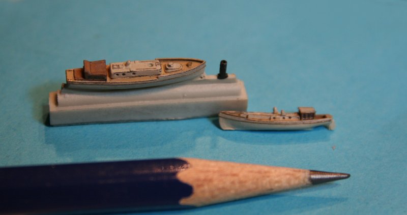

Yep--progress is being made-- its the boats that are taking their merry old time!

Your boats are coming along nicely. I see you cut oar placements in the 42' launch. Are you doing a dio with it in the water and sailors rowing?

On the whole a pretty straightforward build--I will outline the bits I have altered in the build article here at MW.com when the model is finally completed.
That said-most of the stuff I have done is because I have decided to portray her late 1918-and there are a few differences -at that time there was an additional searchlight platform on the mainmast underneath the starfish, and the platforms on the aft tripod had a structure added- which I have added , the splintermatting and dodgers etc etc etc
- apropos starfish-- I made a new one...
I tried to hollow out the resin undersides to give an impression of the metal plates--and it looked ok--but then.... well
Paper and brass slivers just looked sharper!!
I have opened up the spotting top with metal frame windows, added bits here and added bits there, thinned stuff down and chopped other stuff away...
That said --it is overall and EXCELLENT starting point--- and is a credit to Pavel.

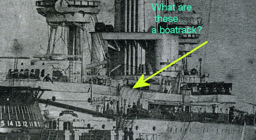

Doe anyone know what these are--or what hey do--or have better pics...?
see below
