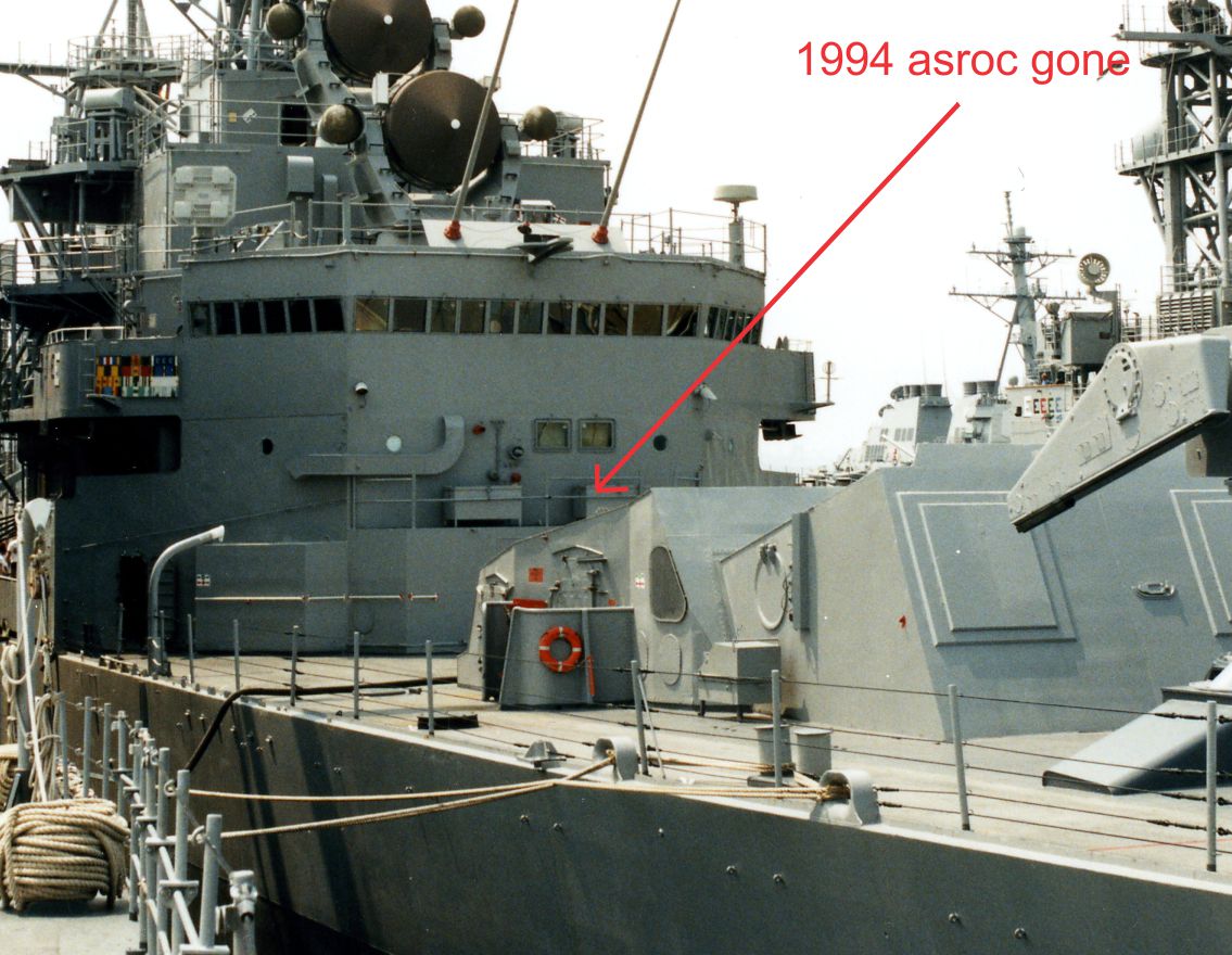

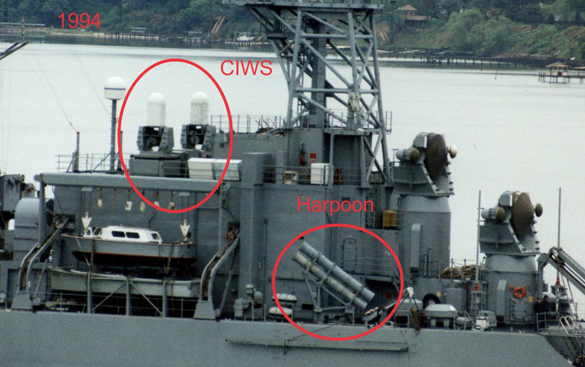

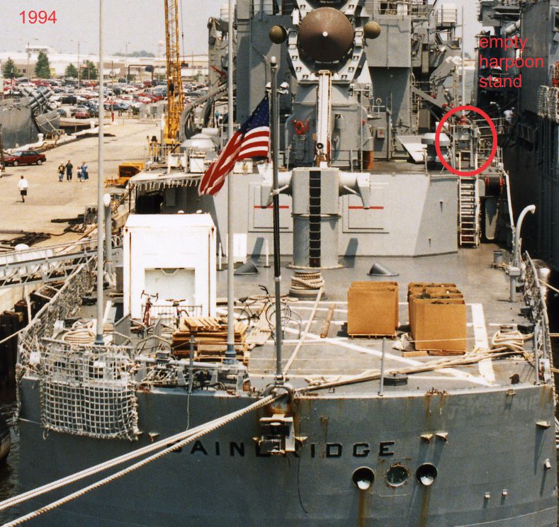

Bainbridge had quad Harpoon launchers installed where the 3"50's were, on each side, near the aft SPG-55 Fire Control directors.
2 20mm CIWS were also added on raised platforms mid ships either side.
The ASROC Launcher was removed in the early 90's and nothing was installed in it's place.
Tomahawk Armoured Box launchers were never installed on Bainbridge.
Long Beach had Tomahawk Armoured Box launchers installed where the Aft Talos launcher was and can be seen in this photo.
Darren (Admiral Hawk)
