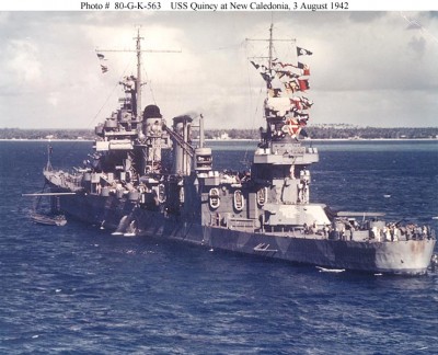

A question about USS Quincy:
In this well-known photo of USS Quincy, it seems that the fantail of Quincy was a rounded shape (though I understand it might be that perspective and lighting makes it look this way), whereas most if not all the other ships in the class had a pointed or "pinched" fantail, at least on the lower part of the fantail closer to the waterline (see the photo of Minneapolis' fantail below). Does anyone know if Quincy's fantail was different than that of the other ships in the class? Please advise.
Thanks!

PostPosted: Sun Sep 08, 2024 5:36 pm
Posts: 1974
The hull form of the class, below the waterline, was not significantly different from earlier US heavy cruisers. However, the New Orleans class, above the waterline, morphed the stern into a rounded quarterdeck level. All 7 ships of the class had the same hull form aft. Rick Davis has an aerial shot of Quincy and Vincennes at Norfolk that shows this stern shape on Quincy quite clearly.
