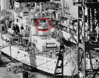

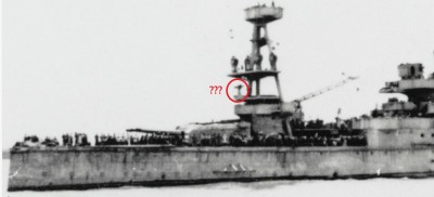

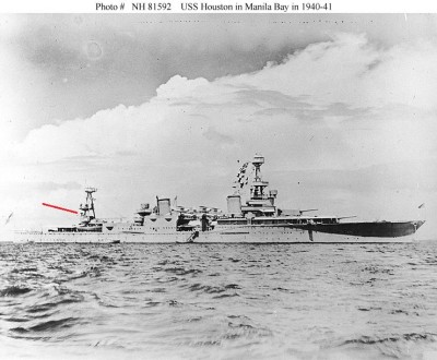

Hello,
A question came to mind when I re-examined one of the fine images of CA-30 taken at Darwin NAT in WW2. (#10070/933831)
It shows what appears to be some kind of small spotting glass or scope mounted atop the aft searchlight control station (& earlier torpedo control, before the TTs were removed). I remembered that I have another pic of CA-30 in Manila Bay, ca. 1941, which shows the thing more clearly, with a sailor nearby.
I simply don't know what it was. Something for the searchlights? Or, navigational?
I believe it is shown in the Floating Drydock plans, but there was no info on it...
Anyone know? Or, familiar with such? seen on another US cruiser?
TIA

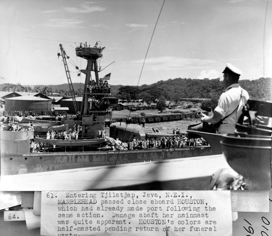

Hello, perhaps it may be an aux director, but why would it not appear on pre-WW2 photos?
Interestingly, it can´t be seen on this final CA-30 photo - either obscured by sailors or not there.
19420206 USS Houston at Tjilatjap with disabled turret seen from USS Marblehead NH 82480.jpg
19420206 USS Houston at Tjilatjap with disabled turret seen from USS Marblehead NH 82480.jpg [ 330.63 KiB | Viewed 1199 times ]

Hello,
Thanks for the reply. Navigational is a good guess, I think. I believe it could be obscured by all the guys standing there in that Tjilatjap photo (some of whom I must have known).
It's in several prewar photos, in fact.
And I definitely have another very clear image of it in place prewar...Probably spring or summer of '41 while the cruiser was exercising in Manila Bay.
Appears in her Mare Island shots in fall '40 when undergoing her final major refit. (See snip)
The aft director's scope at secondary conn was notoriously sketchy, so the more I think about it, I do wonder if it was related to that...although navigational might make more sense.
But that siting out in the open is awfully precarious & no anecdotal references about exist from survivors AFAIK.
Also, it would be unlikely it escaped some damage from the Feb. 4th bombing, which wrecked much of the Main Radio position which is two levels below it...

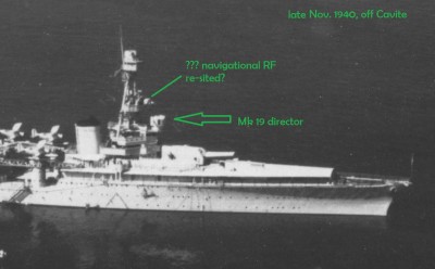

Makes me wonder if the navy--always thrifty, of course--recycled the original navigational RF on the foremast, and re-sited it aft...after it had been emplaced above the original position briefly.
Only appears there above in late '40 pix, after the MK19 on the foremast (Sky Forward) had been installed.
By early '41 (or so) it is gone from the foremast...and that open scope aft appears...
See pix.

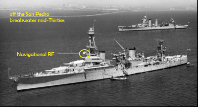

Recently was able to access the finest CA-30 Scrapbook/photo album that I know of, and found many late photos of the ship, with that little aft RF showing. The scrapbook--which I had not been able to view in person since the mid-Nineties--came back to the States sometime after 12 October 1941, which surprised me. (Sadly, had no good phone or camera with me, so only got crude snaps.)
How exactly it got back just before the war started, I do not know, but it is still in superb condition.
