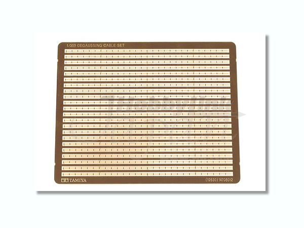

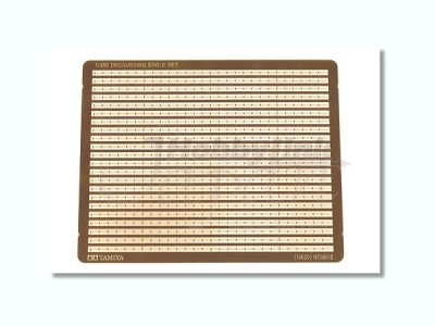

Did the Tone have degaussing cables?
Atma
Posts: 3134
Location: Oslo, Norway
Re: Calling all IJN Tone-class fans
Post by Atma »
Yes, both IJN Tone and IJN Chikuma.
chuck
Posts: 3384
Post by chuck »
Tamiya appears to have neglected the degaussing cables.
Posts: 9052
Post by Dan K »
They probably want you to buy their aftermarket version.
