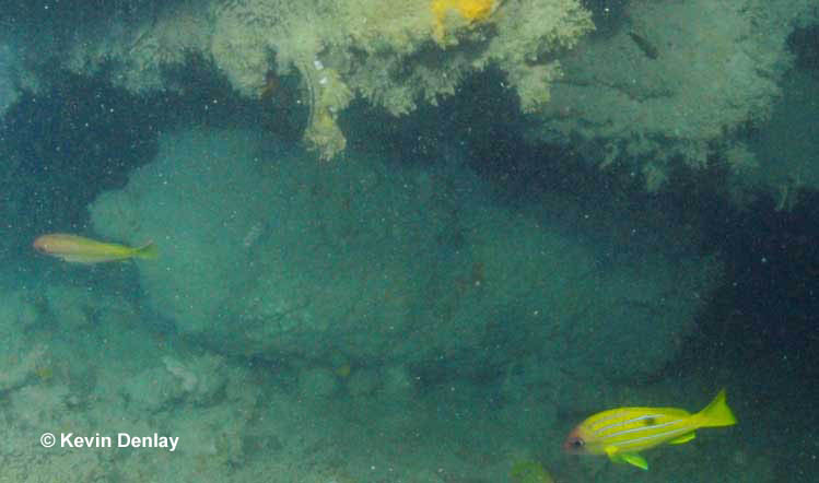

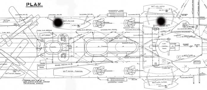

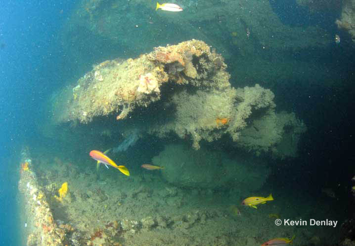

Now the reason I am trying to discern what Mk torps Exeter carried is that an ‘object’ we discovered under the port tubes on Exeter ‘may’ be a warhead, as a recent closer inspection and measurements seems to possibly point to. (See pic of object below). Including the coral encrustation the width of this ‘object’ is 550mm (or just over 21”) the length is 1500mm, while the ‘knob’ on the front is approx 120mm and the end that can’t be seen is convex.
And yes I know she supposedly fired off a salvo from the port tubes just prior to her fatal hit but……………… did they all fire? Unfortunately the diver that was recently there did not look inside the tubes to see if one still had part of a torp in there. (Loading 'Hatches' at the aft end of tubes are closed on all three.)

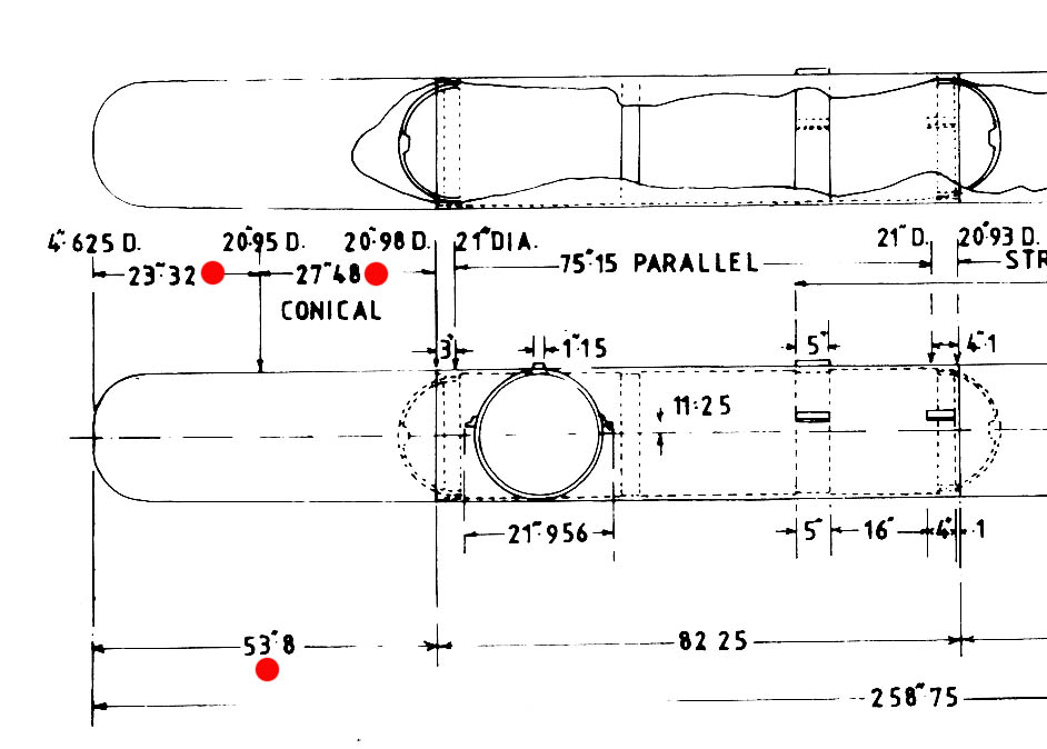

However, I have no schematic of a MkVII so don’t have measurements of the warhead, nor have I seen a photo of one. Do they have that knob like protrusion on the nose like this?
The only schematic I have is of a MkVIII but am unsure of the correct warhead dimensions for it as there seems to be an error in the schematic. (Am not implying it is a MKVIII or she carried same, just trying to ascertain some ballpark measurements) Note the figures below marked with a red dot; when the top two are added together they do not match the bottom one although they seemingly cover the same distance. So I wonder which is the correct measurement, the top or bottom figures?
Be that as it may, it would be interesting (for us) to positively ID this object.
Regards, Kevin
I have looked at my copy of J.Campbell "Naval weapons of WW2". It's difficult to say if the bottom measurement is a typo.
I don't know about Mk VII but clearly, according to John Lambert's drawing, there is no protrusion on Mk VIII. On the other hand, if you go to page 87, you will notice a similar protrusion on the 18" Mk XV, XVII drawing. Therefore, it seems possible to have it on a Mk VII.
Maybe, John Lambert would have the answer to your question, the cherry on the cake being a Mk VII drawing with correct measurements :heh:

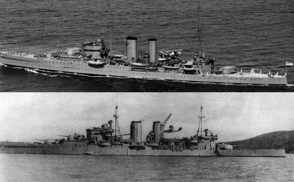

Exeter had most of the amidships and after superstructure and hull section rebuilt, with the new four twin 4" mounts much further aft around the two funnels.
The twins were actually just spaced further apart, as opposed to being moved ‘much’ further aft. The black dots on the 'as fitted' plan below show approximately where the dual 4” were placed aft her refit, with one a touch further aft and the other a touch further forward than the previous singles. Torp tubes were also moved slightly further forward. (See historical images below.)
Gernot wrote:
[The masts were also changed to tripod fore mast, not sure about main mast.
Main mast was also tripod.
Gernot wrote:

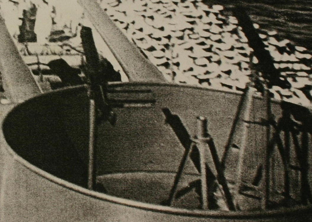

[After that I assume some kind of surface radar, plus 0.5" Vickers and I think two 20mm Oerlickons..
Quad 0.5 Vickers are abreast the forward superstructure (but weren’t they already there pre refit?), while the single 20mm’s were placed on top of B and Y 8” turrets.

Although tubs/bins were fitted on B and Y turrets in anticipation of 20mm during her Devonport rebuild 1940-1941, Oerlikons were not fitted then. Other MGs (Vickers?) were put there. This is the top of Y turret.
