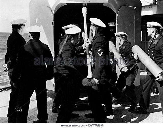

I am new to this forum, reading this thread actually made me join. I have started (i.e., just bought...) a Trumpeter 1/350 Graf Spee, currently gathering information. The topic about the doors (or not) of the 15cm SK C/28 discussed previously catched my attention, as the doors are provided in the excellent Eduard PE set, and wanted to be sure that they were used. Evidently they were in the Graf Spee in Dec 1939, but I found several other pictures of other Deutschland class battleships that had no doors, but a curtain rolled up, or nothing at all. Interesting topic, my 2 cents. Attached pictures showing the three types, one from the Graf Spee (doors), the other from the Admiral Sheer (with curtain, no doors) and the last one from Admiral Scheer (can't distinguish doors nor curtain, but might be wrong) (as this is the first post and first try uploading a picture, forgive me if something goes wrong)
Marco
File comment: 15cm SK C/28
File comment: Admiral Scheer 15cm
File comment: Admiral Scheer 15cm plain
