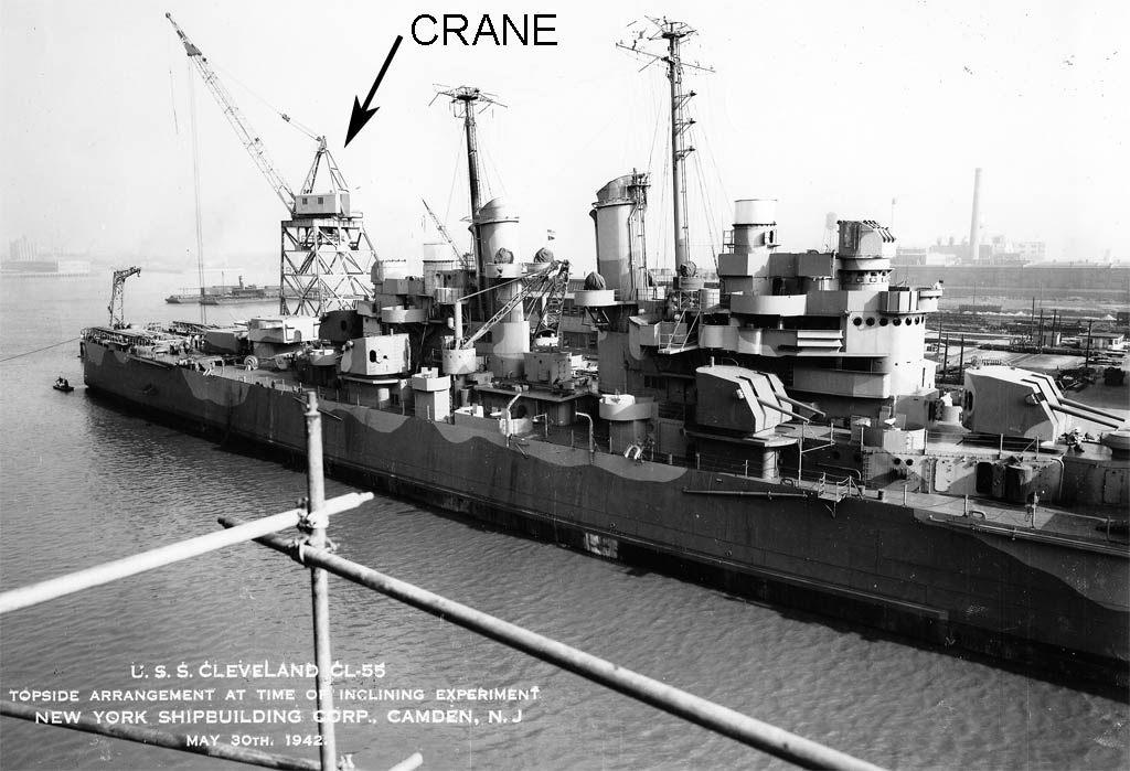

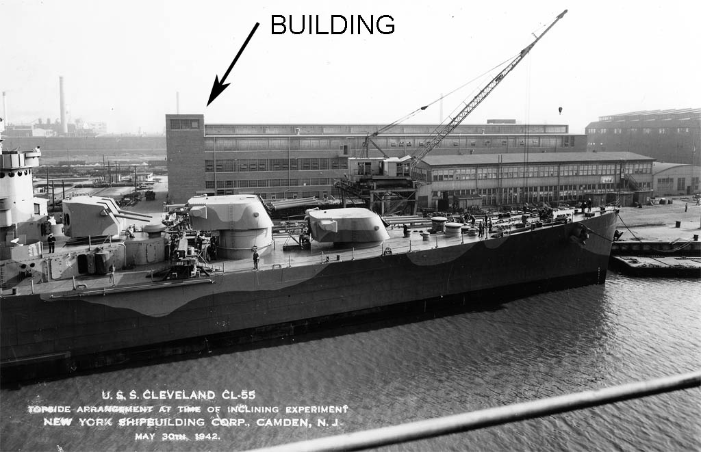

Rick,
You are right. They were taken at New York Shipbuilding in Camden, NJ. Look at the two inclining experiment photos (attached) dated 30 May 1942.
In the first is that unique crane with the four-level angled base. It is in the other photos. The second photo shows the long building with the smaller roof-top cabin that is in the photo you posted.
The inclining experiment photos were taken at the place along the quay parallel to the long building where the other ship was located in the pictures posted earlier. Then the Cleveland was moved around the corner for the second series of photos.
I don't have any inclining experiment photos of the Columbia to see if it was the "other" ship. They would have the Cleveland in the background.
Those 5"/38 mounts and shields could have been "surplus" from the CVL conversions. The Independence CVL-22 (ex Amsterdam), Princeton CVL-23 (ex Tallahassee), Belleau Wood CVL-24 (ex New Haven), Cowpens CVL-25 (ex Huntington), Monterrey CVL-36 (ex Dayton), Langley CVL-27 (ex Crown Point, ex Fargo), and Cabot CVL-28 (ex Wilmington) were all under construction at NYSB in Camden at the time the Cleveland photos were made. The Independence and Princeton were pretty far along at the time of the Cleveland photos - they are probably the two CVLs visible in the background of the photo you posted. Twelve shields equals two converted CLs.
PostPosted: Tue Feb 09, 2016 5:52 pm
Posts: 1975
The CVL's in the above photo labeled "NYSC_01.JPG" are Saipan and Wright. That would put that photo later than Aug '45.
