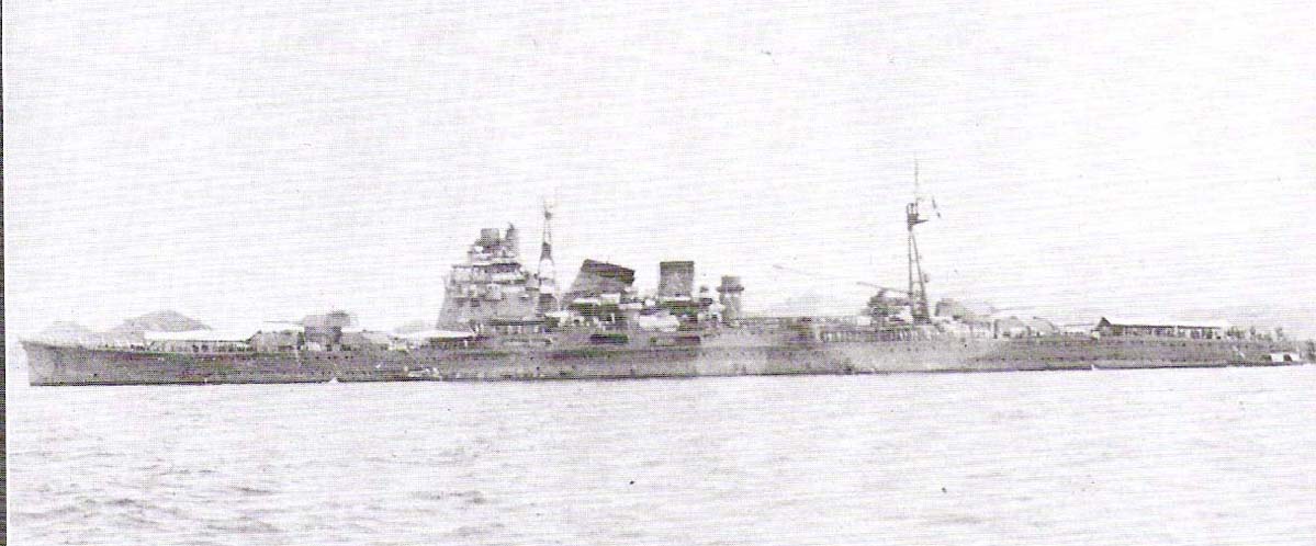

Back to the point about closed off openings ahead of Atago's catapults: Some studies by Toshifumi Kimoto posted at his Vanguard website prior to his Takao 1941 build, display photos of Atago as such. http://homepage2.nifty.com/vanguard/intro/main5.htm
The top photo below is of Atago 1942 from his website; though I am not certain which photograph the crop is from. The second photo of Atago late 1941 is also shown on his website; this version is from Maru Special #124. The photo is sometimes mistakenly reffered to as Takao. The seemingly camo paint job was caused by water marks on the original negative.
It has ocurred to me that the openings could have been closed off by canvas coverings for whatever reason. The appearance is pretty flush, though. There isn't a good late war photo of Atago that I know of to confirm this appearance.

This is a good view of Atago's #2 viewfinder apertures. I don't see Takao's as any different at the end of the war

Just a profile view of a 1942 or 1944 (if any available) with a 1945 IJN Takao in Singapore, you will see the difference in the number 2# rangefinder.
Same with IJN Myoko and IJN Aoba.
Edit:Check page 13 in this thread of IJN Takao in Singapore, your pictures confim that Dan. Check the rangefinder number 2# turret.

Posts: 8813
I agree; you are correct. Comparison of Takao 1945, with Takao/Atago 1939 and Atago 1942 indicates that the hood was likely enlarged sometime after 1942. In fact, though blurry, photos of both Chokai and Maya 1944 appear to show enlarged #2 rangefinder hoods as well. So, the change for the class happened sometime within that two year interval.
Maybe it did improve optics. Good call. Will have to check the other classes.

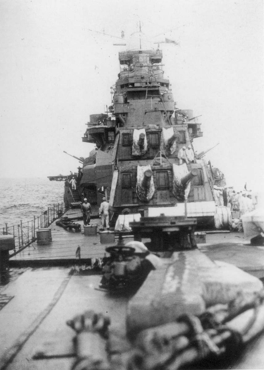

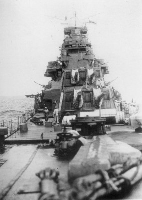

Anyway, back at the topic for the changes on turrets. Skulski in his book state also the excercise aiming device was removed sometime in 1944, besides the rangefinder overhangs of number 1# turret. I cant find a clear picture that confirms that, but his book got a mistake too.
Dan's picture of IJN Takao in Singapore harbor after 1945 show that IJN Takao had the rangefinder in number 1# turret, but without the overhangs, Skulski states in his book that the rangefinder was completely removed, wich the picture proves wrong.
Now, for the enlarged #2 turret rangefinder hoods both Fujimi and Hasegawa gives that option for the IJN Myoko class but not for the IJN Aoba and IJN Takao.Fujimi in IJN Takao kit gives only the normal rangefinder hoods for 2# turret wich ius noram if the ship is a 1944 build. Hasegawa for IJN Kinugasa wich is a 1942-1941 built, gives the enlarged #2 rangefinder hoods wich I guess is wrong, cause IJN Kinugasa was gone in late 1942, and never recieved that.
Trials pictures confirm that.Also IJN Aoba early in war got the normal size hoods.
Hasegawa also gives enlarged rangefinder hoods for 3# turret for IJN Aoba and IJN Kinugasa.Is there a picture of IJN Aoba's 3# turret in Kure harbor after the war. ?
Is there a confirmation that also IJN Takao and IJN Myoko got on her 4# turret an enlarged rangefinder hood ?
And I insist that the enlarged rangefinder hood was only present in 1945, after the ships was used as AA floating battery.

I don't have a lot of time so, this is what I have come up with:
Beam/sideview photos of Atago, Maya (Gakken #16), Chokai, Myoko (Gakken #60) in early and late 1944 clearly show enlarged rangefinder hoods for both #2 & 4 turrets. Photos of both classes as late as 1943 show no change so I believe, the change came in the 2nd round of wartime refits (as L & W refers to this period) from 12/43 - 3/44. Neither L&W nor Skulski touch on this change so, they apparently missed it. I believe that Aoba would get this as well, but only fior #2 turret. The change appears to apply only to the superimposed turrets.
OTOH, I tend to doubt that either the Mogami/Suzuya sisters or the Tones received them if only because their rangefinder hoods were already enlarged when compared to the earlier D & E type turrrets of the earlier classes. I doubt the Aganos received them either. Will address the CL thread separately, on other matters, when time allows.

As I posted in the IJN Myoko thread the pictures I got is all from 1940 till junary 1944(and there is no evidence of enlarged rangefinder hoods on those ships I mention there), and no post 1942 picture of IJN Myoko. My pjotographic reference to IJN Takao class is limited to 1945 post war photos of Takao and various '30's pictures.
But I think we can safely say that the enlarged rangefinder hoods on IJN Kinugasa was never fitted or in the IJN Aoba during 1942, so for a Hasegawa 1942 IJN Kinugasa(or an early war IJN Aoba) in 1/700 the rangefinder hoods needs to be replaced.
And according to the picture that I posted in the IJN Myoko thread of IJN Myoko number 4# turret, I guess IJN Takao also had enlarged rangefinder hoods on her 4# turret too.At least in 1945.
