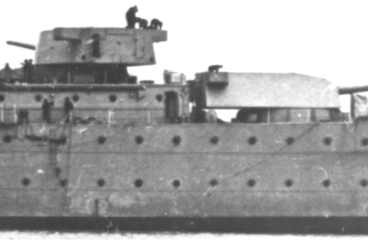

Another doubt I have, about the triangular reinforcements around the barbettes. I know that the ones molded in Trumpeter's kit are wrong, thanks to this forum, but I see there are differences in number and position of the reinforcements between the barbettes of the front turrets. The front turret seems to have 12, sort of even-spaced reinforcement, while the second turret is missing at least one lateral reinforcement, there is a box there instead, and the spacing does not seem to be even, more separated. Not trying to complicate my life, but worth checking. I haven´t been able to find any other good picture of that area. Any thoughts?
Marco

PostPosted: Sun Nov 08, 2020 3:42 am
Posts: 1813
Marco
Hi Marco, all,
Thank you for that photo, it is a great surprise for me! I hadn't seen that at all, only of the forward and rear barbettes.
What I'm now guessing from this photo: the 'B' barbette has eight supports, not in the 'cardinal' positions but in between those, and not evenly spaced. They must of course link up to some structure below the deck - which we have no information on at this moment. And you are right that it is also slightly higher than the 'A' barbette.
Any other views?
Maarten

PostPosted: Sun Nov 08, 2020 4:37 am
Posts: 470
Maarten Schönfeld wrote:
Any other views?
Maarten

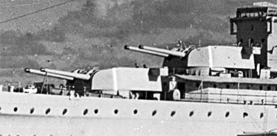

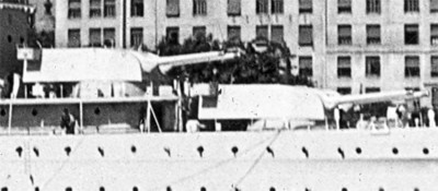

PostPosted: Sun Nov 08, 2020 5:07 am
Posts: 470
A couple more.
PostPosted: Sun Nov 08, 2020 5:45 am
Posts: 1813
Any other views?
Maarten
Thanks for those pictures, Kevin! They seem to confirm the previous notion. The upper one is a bit hard to read (damn the shadow) but the lower one is very clear.
Also interesting: in the second one the lower row of scuttles is largely reduced, and some are even relocated.

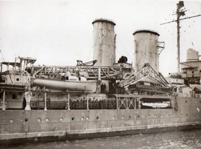

Greetings everyone. Not to add another tangent, but does anyone know of a reference that might list Exeter's boats at the time of the River Plate? I am thinking of aftermarket improvements but am not good enough with RN craft to be able to recognize types from photos with any sort of fidelity.
*Edit* fixed spelling and adding:
IWEM's photo HU 104427 is of the battle-damaged Exeter arriving in Plymouth. The two boats visible on the starboard side do not match any of the craft available from Black Cat Models or Micro Master at this time. One plan has two different boats (a 35' motor pinnace aft and a 32' Life cutter forward) but the two in the linked photo appear the same. Could this be a 35' motor pinnace, and is there a good reference for RN boats in WWi and WWII?
Related but a bit different - any idea what size of rafts Exeter Carried during the battle?
PostPosted: Mon Nov 30, 2020 5:01 am
Tracy,
No disrespect but I see three boats in the linked photograph. The one below the davit forward of the fore funnel is a 32ft cutter: usually shown on the official drawings as a "32ft life cutter." One aft of that and appearing darker in colour is; if one uses the drawing of HMS YORK in Raven and Roberts' "British Cruisers of World War II," theoretically a 35ft motor boat. The one abaft it is, if one uses Raven and Roberts again, a 30ft motor pinnace. I am not an EXETER "fan," however, I do believe that some people have been carrying out deeper research on the ship. I suggest that you try and contact them via an "EXETER" website and see what they have.
There is nothing of value in Randall Tonks' "Profile" on the ship.
Regarding the ships' boats of the Royal Navy in the round: I am moderately familiar with the more well-known ones but the best source is the National Maritime Museum, though I know from experience that the record will not be complete (at least as far as I went into the matter). As far as I know, there is only one good Reference on the subject: WE May's "Ships Boats of the Royal Navy" (use that information as a "starter"), however it "stops" around the turn of the 19th/20th Century. There is no modern work that covers the subject, though one is probably needed but would it interest a publisher?
I seem to recall that there is a small amount of information on Carley rafts in one of the 1951 editions of the Manual of Seamanship, otherwise you will have to use photogramatic (sic?) interpretation. Regarding those carried by the ship at "River Plate:" I would advise caution unless someone can provide evidence but I see none in the photographs of the ship taken at, or near the time.
I fear that the above will be of little "comfort" to you but may give a couple of slim "leads."

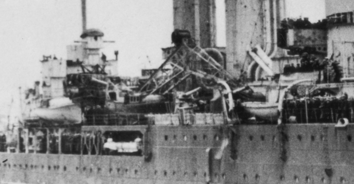

Here are several ‘close-ups’ of Exeter's boats just post the time frame in Tracy's question. As can be seen in one (#1, taken while still at sea on her way back from the Falklands) there are four along the starboard side, but upon arrival at Plymouth (#2, 3, 4) only three appear to be there. Unfortunately I have no really clear photo of the boat adjacent to the bridge superstructure to add though.

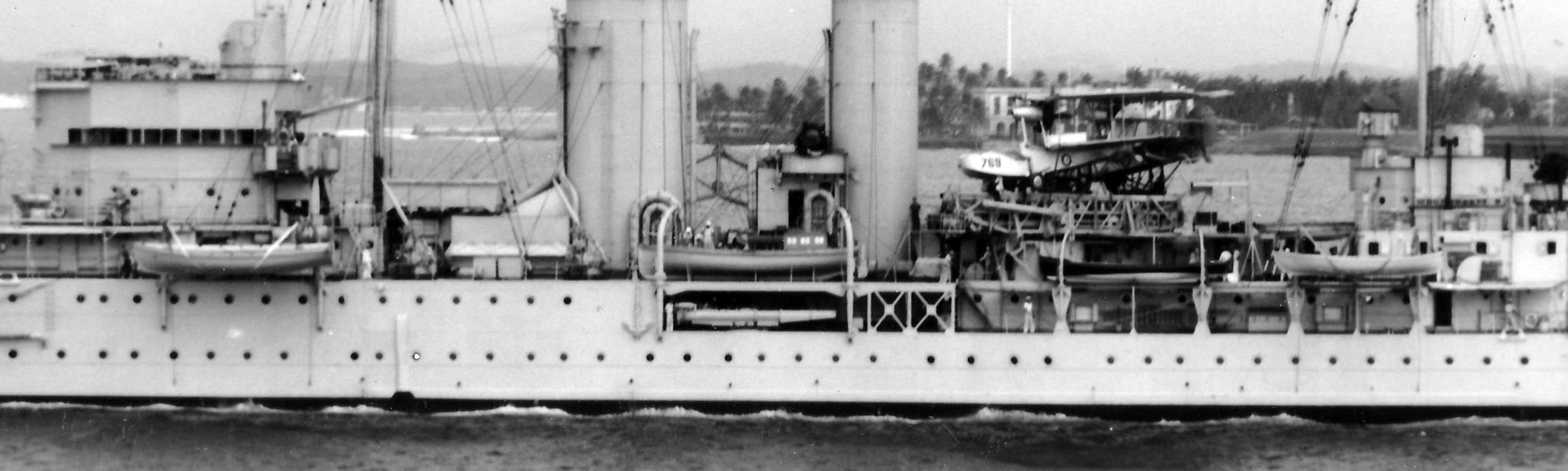

Well, here is another photo taken approximately nine months prior to the Graf Spee action. The two boats in the center certainly look somewhat different to the ones in my above post. The more forward of the two looking more like the schematic in EJ's post.
