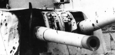

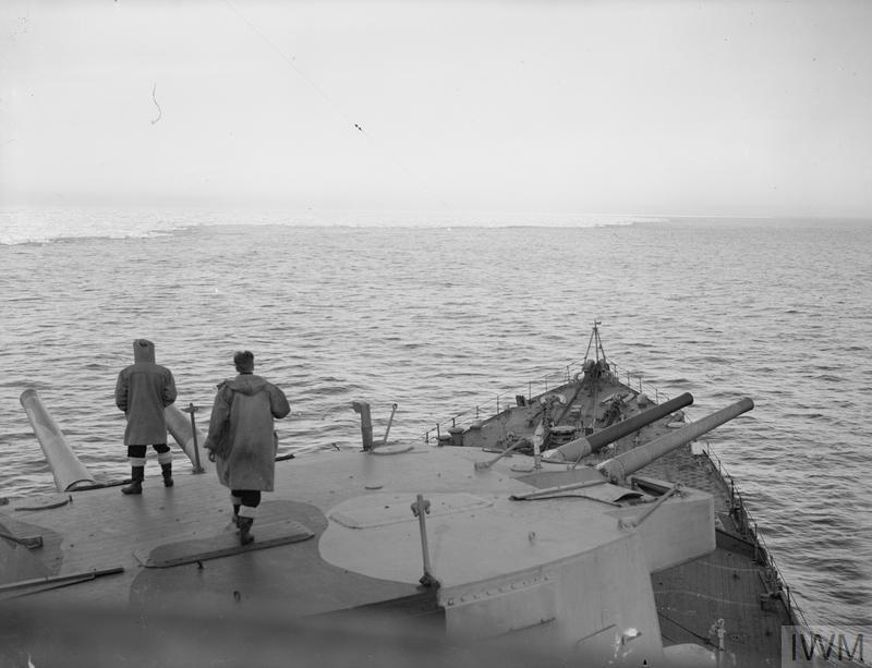

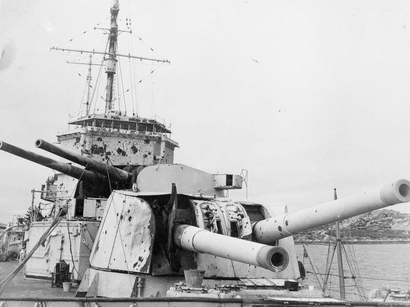

I think if you look at image of her turrets from Pt Stanley, now cropped below (note aperture behind port gun forward turret) it appear to be the squared off kind / doesn't seem to go very far back on turret 'roof' (but both these 'observations' may just be an optical illusion though). And IIRC I did 'hear' of complaints about not being able to elevate her main guns high enough pre refit.Maarten Sch�nfeld wrote:To my knowledge the Exeter and York already received the latest version (Mk II) of the 8" turret when they were delivered, these turrets were also applied in the two last County class ships, the Dorsetshire and the Norfolk............................................... A givaway for identification are the hatches above the breech blocks: in the Mk II these were oval, in the Mk I these were rectangular with rounded corners.
On the other hand Martin, I tend to agree with you that at least post refit she had the 70 degree turrets, but this page begs to differ. http://www.navweaps.com/Weapons/WNBR_8-50_mk8.php
However, if you look at the below - pulled from video and grey-scaled - of one on Exeter's forward turrets (on the wreck), then the 'up aperture' that I have outlined is oval or 'half-mooned', not square, and looks able to achieve more that 50 degrees IMO. (BTW, both guns in both of Exeter's forward turrets are down near horizontal at the loading angle.) On the other hand, her aft or Y turret's guns are at or near maximum elevation - again below from video - and when I attempt to measure said angle from other images they appear to be elevated around 65 - 70 degrees.
So I would be inclined to believe she had the 70 degree turrets, at least post refit, but like I said the page linked above appears to disagree.

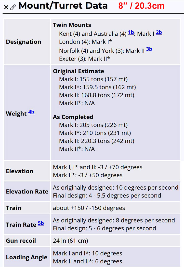

I thought it was the other way round, that is Exeter started her career with the 50 degree turret, and IIRC there were 'complaints' that they could not train high enough, and they were then replaced with 70 degree ones when the opportunity arose during the post Graf Spee refit.maxim wrote:The Mk I also had 70�. I thought that the angle of elevation was reduced in the latest versions, because the gun was not suitable for AA fire, because its movement and rate of fire was too low. At least I had written earlier, that the turret with 50� was introduced with Exeter. Reference? Friedman? Raven/Roberts?
On the page I linked to above its says;
"The later Mark II mountings appear to have been much more reliable, with the first gun trials for HMS York in February 1930 being so successful that they took only four hours to complete. As a weight saving measure, the Mark II* version of this mounting, used only on HMS Exeter, had a significantly reduced maximum elevation."
Below is a 8" turret data chart from the same page. Note the 'designation' and 'elevation' sections.

Ok, that confirms that Exeter had only 50�. The gun was not suitable for AA fire. The only reason to add an Mk II instead of a Mk II* would be that there were Mk II available at the time of the repairs.

Sorry gents gotta disagree. How do you then account for the u/w images showing the much greater and rounded, not square, gun aperture? And the measured angle of elevation of Y turret being greater than 50 degrees on the wreck?
After all, as they say in the marine forensic world, the steel doesn't lie.
As for the main guns being to clumsy against air targets, Exeter certainly used hers effectively for that task during the so-called 'Gasper Strait sortie' on 15th Feb 42, so even more evidence they were the 70 degree turrets IMO.

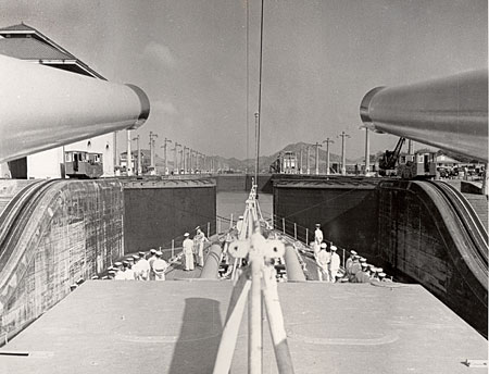

TomRigg17
- Posts: 22
- Joined: Wed Feb 19, 2020 5:22 am
Re: Calling all HMS York class (HMS Exeter-WWII) fans
You can see the squared off openings quite clearly on 'Y' turret in this photo.
https://ww2db.com/images/5922f936671dc.jpg
Tom
Tom

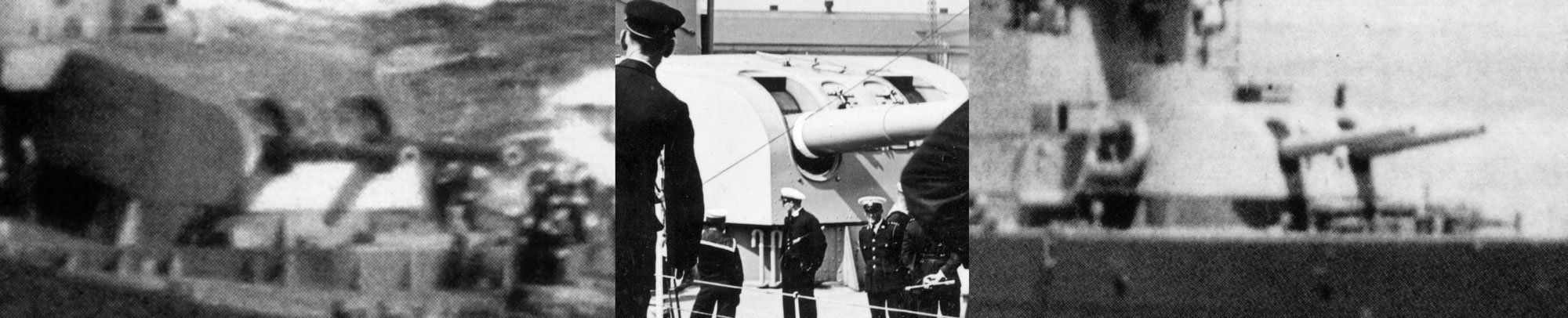

- Maarten Sch�nfeld
- Posts: 1842
Hi TomRigg, I don't know what's wrong (403 forbidden error) but I cannot open the link you sent. I really want to see what you mean!TomRigg17 wrote:You can see the squared off openings quite clearly on 'Y' turret in this photo.
Tom
When I wrote this I didn't refer to the gun barrel slots being square or not, in my view these are rounded off in all cases, regardless of the 50 or 70 degrees elevation.A givaway for identification are the hatches above the breech blocks: in the Mk II these were oval, in the Mk I these were rectangular with rounded corners.
The hatches above the breech blocks however are really different:
This is the Suffolk (Mk I), these are squared off: And this is Exeter (Mk II or II*), these are oval:

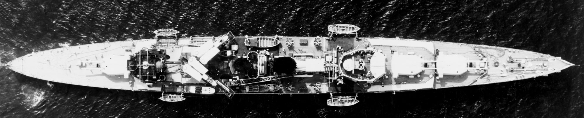

Below is a comparison of squared off and rounded apertures, seemingly? The two on right are both Exeter, center is pre refit, far right post refit.
Other is an overhead shot of Exeter May 41.

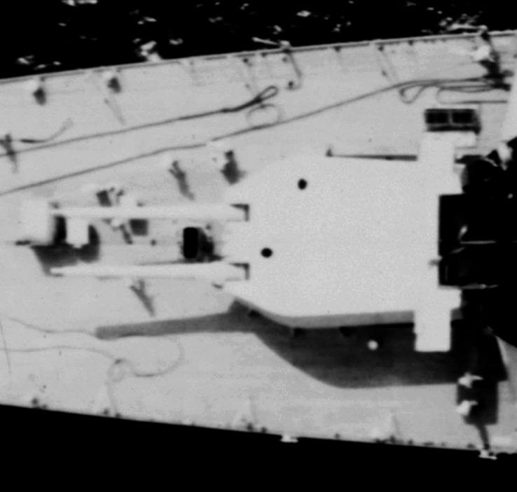

And the end of that rainbow it is this image here, but unfortunately contrast not great enough to make out apertures in fwd turrets, even in the larger size original. But with some P'shop adjustment, on the aft turret (below), they stand right out.
Anyone know what date original was taken (and where)?
TomRigg17
- Posts: 22
caption reads:
'Aerial view of HMS Exeter, Panama Canal Zone, circa 1939'
I found it on WW2db.com
Tom
