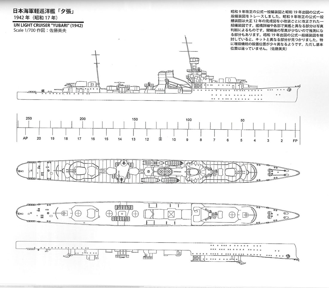

This Yubari 1-700 plan scan is from the MASMS vol. #50, which highlights the Battle of Savo Island. It looks correct to me in terms of her AA layout, and the staggered shape of her aft AA platform.

Thanks Dan!
That's really a highly valuable and rare picture.

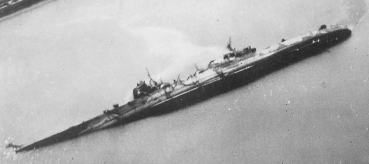

Found these pics of Oyodo's wreck. It conclusively proves she had a camouflage scheme when sunk (see the AA gun sponson). Just wish there was a drawing showing said scheme...anyone have any ideas?
PostPosted: Mon Apr 11, 2016 11:48 am
Posts: 3874
Location: Bonn
Thank you very much for the nice photos! Very interesting!

I know you've seen this image before, but this crop is from a larger version.
