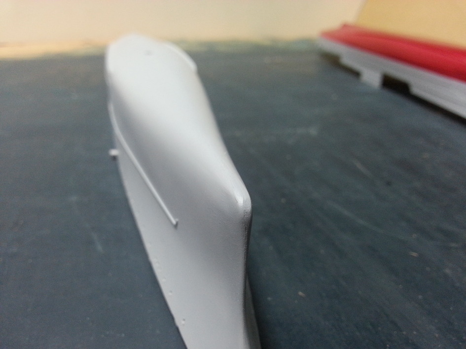

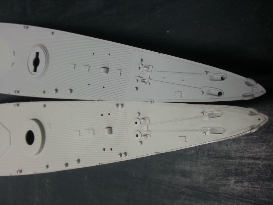

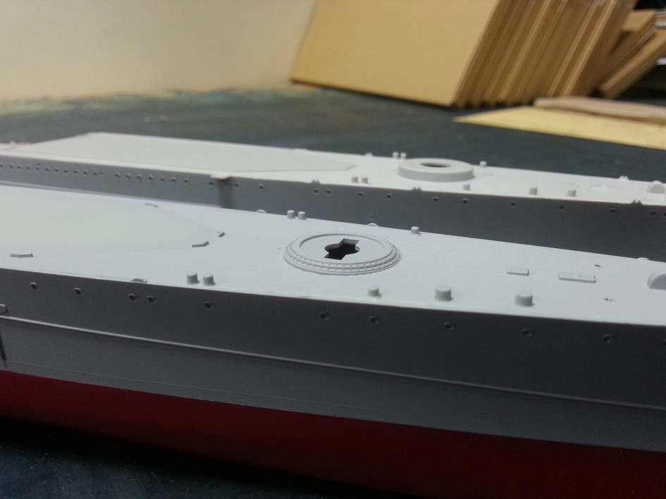

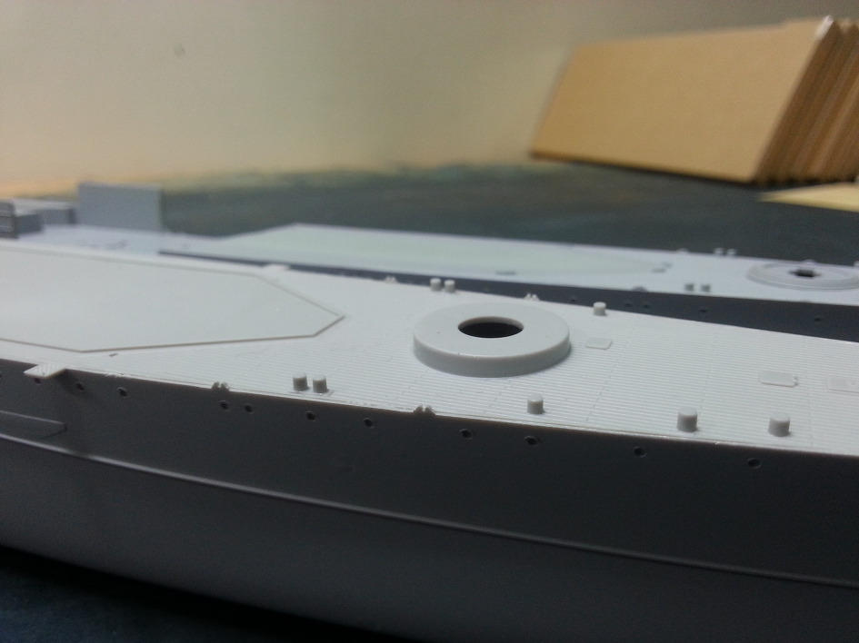

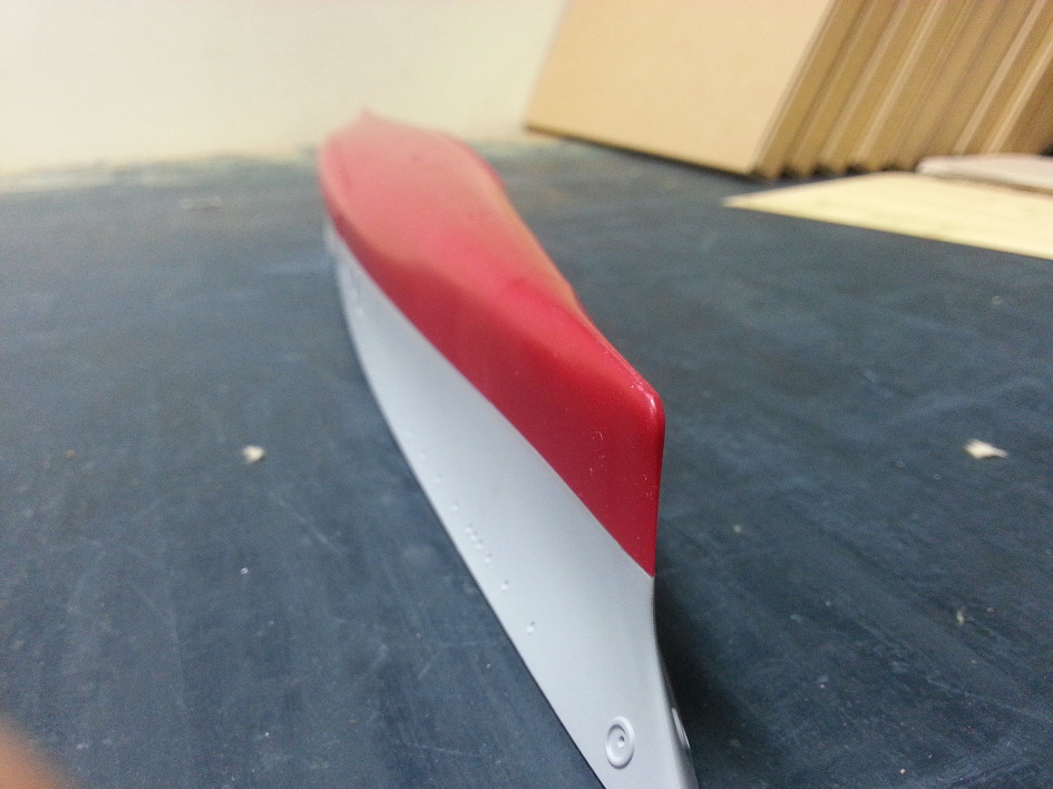

I had Academy Indi and I got a chance to look at the Trumpter Indi Hull.
So I took the pictures of both hull in one place for comparison.
Trumpeter hull is splitted left, right.
Academy hull is devided at the waterline level.

Thanks for posting. I really want an INDY in my collection,was excited when I heard about these two releases....now the excitement has diminished somewhat. I need to see the two kits complete WITHOUT modifications.

Strange, Trumpy's hull (anchor chains and shafts) look's as 30 years old kit. And base for main guns turrets with screws looking better in Academy. I bought Academy kit. In Czech republic is a 10USD cheapest as Trumpeter and have waterline option.

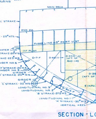

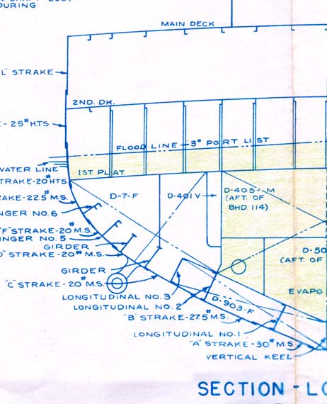

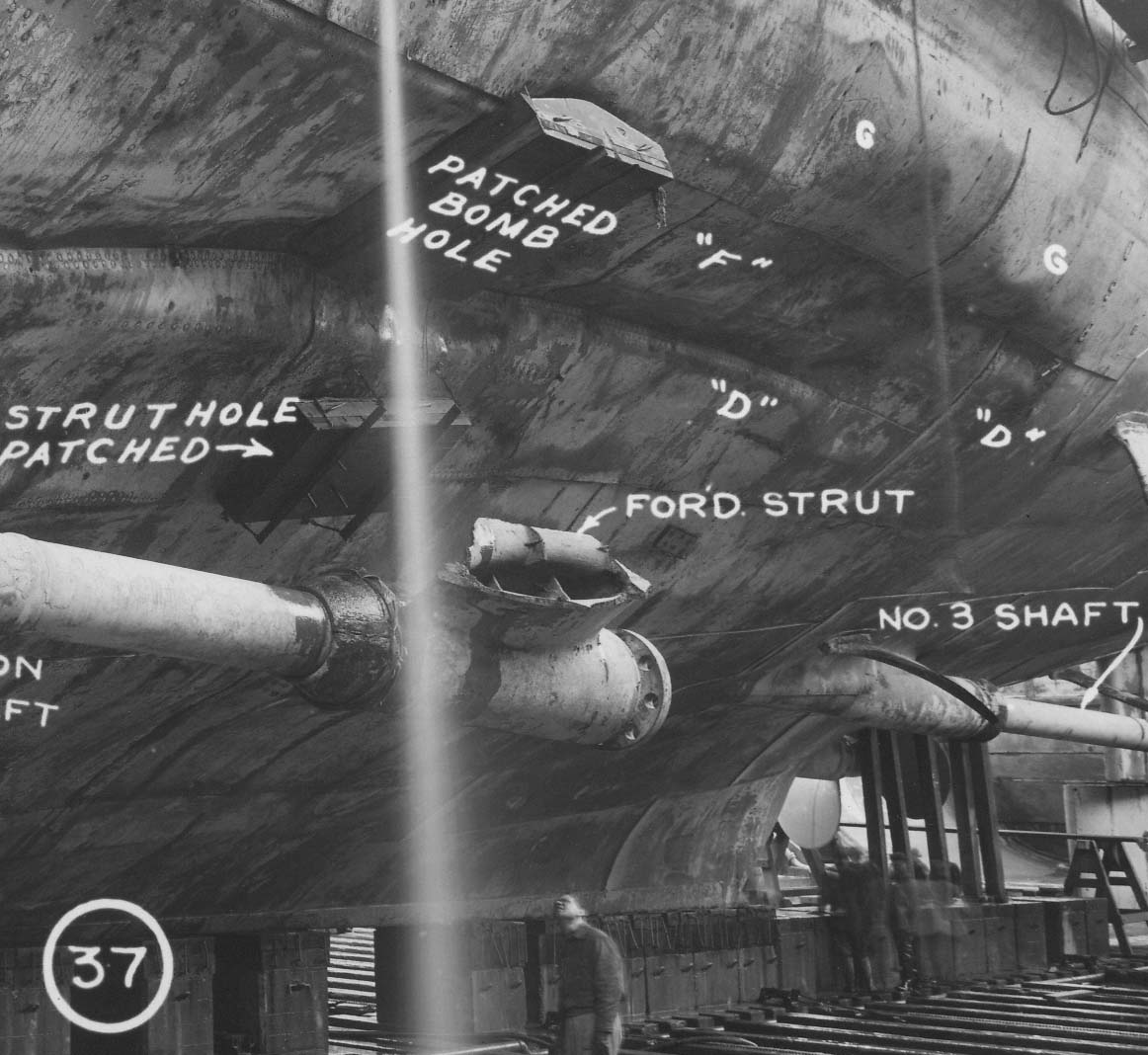

The only plans I have are from her 1945 kamikaze damage report. The bulk of the damage was further forward than the areas that have the main difference between the hulls, but I think we can give Academy the nod here. Compare KJ Kim's first photo to these:
Frame 114 - about where the forward Strut of the Forward shafts are
Not the shape of the aft keel
In Mr. Kim's photo, the Trumpter hull has a fairly constant curve to it, but you can see from the plan that it's fairly straight surface from the keel to a little before the forward strut, where it then starts to curve. Also notice the similarity in shape to the trailing edge of the keel on the Academy kit.
Aaaaaand let's take a look at this picture on her sister Portland's Navsource Page.
Hugh Williams
Posts: 937
Joined: Sat Aug 19, 2006 2:11 pm
Location: Derbyshire, U.K.
Re: Two Indi's
Post by Hugh Williams »
Tracy White wrote:The only plans I have are from her 1945 kamikaze damage report. The bulk of the damage was further forward than the areas that have the main difference between the hulls, but I think we can give Academy the nod here. Compare KJ Kim's first photo to these:
Having looked at the Navsource photo, it is possible to think that Trumpeter have got it wrong, or put it another way, Academy have got it correct. I hope we don't have the same issue with the HMS Belfast model.

I am not sure that either kit represents the bow properly but Academy looks better:
