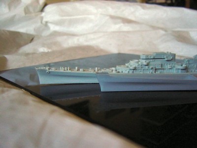

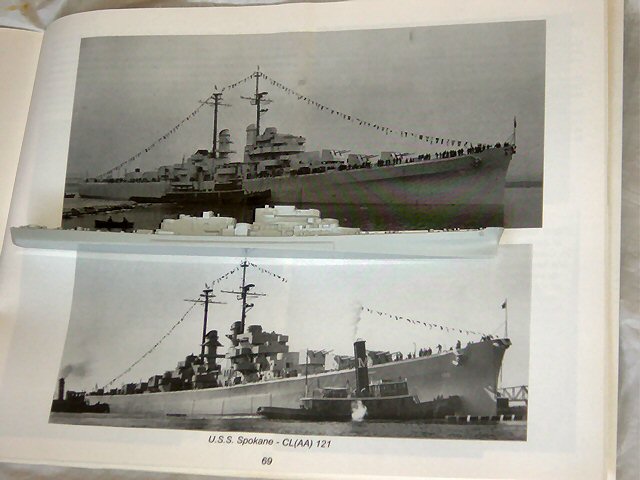

You actually do need an upper hull!
Don't forget, the knuckle on the bows of the DML and Skywave Atlanta class is all wrong. It does not slope up like on the real ships. It's much more horizontal. To fix requires major surgury/facelift.
File comment: DML & AMW bow comparison
File comment: USS Spokane Compared w/ Pic of Real Atlanta Class
