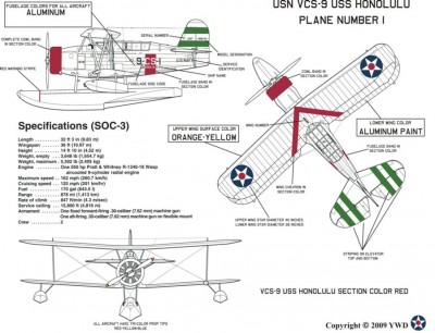

Here is Honolulu's late 1939 SOC's a/c number 1 artwork (9-CS-1). Wayne Tevlin did the artwork for me. Darren of The ResinShipYard did my decal printing in 1/350 scale.
For Matt's Brooklyn, just change the chevron, waist band, cowl and empennage two-stripe, (for CL's only), colors and you're right where you want to be. For a/c nos. 2-4, the colored waist band was eliminated and the cowl band varied from No1 full round the cowl, No2 upper cowl half, No3 lower cowl half and No4 a 12"thin strip at the cowl immediate top and bottom.
A couple of years ago and more recently, Dana helped me with simple facts and figures about USN pre-war shipboard catapult launched a/c designations and markings information. With my always prevalent ADHD, this was mind-bending!
Here is Honolulu's lead bird markings. The variations from then on were limited to the cowl markings. Dana will correct me if I'm wrong, as he was my teacher.
File comment: SOC-3 V-CS-9 A/C #1
Best wishes from a rainy SoCal, Tony
ps Matt, if you want the a/c artwork that I have, you're welcome to it.
