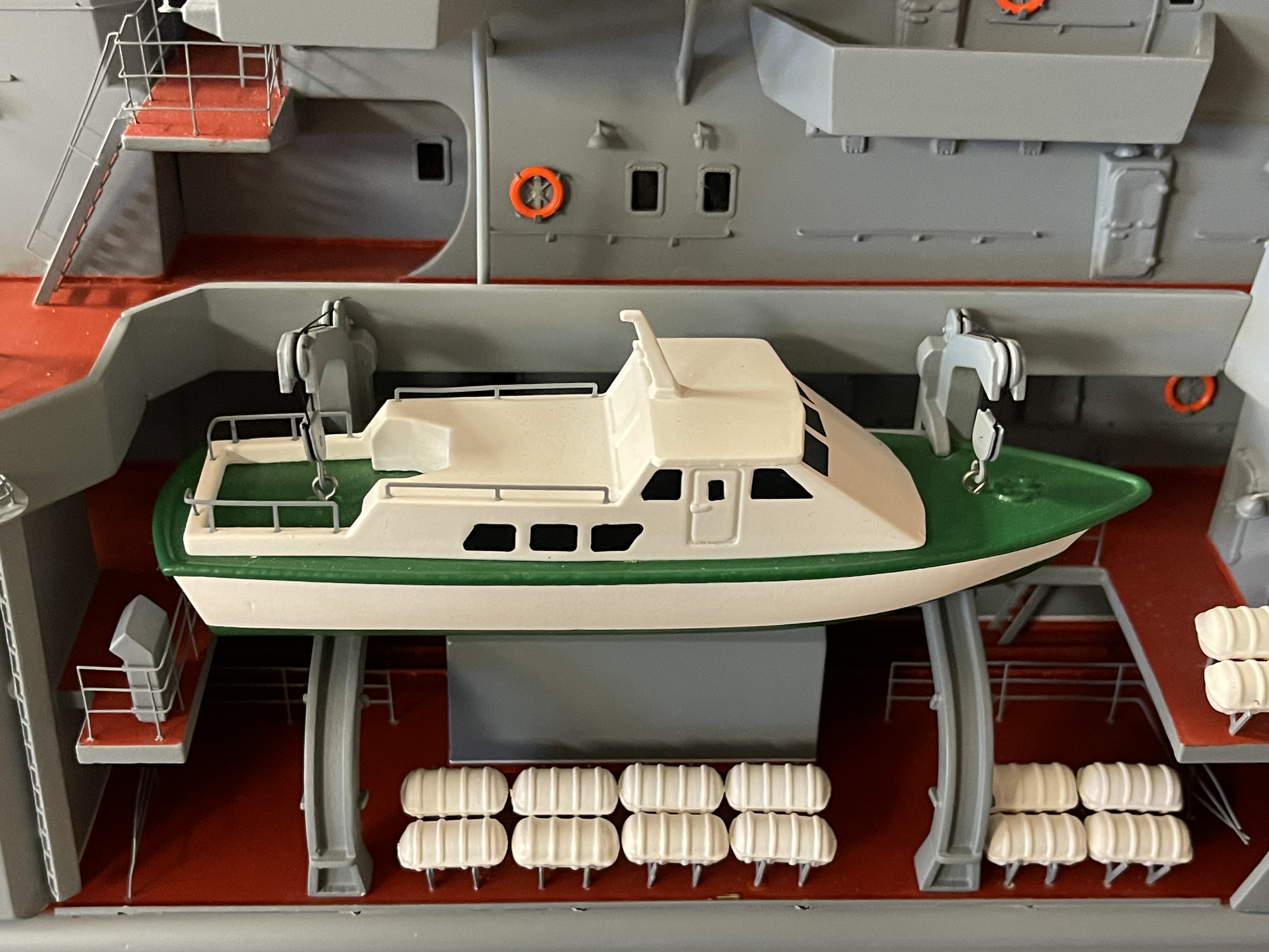

Does anyone on here have any additional photos on this lifeboat on the Kirov? Also, any idea on how it is raised and lowered? Thanks!

PostPosted: Thu Nov 02, 2023 6:53 pm
Posts: 12340
The upright portion of the davit slides down the tracks of the "diagonal" portion with the boat hanging on until they reach the edge, at which point the boat is overhanging the side of ship and then lowered into the water.
There's a diagram halfway down this page that shows it: https://www.hiseamarine.com/gravity-rol ... davit-4832

Joined: Thu Sep 03, 2020 9:27 am
Posts: 12
Thanks for help. This could be a challenge to make functional at 1/100 scale.
PostPosted: Fri Nov 03, 2023 12:23 am
Posts: 1677
There are images about half way down this page showing how the double arm trackway gravity davits work:
https://www.okieboat.com/CAD%20miscellaneous.html
