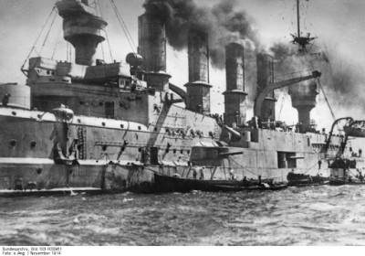

I'm working on a Combrig SMS Scharnhorst. Where did you source this information? German capital ships appear to use it, but armored cruisers weren't considered "capital ships."
This photo is allegedly taken a month before she sank. Her funnels aren't topped with black paint and I'm not sure if there's good evidence her hull was two separate greys. I'd think that we'd see more than a lighter color off the rounded hull. Assuming that this camouflage followed her peacetime lines, wouldn't we see evidence above her midships 5.9" casemate? The rounded deck "color" also seems consistent with that on her inclined armor belt.
Thanks! See attached.
- Chris

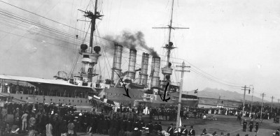

Found these in my archives this morning. Source unknown, but the one picture is supposedly her dockside in China, in 1914. Both show a demarcation between the hull and upper works.
HTH
