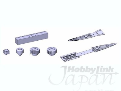

Aoshima, is releasing a new/partial re-tooled IJN Takao and IJN Chokai (both early war) this December with IJN Maya 1944 and IJN Atago 1944 will follow next year:
IJN Takao:http://www.1999.co.jp/eng/10160971
IJN Chokai:http://www.1999.co.jp/eng/10160974
Enjoy !
PostPosted: Tue Sep 13, 2011 12:10 pm
Posts: 8571
It looks like they did the smart thing (what was supposed to happen all along) and mold the deck fittings separately - mushroom vents, reels, deck washing lockers, etc.

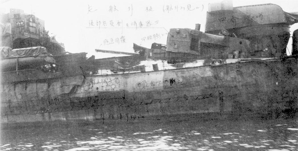

Maya was severely damaged by air attack at Rabaul in November, 1943. The damage was severe enough to accelerate a planned reconstruction of her as an AA cruiser. Upon her return to Japan, her damage was photographed at Yokosuka prior to and upon entering drydock.
The photo below shows her already in drydock. Almost the whole expanse of her midsection is visible from just below her main deck and above, approximately from frames 150 to 200, perhaps 210. What is not visible is a degaussing cable. Even if it had been placed below the main deck line, even lower than expected, there is no hint of even a bracket.
Maya damage, 1943, Fukui 2 vol set, p412 cropped.jpg [ 126.94 KiB | Viewed 1571 times ]

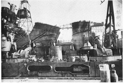

More telling is the next photograph, apparently shot before entering drydock. This photo shows the portion of Maya just aft the previous photo, approximately frames 220 to 270, from the waterline on up. I’ve lightened & increased the contrast of the photo a bit, in Photoshop, to bring out any possibly hidden details. One can see portholes, porthole covers, topside damage, and crosshatching written on the original photograph denoting deformation of the hull, but no degaussing cable, brackets or any hint of such along nearly 100 feet of hull.

In my mind, the only possible explanation is that the cable was removed earlier, possibly during her August 1943 dockyard visit. This revelation (to me) might also suggest that her sisters also had their degaussing cables removed earlier than expected, giving credence to the reference illustrations that I cited at the outset of this post.
Subsequent to my posting these thoughts on another board, one of my Japanese contacts disagreed with some of my photo interpetations and conclusions. However, his interpretation is also open to debate, as he conceded. He did point out, though, that the aperture through which the degaussing cable exits the hull for external hull mounting on the Takao’s happens at the forward, starboard bulkhead of the HAG deck, hidden under the forward access ladder that rises above the main deck to the HAG deck above. It’s not easily seen in photos.
As I told him, I believe this helps make the case that the degaussing cable would then continue to run along the outside of the HAG deck on both sides, above the main deck, as we see in Chokai. Which makes it even more telling that the degaussing cable is absent in the Dec. 1943 port side view of Maya amidships.

The last picture, of IJN Maya is a revelation. Not cause the obvious absence of a degaussing cable, but for the rangefinder of number 3 turret. It has the spotting windows enlarged, so this happend before the major reconstruction as an AA cruiser. So I guess Dan the turrets rangefinders and the degaussing cable might have occured during at the Yokosuka, 1943 May to repair damage from the the Battle of the Komandorski Islands.
