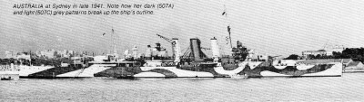

for canberre you can find a beautiful profile at
http://www.world-war.co.uk/index.php3
in canberra page.
for australia it is a foto in camouflage late 1941 in the book county class cruiser, man'o,war 1 of roberts & raven
ciao peppe
PostPosted: Mon Mar 02, 2009 12:35 am
Joined: Tue Nov 18, 2008 3:49 pm
Posts: 2
Location: Las Vegas, NV
Thank you for posting that picture of HMAS Australia. I will use that as a guide as it clearly shows her pattern. The scheme appears to be the two-tone Alexandria scheme of 507A over a basecoat of 507C with dark gray decks. Paintings show her wearing this scheme in operations against the Vichy French at Dakar and then again at Coral Sea she is in a painting showing the same scheme. The painting of her off Dakar appears to show some B5 towards the bow, a common addition to admiralty disruptive designs.
HMAS Canberra was well represented at that website you sent me to - thank you! I imagine Chicago Blue must be USN Measure 21, so I will paint her up along those lines.
Chris

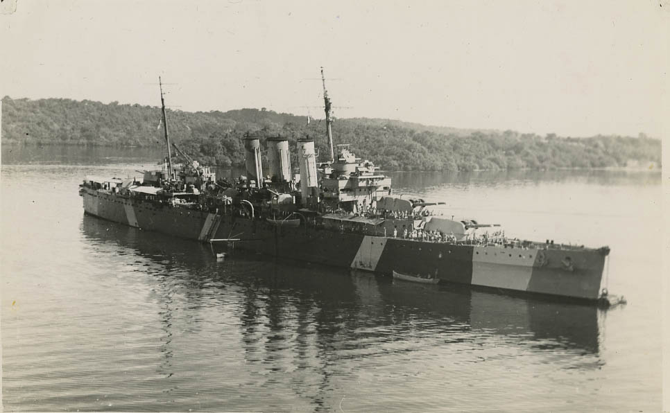

I wonder whether anybody could confirm the identity of the County class cruiser in the attached photograph, which I believe was one of a series of images of various RN warships taken in the Indian Ocean area in the 1941-42 timeframe? The lay out of the bridge structure and gunnery control systems coupled with lack of short range armament suggest HMS Dorsetshire to me but I have never seen a picture in this scheme so am doubtful. Perhaps one of the Board's experts might be able to help please?
Many thanks
Conrad Waters
File comment: County Class Cruiser - 1941/42
PostPosted: Thu Jul 30, 2009 6:25 pm
Conrad:
There are others more knowledgeable than I on this forum, but I believe you are correct in narrowing the choice to Dorsetshire and Norfolk, due to the overall arrangement of the bridge and the configuration of the HA gun platforms, (among other things). Of these two, I would say that this is Dorsetshire, as Norfolk had UP projectors and then 20mm guns on her B and X turrets from early on in the war, whereas I don't believe that Dorsetshire ever had AA armament on her turrets (please forgive me if I'm wrong, I'm working from memory, as I don't have my references at hand).
That said, this is a spectacular photo, and a new one to me. Where did you get it from?
Please advise.
Mike E.
PostPosted: Thu Jul 30, 2009 6:59 pm
Posts: 2124
Location: Monson, MA.
I concur with Mike E., beautiful shot. :thumbs_up_1: :thumbs_up_1: Maybe Alan Raven will chime in and give his take on the picture.
Bob Pink.
PostPosted: Fri Jul 31, 2009 7:02 am
Interesting photo of Dorsetshire which looks as though it was taken at Trincomalee, probably in March.
Question; what is the source of the photo?
Conrad Waters wrote:
Good evening all,
Many thanks
Conrad Waters
PostPosted: Fri Jul 31, 2009 3:24 pm
Joined: Thu Jul 30, 2009 3:54 pm
Posts: 2
Thanks for your responses gentlemen.
In answer to your questions, the picture was one of a group recently purchased on E-Bay that are certainly old but might not be contemporary. They have no notations and the original source is unknown. They appear to have been taken in the Indian Ocean and Mediterranean between 1942 and 1943, possibly from an aircraft carrier (Formidable? Indomitable?). Indian Ocean photos include a camouflaged HMS Hermes in Trimcomalee, views of Erebus and Emerald (the latter with what appears to be a pom pom mounting in replacement of the Y six inch mount) in what might be Mombasa and an R class battleship in a similar but not quite identical pattern to that representing Royal Sovereign on p40 of Mr Raven's second volume on RN camouflage. Sorry not to be able to give more precision.
