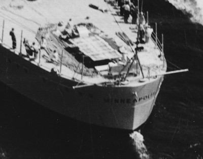

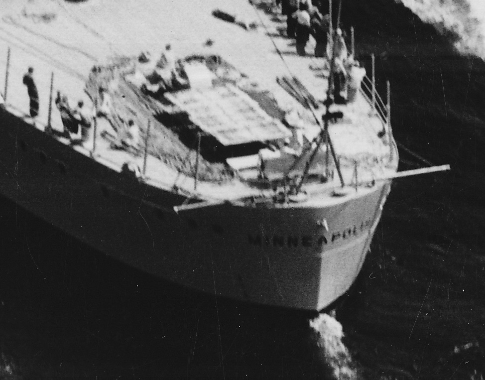

I have to wonder if the USS CALIFORNIA sled was a Pre-WWII design used on battleships and cruisers. This photo shows the more common type of sled I'm use to seeing deployed by war-built cruisers.
This rare view shows USS MINNEAPOLIS recovering her aircraft in 1939. It shows the arrangement of recovery rigging required to retrieve aircraft while underway. The close-up shows the sled used, which could be like the one show onboard USS CALIFORNIA. As you can see, not much detail of its construction can be made out.

Rick, thanks for that close-up. If that is another one on the quartedeck, maybe a close-up of that can reveal a bit more?

I don't think it is another sled. But, I have no idea of what they are working on on the fantail. One of my "maybe" guesses is that they are getting ready to erect awnings. There is an a lot of rope laying there. They objects in the middle, almost look like tables. Could be cleaning them or getting ready for some sort of event????

Rick E Davis wrote:
Gernot,
I don't think they are getting ready to erect awnings as they look to be underway. And even if they were about to tie up dockside, the main decks would be clear to manhandle the mooring lines.
PostPosted: Sun Nov 27, 2016 1:27 am
Posts: 1645
A lot of the guys on the Minneapolis are wearing whites, but some are in dungarees. When I was in the Navy crew and officers only wore whites going into and out of port, or while in port. At sea it was khakis and dungarees.
So I would guess they were just entering or leaving port. The mooring lines on the stern are faked down pretty sloppily, as if they had just been hauled in. When preparing to enter port the lines were removed from storage reels and neatly faked down so they could be hauled without getting tangled. So I would guess they had just left port.
The flag staff is up on the stern (at sea the national ensign is flown from the mast top). It would be lowered for gunfire operations, and might have been lowered soon after getting underway and raised only when entering port again. Other photos of the Minneapolis at sea might reveal more about this.
It was common practice to send planes to repair shops/tenders while in port (when they wouldn't be flown off ship anyway) and to take them on board after getting underway. Looks like that is what they are doing in the picture.
The other stuff on the fantail? It looks like four doors - they are a bit longer that the sailors are tall and appear to have two panels. Maybe they are/were being painted? Maybe something from the Philadelphia experiment? Parts of a flying saucer they are secretly burying at sea? Pick your favorite rumor or conspiracy theory.
