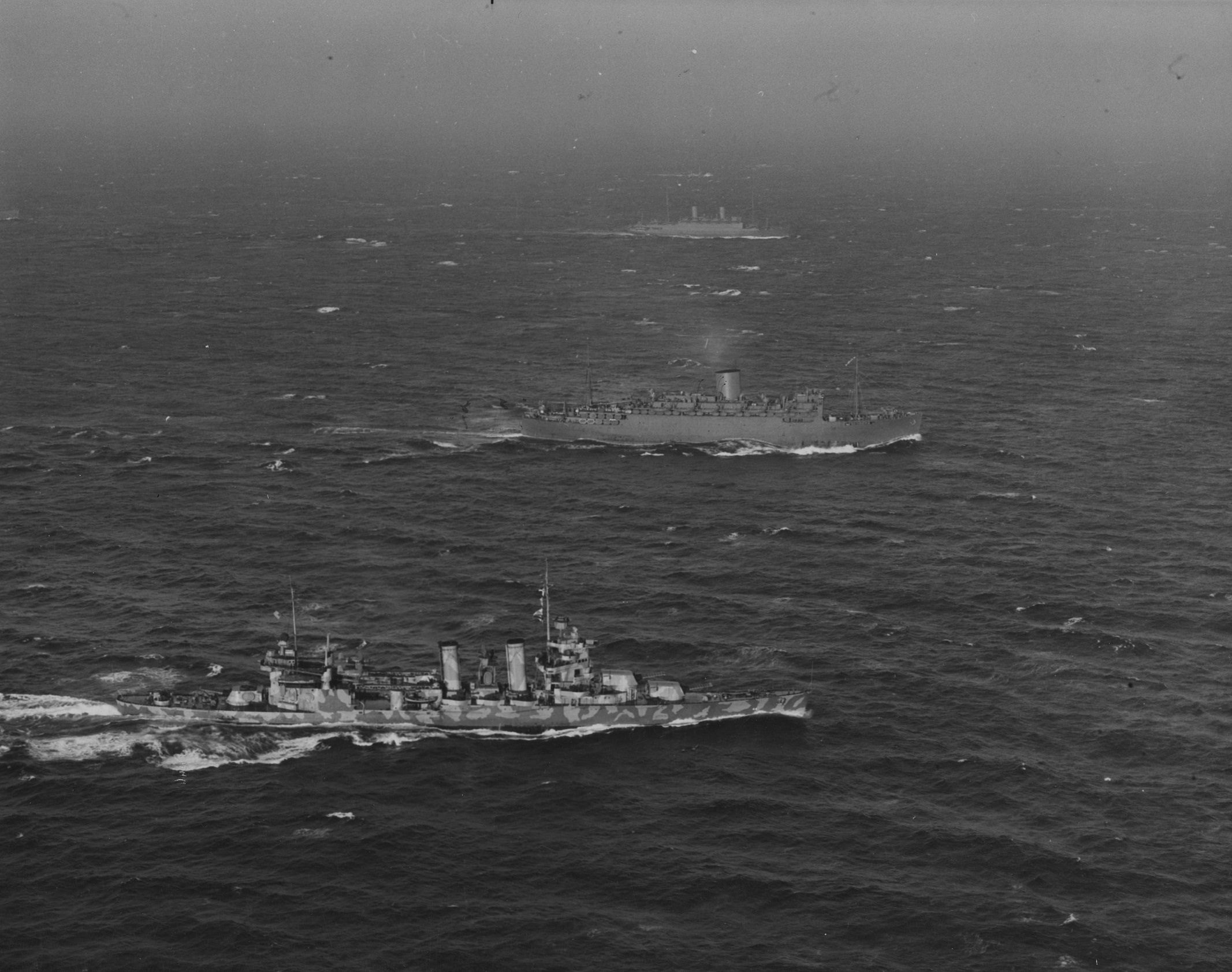

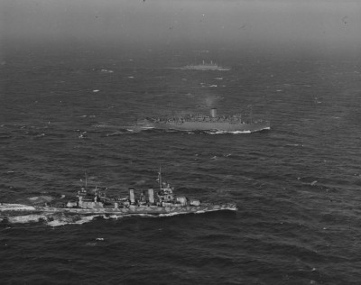

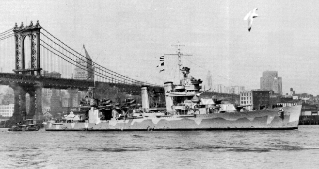

Hello everyone,
does anyone know what was the straight cable-like item at the side of USS Quincy on the following photo (marked with red arrows)? I noticed something similar on other ships of the NO class, too (e.g. SF and Tuscaloosa in 43). I´ve been thinking about a degauss cable but funny enough it seems to be present on one side only - see the second photo of Quincy in the same timeframe! It also does not stretch over the fulllength of the ship. Any ideas? And if so, dimensions/diameter, shape, attachment etc...?
Thanks!

Vladi, I believe it is the aviation fuel dump line.

Interesting! I have not thought about something like that, but it makes sense - and the sloping angle from the hangar area seems to support it.
Great, thanks!

Something that just occurred to me.
That "Line" is running from where the peak-tanks are to the hangar.
And the peak-tanks are where they stored the av-gas (at least on all of the New Orleans-class plans I have).
I wonder if that has to do with anything?

It wasn't a fuel dump line, simply the fuel line to get avgas from the tank to the planes. It was outside of the hull so that if it was damaged, the burning gas would be outside of the hull rather than inside of it.

So... Then my speculation was correct???

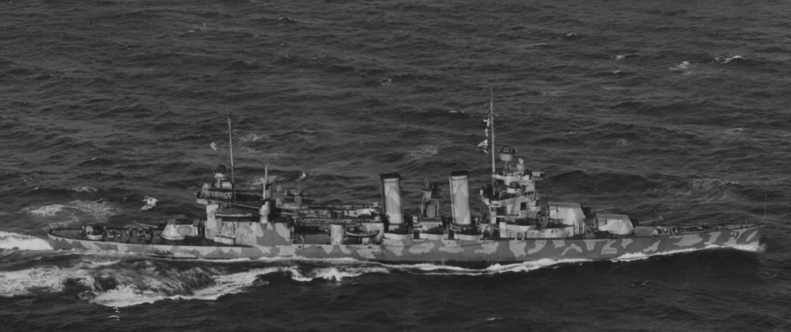

From the National Archives, via Roger Torgeson, CA-44 Vincennes, January 1942 (according to the caption).

Thanks a lot for posting - a very interesting photo indeed, still showing a remainder of her "bird bath" tub at the top bridge level (removed before Midway), but splinter shields around her 5" guns already in place. And of course her unique splotched Ms12 camo pattern!
