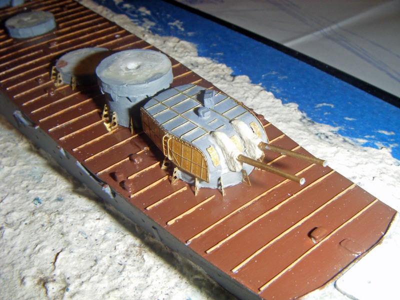

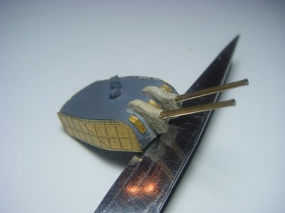

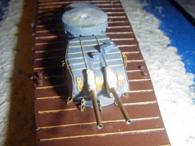

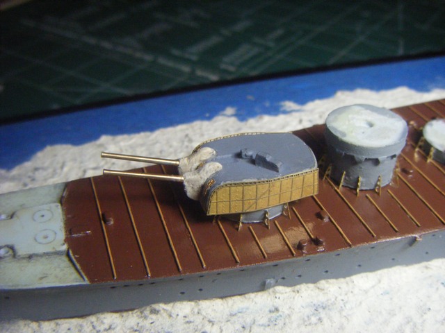

How about a build of the San Francisco in 1/144? It's not a kit but here's my offering.
This is my first attempt at scratchbuilding; it'll never be shown at a show because there are so many things wrong with it but I try new techniques on it and continue to work on it between other projects. These pictures are little old, the masts have been raised and I went back and added a bunch of hull detail as well as an accommodation ladder over on the port side just aft of the A/C catapult.
