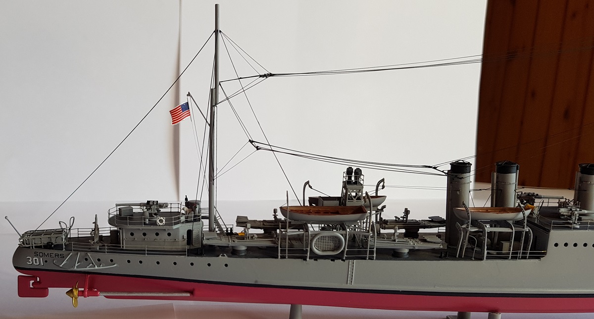

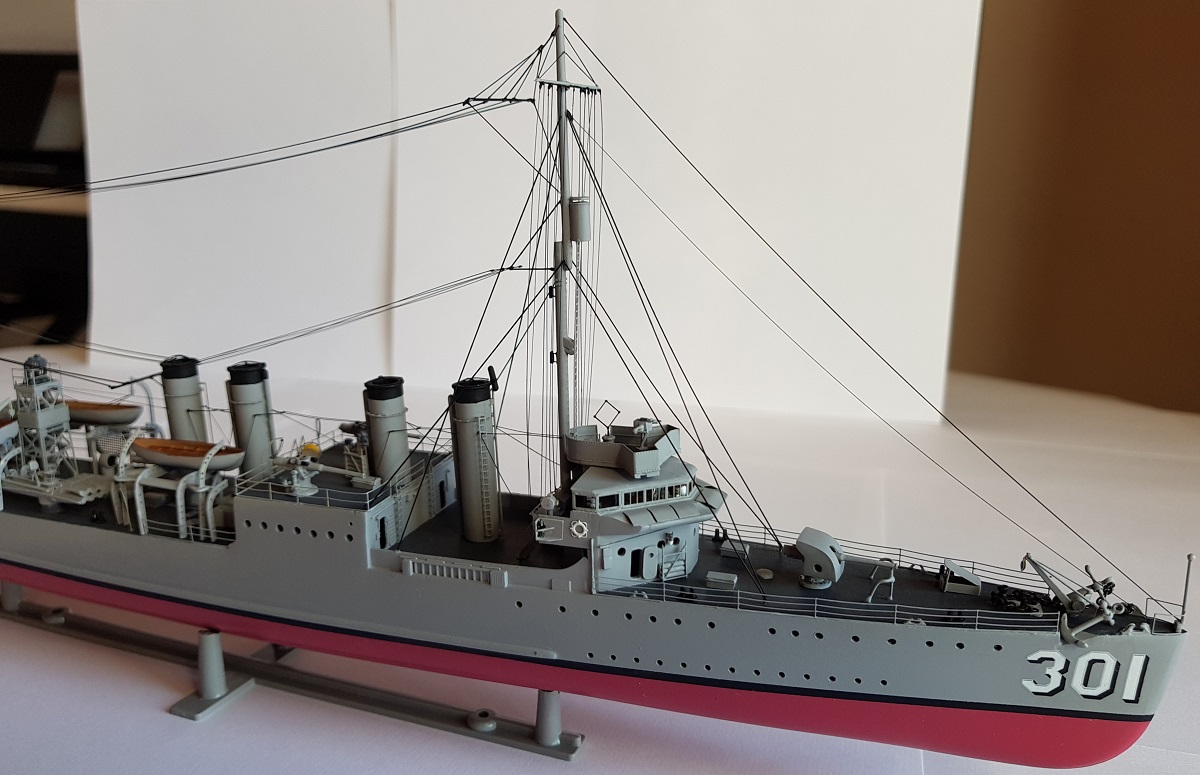

My revel 1/240 USS SOMERS is finished...thought it good to put pictures here...if you wanna see full build...
viewtopic.php?f=59&t=207229
For info as USS SOMERS was scraped 1930 I had to modify according my Campbeltown... I suppose it give a realistic view of the Clemson class between 1920 and 1930

That is certainly excellent work. Old tincan men would appreciate it, I'm sure.

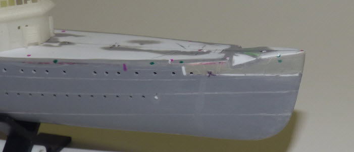

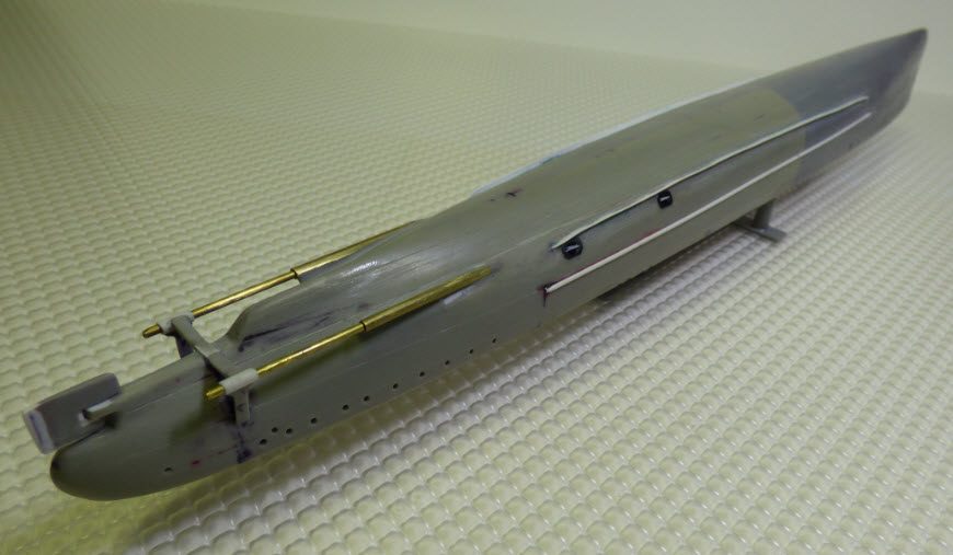

This is my extended version of the 1/240 (approx) USS WARD. I bashed two kits together to add length, added camber to the deck and sheer to the foc'sle. I also modified the propeller shafts and the inlet/outlet for main seawater sea-chests. The extended length model now measures 41.5 cm.

Having rebuilt one of those 15 or so years ago, I can appreciate the work you've done! Hope to see it finished :smallsmile:

The length is incorrect for that scale. The stacks are also the wrong height.

The extended hull is the correct scale length for this kit. I did it this way:
The beam of the original kit is about 4 cm. The overall length (314.5 ft) to beam ratio (30.5 ft) of the ship class is about 10.3. The scale overall length should be around 41.5 cm. The measured overall kit length of the hull is 39.5 cm so it is about 2 cm short. I used overall length not length between perpendiculars (waterline). The true length of these ships varied so the length measurements are not an exact science. I discovered this when I blew up the plans in the Al Ross book and discovered the problem. I used the measurements in Alden's "Flush Decks and Four Pipes". Because of the stern, the differences between the overall length and waterline length can be confusing. Plus no two sets of plans appear be the same.

I went back and checked the references and remeasured my modified kit. Everything I posted above was from memory and I was not correct in some areas. I was going to edit my above posts but have decided to summarize it here for posterity. But first a couple of points for clarification:
1. The major four-piper references all have different beam measurements that are within plus/minus 0.75 feet. When I modified the hull last May, I used the Al Ross "Destroyer HMS CAMPBELTOWN" book as my major reference. His references look solid.
2. I used Mr. Ross' book because many of the plans (General Booklet of Plans, Floating Drydock, Blue Jacket, National Archives...) provide different deck arrangements and scale measurements. At least the Anatomy of a Ship Series had enough info to build an entire ship model (right or wrong), and allowed me build templates to build items and mark locations.
3. As a retired Surface Warfare Naval Officer and a Naval Architect who now works at Naval Sea Systems Command (NAVSEA), I know official Navy plans may or may not be accurate. General Booklet of Plans are "General" in nature and do reflect any ship in any particular "as built" or "as modified" condition. They are good a reference for general details. No two ships are exactly alike, or may not reflect actual features in the drawings. So to overcome this problem, I had to estimate and compromise in several areas, and live with any mistakes. Round-off errors to the first decimal are ok (to me).
4. The plans in Mr. Ross' are 1:256. I upscaled them on a photocopier by magnifying them (x1.14). As the guide of this ratio, I used the widest beam kit measurement (4.0 cm), divided by the 1:256 plan beam of 3.5 cm (4/3.5=1.14). I rebuilt the kit to match the dimensions on the up-scaled plan, and not to any particular scale. Just the max kit beam dimension that the kit afforded me.
As Planned: I backed out my preliminary measurements in the following way: In Mr. Ross' the the overall full scale length 314.5 ft (95.86 m) and the beam 30.75 ft (9.37 m). Using these numbers, the length to beam ratio is 10.23. Using my planned beam of 4 cm, the scale overall length should be around 40.9 cm. At this point I cut up two kits and bashed them together. I cut the kits at the max beam, so the new longer halves mated perfectly. After a month of sawing, sanding and filling I measured the rebuilt hull. The bow, deck sheer/camber, propeller shafts and rope guards were another horror story that I will not discuss here.
As Built: After the hull was built I measured everything. My kit is heavily modified (cut-up and decks replaced...) and bears little resemblance to the original kit in any comparable way. The max kit beam is measured as 4.07 cm, which times x10.23, gives an "as-built" predicted length of 41.63 cm. The as-built measurement of the actual modified hull is 41.6 cm. The main deck to keel projected dimension also matches my blown-up Al Ross plans. Most of this turned out to be so close by good fortune and not by plan. I may be off a "mm" or two but I did the best I could.
Summary: My as-built kit comes in at about 1:230 scale and matches the up-scaled Mr. Ross plans within a fraction of a cm. Interesting because when I started the scale was not an issue considered because i thought it was 1:240 "-ish". I just wanted to have a properly dimensioned kit based on the old WARD kit using the Mr. Ross plans. Mr. Ross' plans may not be perfect and/or my hacking and slashing modelling style is imprecise, but the result is good enough me given my discussion in Para 3 above. The "as Planned" and "as Built" kit was within 0.7 cm, but with a slightly wider beam it checks out nicely. This ship will end up as the the USS PREBLE (DD-345), the namesake of the first ship I first served on.
Lessons Learned: Thank you for your patience reading this post. I am glad I documented this discussion here because I had forgotten much of it until I went through my records. As a modeler, with an engineering background, I always think in terms of numerical ratios, not model scale. I did not build a kit to a particular scale but an existing kit to a set of drawings that would accommodate the maximum beam of that kit. I hope you have better insight into my modelling approach with this kit.
