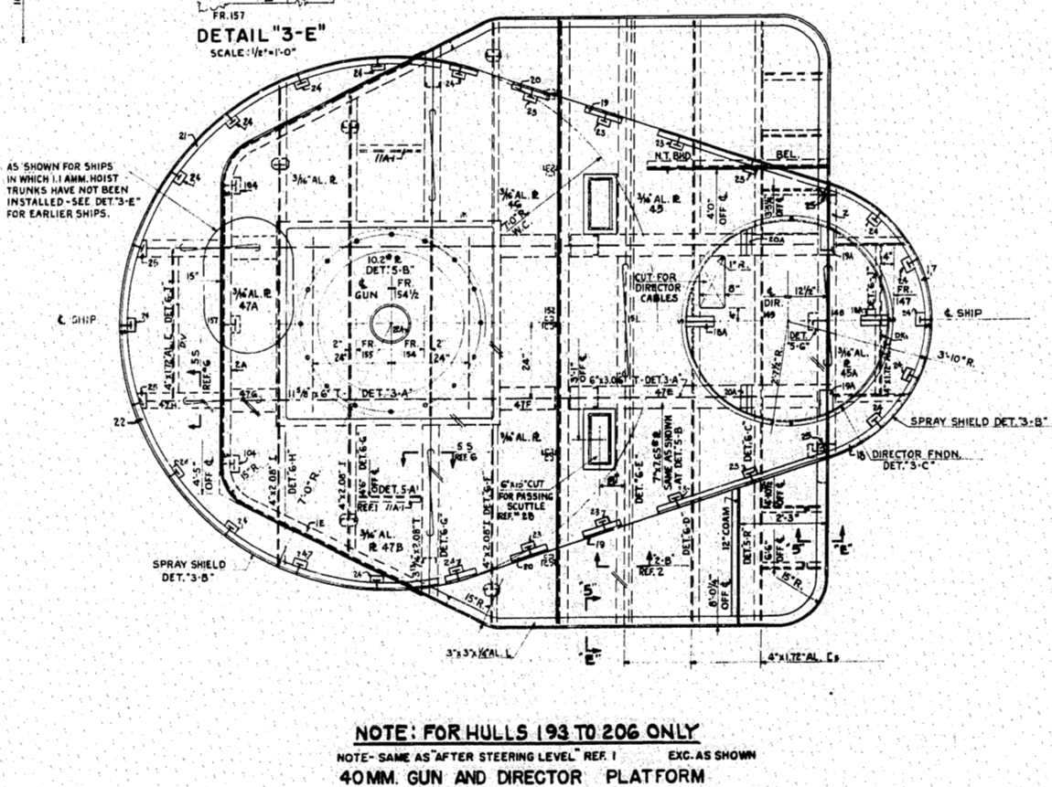

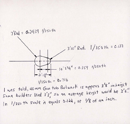

I spent a couple hours scaling down and drawing the Centerline Teardrop 40mm bulwark in 1/350th scale for PetrolGator. He's planning to build the USS Johnston DD-557. Since I don't build in 1/350th scale I figured I would post the drwaing here for anyone to use.
40mm Tear drop Gun tub 1-350th scale 5-28-2013 lr.jpg [ 108.36 KiB | Viewed 2758 times ]
I used this drawing as a guide to scale down the particular gun mount area to 1/350th scale.
I would use .020 styrene stock for the base and 1/8 x .010 styrene strip stock for the bulwark.
The Mk-51 gun director foundation is 5' 2 1/2" in diameter. In 1/350th scale that equals 0.181 diameter and 3/16 of an inch could be used and not be out of scale much at all. 3/16 is a standard styrene rod size, that's what I would use.
The drawing is full size and all you have to do is print it. When you cut it out, cut away the line to make it right to size :big_grin:

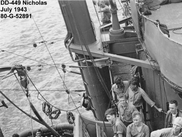

Question about the Tamiya Fletcher kit, there is a deck cutout at the back of the bridge to accommodate the mast, is that accurate?
Thanks
PostPosted: Sat Jun 08, 2013 12:30 am
Posts: 3840
Quick answer is "Yes".

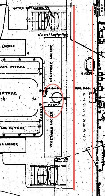

I see that the extension off the top deck as your picture depicts is correct, but the lower deck on the tamiya kit (directly below the area in your pic) has a cut-out to accomodate the base of the mast, pics I see of DD449 looks as though the deck there should have no cutout?
PostPosted: Sat Jun 08, 2013 11:55 am
Posts: 3840
The base of the mast would be "anchored" onto the main deck on the real ship, not any of the superstructure decks. The mast would simply pass through any superstructure deck it its way to the main deck. On a kit, the kit maker may simply anchor the mast to the first major deck (deckhouse) it comes to.

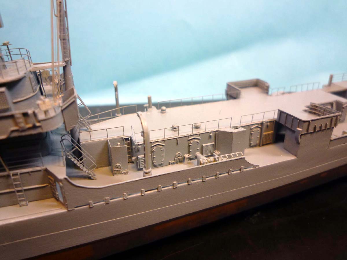

Thanks for the reply, looks like this modeler Pierre Marchal from this site scratchbuilding DD449
moved the mast away from the superstructure if you look at the base of the mast. Just wondering if I should modify the Tamiya kit to reflect this if I am building DD450 OBannon?
