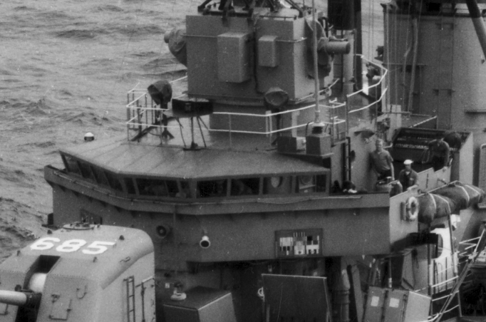

Depending on which photos you are looking at and the date of the photos, I believe that the other object opposite the 5-in/38-cal practice loader (on the starboard side), is a 3-in/50-cal practice loader (on the portside). The photo of PICKING I posted shows the 5-in practice loader on the starboard side on the main deck below where the aft Torpedo Mount was originally located.
Actually about one in four FLETCHER's had the Unit Commander cabin/accommodations installed among the 82 units (non-DDE) recommissioned for the Korean War.
PICKING was one of the three units funded in FY51 (1 July 1950 to 30 June 1951) and first modified to the SCB 74A upgrade and started being modified before 1 July 1951, PICKING was the first completed in October 1951. Followed by USS ABBOT and USS BENHAM in November 1951.
The Open Navigation Bridge was covered with an overhead (first canvas and then with permanent structure) during the 1950s. Not truly "fully enclosed".

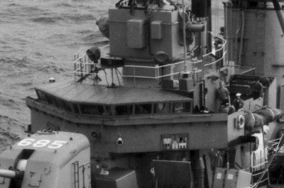

Here are a couple of cropped views of PICKING's Bridge and Midships area showing the 3-in practice loader dated 19 July 1968.

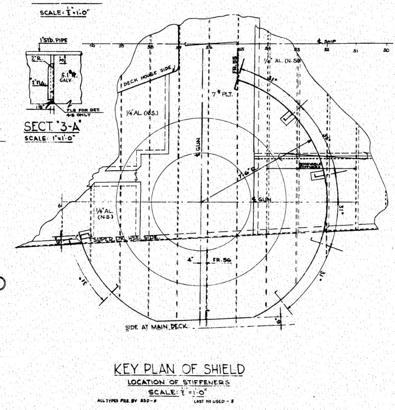

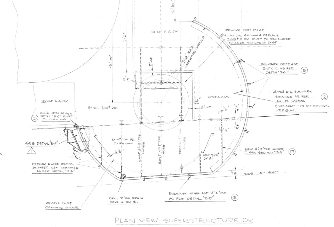

Here is the plan view of a drawing I came across at NARA. It was drawn for a Round-Bridge FLETCHER and has the exterior stiffeners, but the basic dimensions were standard on almost all installations of these forward mounts on FLETCHERS. Some units didn't maintain a circular shape to the bulwark inboard, Square-Bridge units normally wrapped the bulwark further inboard than seen here. Note that the "flat" area is kept 6-in from the side of the ship when complete.
Below it is a plan view of the same design used on BIW-built Square-Bridge units where the exterior of the bulwark is smooth and there are interior stiffeners. The dimensions and design are pretty much the same. This area on a real ship is quite complex with the super deck having sheer and camber.
Contact me off-line and I can send you the full size drawing with dimensions for ALL the parts used to build these on the real ships.

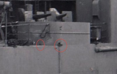

PS. I might ask the same about her waist 20mm bulwarks. Looking at this photo from earlier in the thread...
...apart form that one little shadow underneath the after Oerlikon, there appear to be no drain holes. Were they not there, or just too small to show up in the photos? I've not been able to detect any other potential drain holes in photos of Heerman's 20mm bulwarks.
Thank you!
Bob

As for the amidships main deck 20-mm guns spray bulwark, there does appear to be only that one drain that aligns with the drain trough going off-board. I'll have to post a small overhead image when I can get to my other computer. There also appears to be a small drain square on the aft side of those bulwarks. Again pretty damn small, not sure it is worth duplicating.

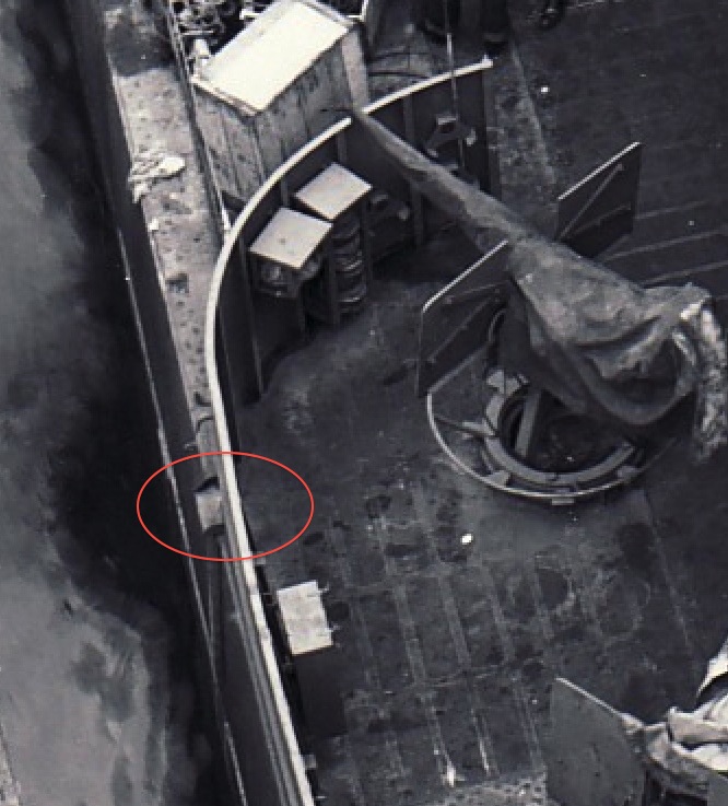

As for the 20-mm main deck bulwark, these images should help.
The first image shows the location of what I will call the "main drain" and what looks to be another smaller drain along the curved section of the bulwark. This could be something else however and it is so small I wouldn't worry about it.
The second image shows the location from an overhead view with the alignment with one of the deck drain troughs. On the FLETCHERS and many ships, there is a channel running along the edge of the deck at the edge of the hull. All water that drains off the deck is channelled into this system and then exited off the ship is several locations. Bethlehem located one of the drain off troughs with the drain through the bulwark. You will notice that the 20-mm bulwark breaks the drain trough and that there is another trough just ahead of the bulwark to drain water coming from further forward.
Depending on how anal a modeler is, they could go insane getting all these small details into their model. :scratch:

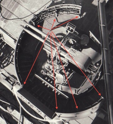

I can't locate a view without the canvas covers over the ready ammo clips of the Bethlehem-SF built units, but there should be stiffeners on the inside. Rule of thumb was stiffeners were either on the inside or outside. They should follow the layout seen on the BIW Engineering drawing I posted a few posts back, with it looks like eight stiffeners.

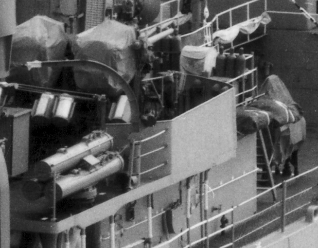

As you can see the stiffeners are more or less "integrated" into the clip holder stowage system. Also, this view shows that the late-war mod of having a pop-out hinged flap for the outboard flat of the "tub" has been installed and all the stowage clip holders removed from that area.

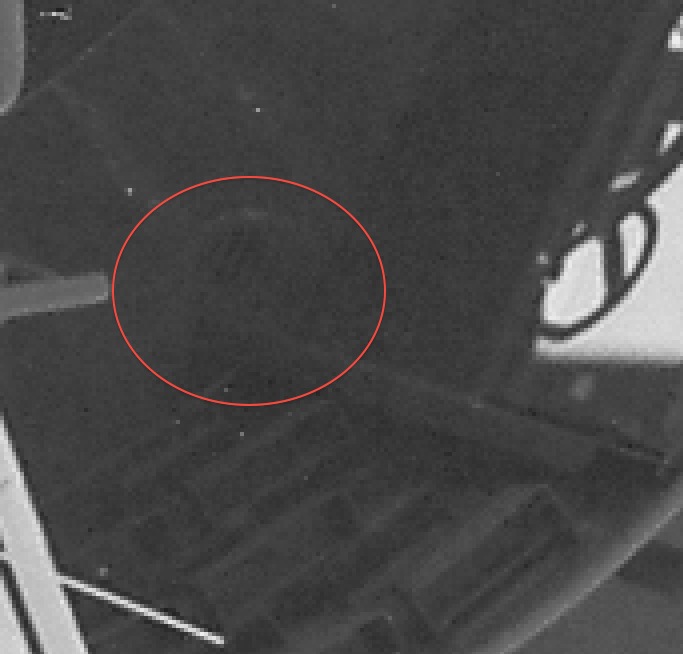

PS; Remember the question of if and WHERE a drain was for the forward 40-mm "tubs". Well in looking really close in the aft outside corner (I don't know how else to describe the location) where the flat section meets the aft curved bulwark. There it is with a floor drain cover. Much like in a restroom. :smallsmile:

I was visualizing the supports as being flush with the inner shielding, but it looks like they stand proud of it. The large support to the right of the barrel attached to the flat side in the second pic looks like a standard support, triangular in shape. The ones on the circular part of the shielding almost look like upside down L-shaped supports, with the feet attaching to the shielding and the leg then proud of it. Does this interpretation sound feasible??
