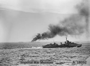

Dear Stuart,
The colours suggested in the kit are wrong as has been previously highlighted. The design of the painting scheme in the instructions is essentially correct, but note that A and probably B turrets and the front of the bridge were also �blue�.
If you are doing an out-of-the-box build, the kit depicts Eskimo as she emerged from her refit in September 1941 (see first attached photo). The white is �RN white�, a very slightly yellowish off-white, and the blue at that time was the very light �Western Approaches blue� (both these are available from wonderful White Ensign Models in their colourcoats range if you want to get them exactly right).
The suggestion of B55 was made in reference to a picture of Eskimo showing a much darker shade to the �blue� areas (see second attached photo). But this is for a much later time, 18 or more months later in 1943. By then there would have been a host of further modifications/additions in areas such as the light AA, radar, director, HF/DF and A/S fit which the kit does not provide.
Cheers.
